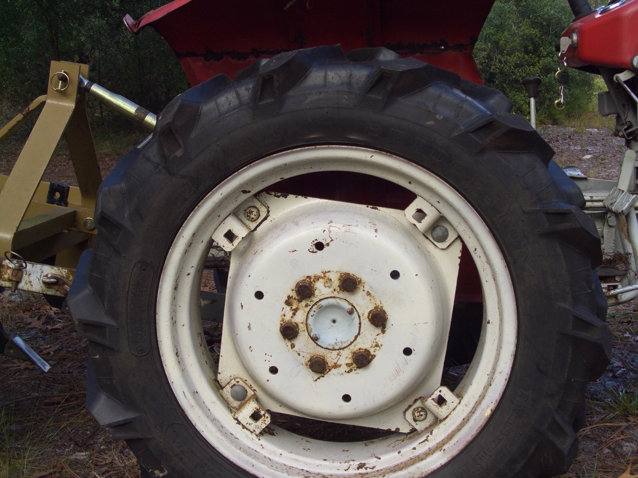

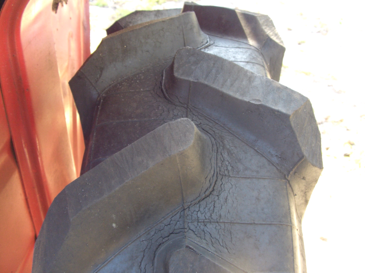

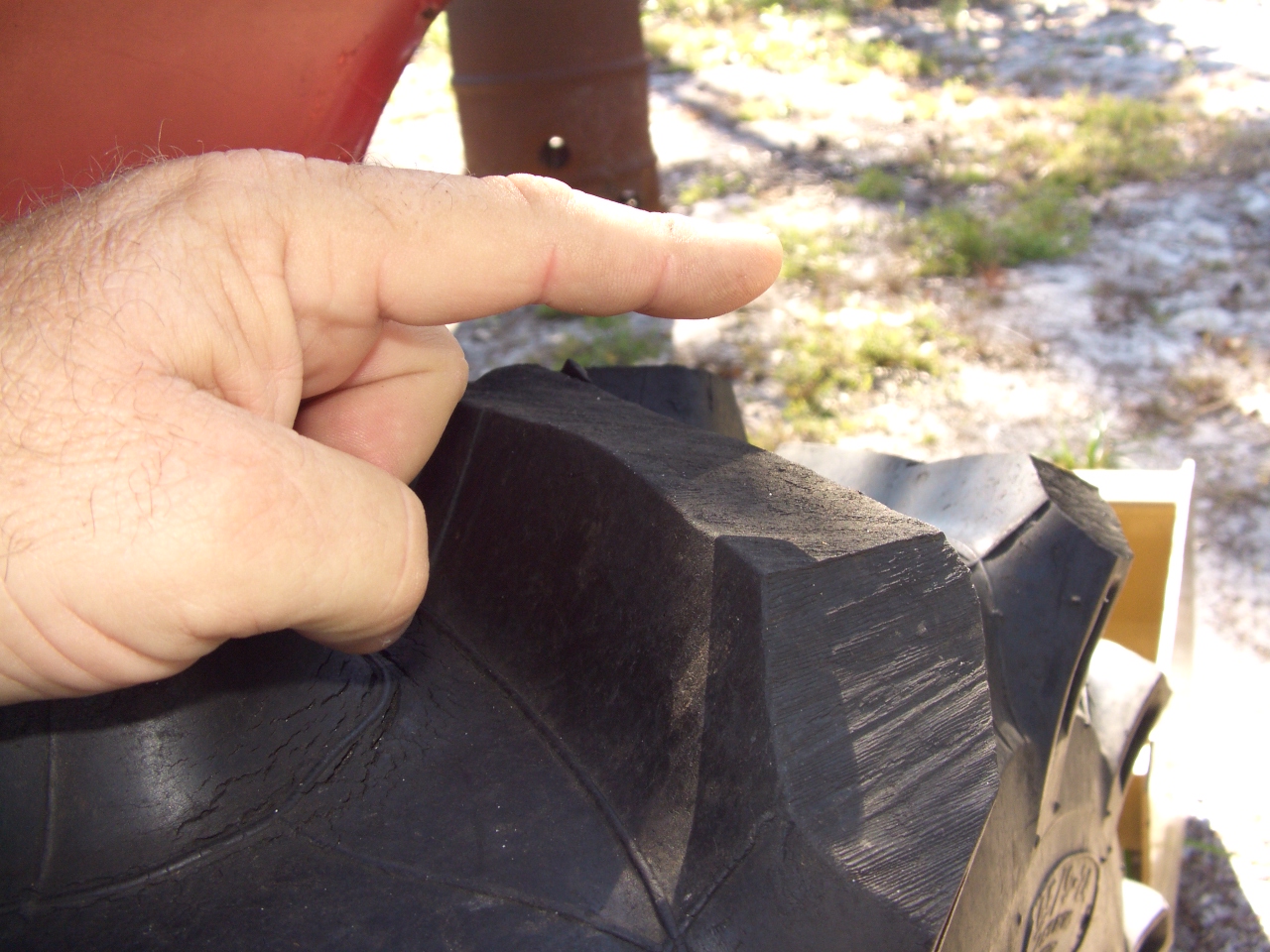

I took a couple of pics. Yes, if your up close and looking you can tell it's a less than factory job. However I am so glad I did it. Way less marks on the driveway. Looking at the tires again I would say I removed about an inch. I tried to approximate the amount with my finger in one shot. I did not use a jig or even a ruler. I only eyeballed it. No 2 cuts are the exact same, but it works for me. Three feet away and it looks fine.

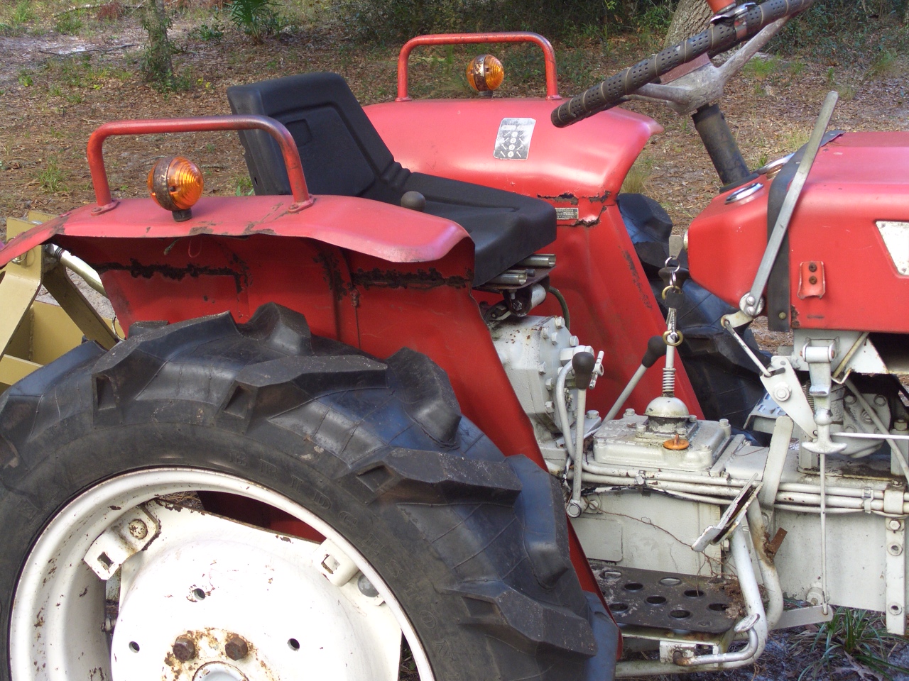

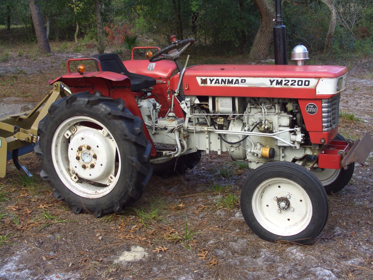

The side pic is a little dark, but I think you get the idea. I used a general purpose blade with a milwaukee 18v saws all. I cut about 3-4 lugs and I put a farm jack under one axel and raised the wheel enough to spin by hand. I turned the wheel until 4 more lugs were in a good cutting position and lowered the jack a couple of notches to steady the wheel and so on and so on. It sounds like a lot of trouble but it really went quick. I actually made 2 cuts per lug.

Looks like you did a real nice job on those. One question? How come you haven't reversed your wheels for a bit wider stance.
/ Makin' a rice tire user friendly
#13
When I bought the tractor the wheels were set to the wider stance and I used them that way for about 2 years. As I began clearing the wooded areas and was required to move around through the trees, I turned the wheels around and made a more narrow stance. I prefer the wide stance, but for now I like the clearance in the trees. No hills here so thats not even a worry.
