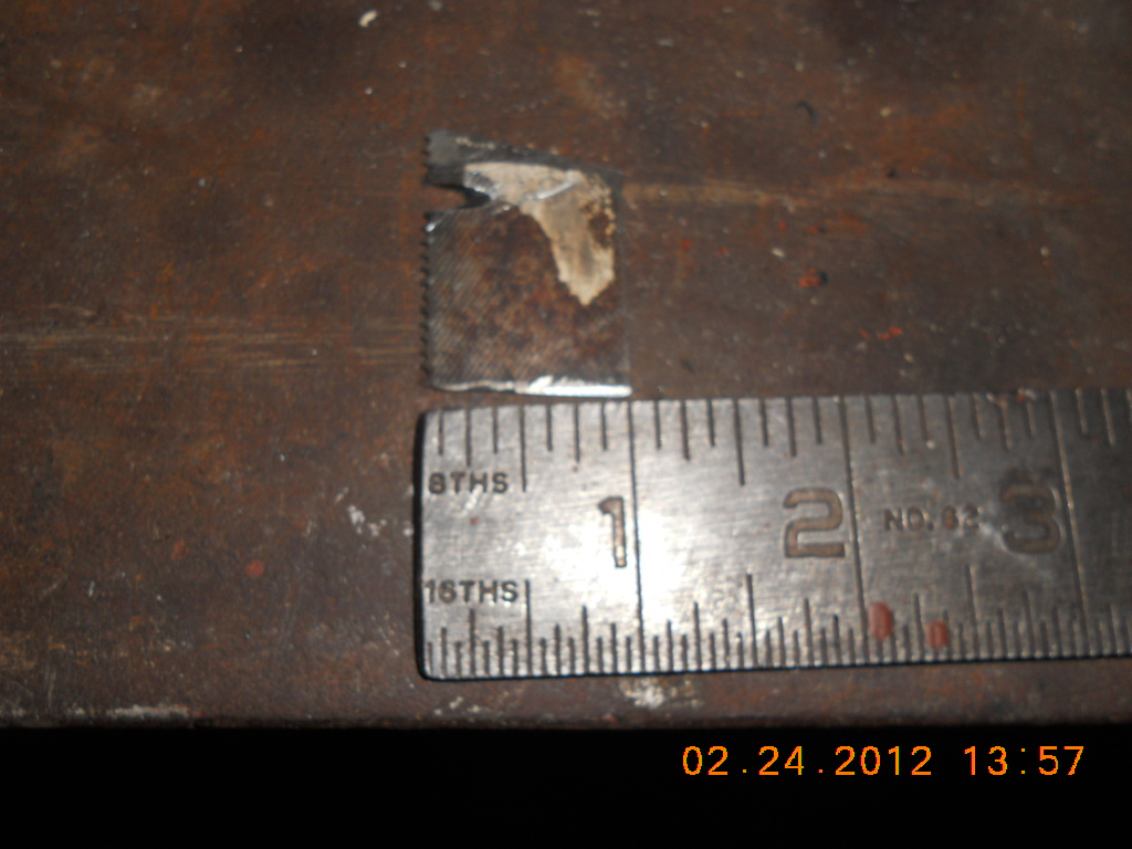

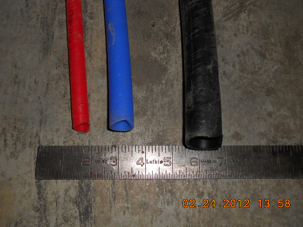

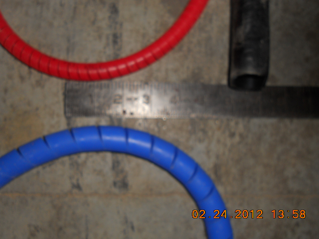

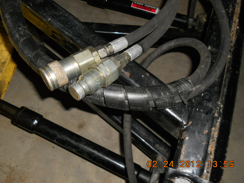

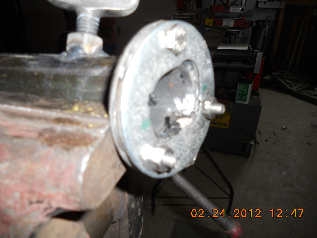

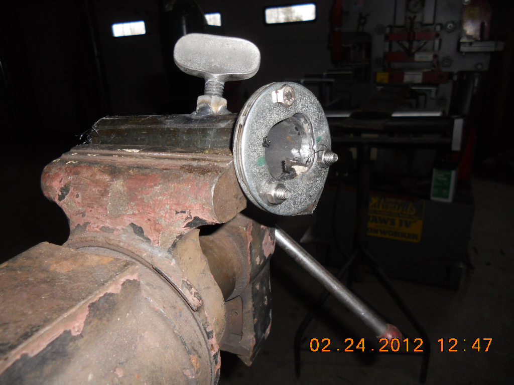

In going thru my pics for another post, I saw the tubing "slicer" I made to slice regular plastic tubing (well pipe, pex tubing ect.) into that curly hose "protector". They charge a fortune for that stuff! I just took a short legnth of (about) 1 1/2 black pipe, guessed an angle to cut it on, and made up a little rig to hold a short pc. of a heavy sawzall blade. I figgured that it was pretty hard, and made a little "hook" type cut in the side of it with a little cut off wheel. It really works well! The pictures are not much, and if you would like a better pic or description, I'd be happy to help.

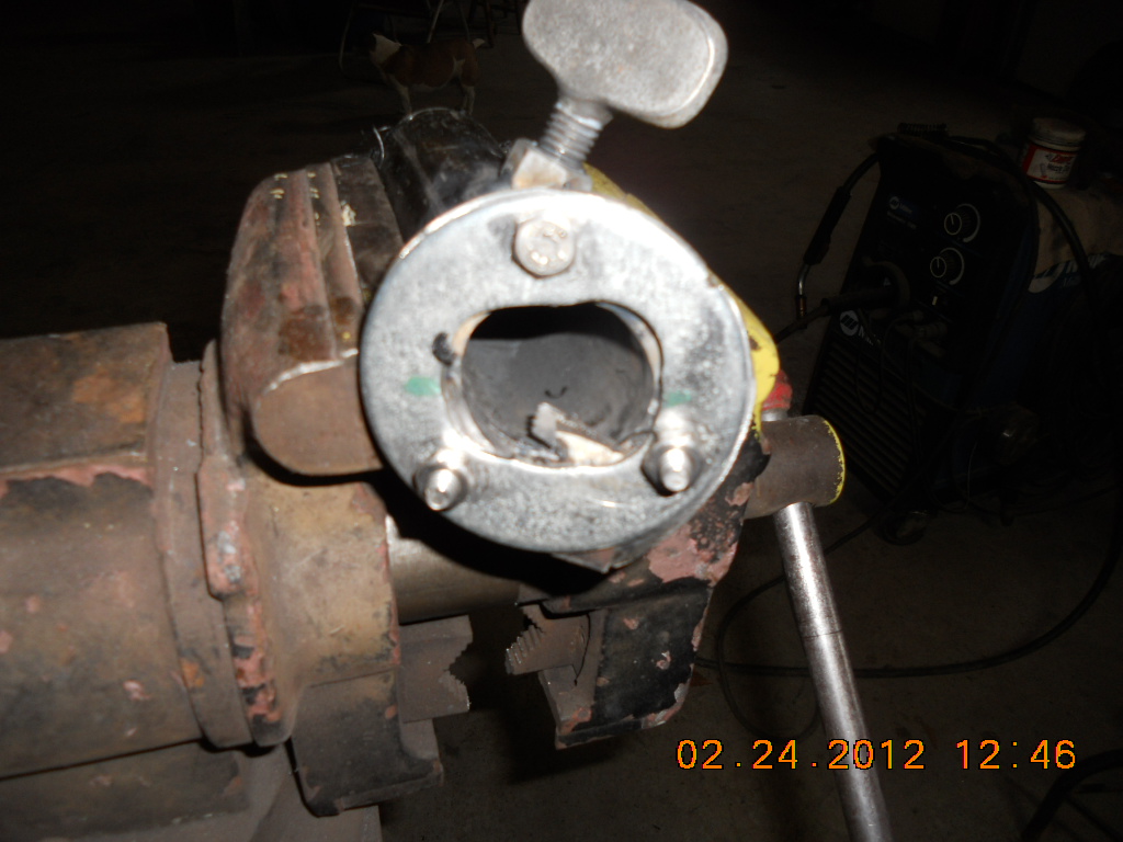

That is the most unique idea I've seen in a while. How do you establish the pitch of the helix? Looks quite uniform.
/ Make hyd hose "shield" yourself #4

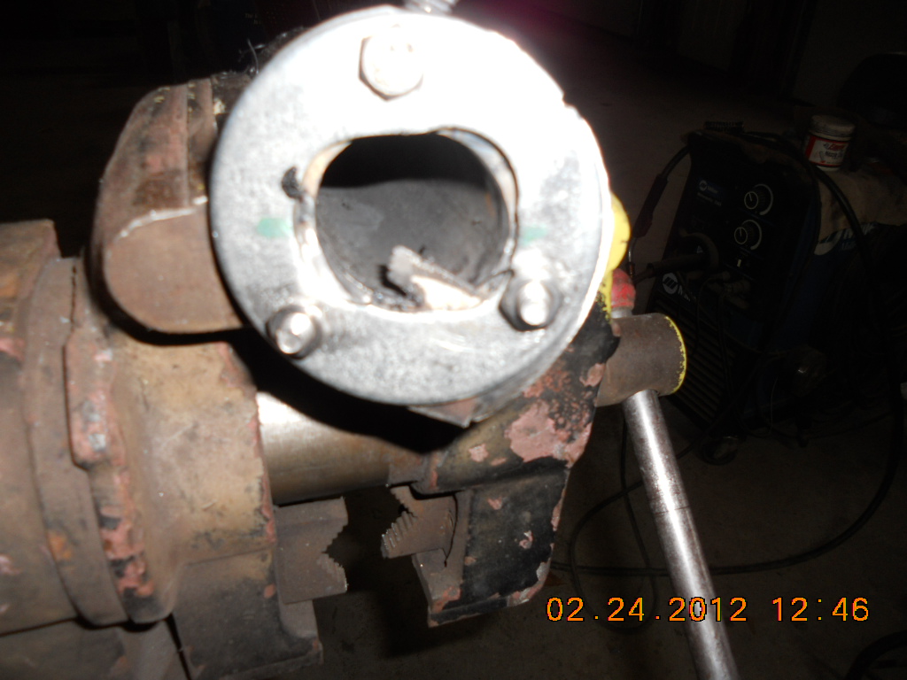

That's a great idea. Is the thumb bolt used to help guide your pipe as you're turning?
How do you turn it? By hand?
The angle of the blade makes the even spacing. The pipe is 1 1/2" and works well on std. 1" plastic well pipe. For smaller dia. tubing, I stick a pc. of EMT, steel or pvc inside the (bigger) pipe and hold it down with the thumbscrew (towards the knife) against the cutter. At about $5/ft. to buy the stuff, this works well. I hold it in the vice and twist the pipe to be slit with a pipe wrench.

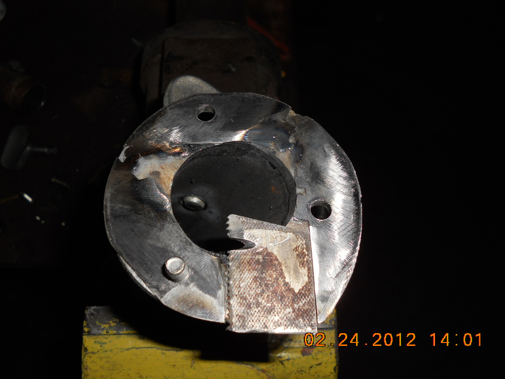

Sorry, I kept forgetting to take some better pics during the day (light). It is as simple as it looks, I'm just going to make a list of things to keep it simple.
1 The angle is 20* to make the cut in the pipe for the washers (mounting surface) this angle controls the width of the spirals. On 1" well pipe, the spirals are about 1 1/4" wide. With the small 1/2", it's more like 5/16.
2 Those round things are just big washers, about 3" across (you'll need to "egg" them out to accomodate the angle)
3 That "cutter" is a small chunk of a wide sawzall blade, the cutting "hook" is just cut with a small grinder with a cut off wheel.
4 I welded some pretty heavy lumber banding to the lower washer to act as a spacer (equal to the cutter thickness) as well as a guide to keep the cutter from wanting to rotate when cutting. The banding is just the first thing that I found in the shop that was close in thickness to the cutter.
5 The thumbscrew is to hold a smaller pipe inplace when cutting smaller tubing. This keeps it down & against the cutter, when cutting the (blue) 1" water pipe, it works just fine in the 11/2 main black pipe.
It feeds it's self through, I just use a pipe wrench on the "in" side of the tubing, with the fixture in a vice. Can't think of much else to tell you, I just "cobbed" this together and it was done. If you had some milling equipment you could make a nice recess for the blade, and instead of those "egged" out washers, a nice milled oblong hole. I used the sawzall blade figuring that it was pretty hard and should hold an edge.
