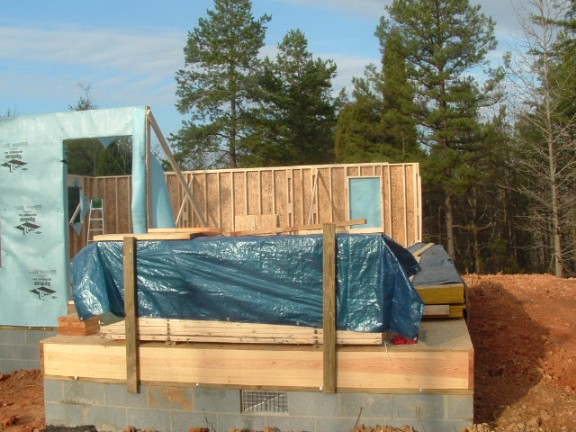

Well ,I have part of the walls up
/ Major project started today!
#11
All the wall framing is 2 x 4 16" OC with 1/2 OSB sheeting. I am installing Styrofoam brand house wrap on the outside of the sheeting, my son swears by it.
