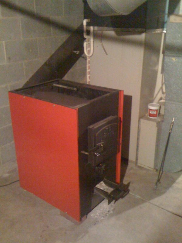

Tim,
I just went and took this picture... The horizontal is insulated/double wall o some sort, as i the part going through the cement wall. the upright is single wall.
Interesting.

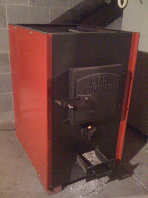

I think the stove is at least 1/2" steel everywhere, it will be impossible to move I'm afraid and unused it does get cold when it is really old outside.
Wow ... that's pretty significant ... other than the cast door on the wood furnace here at the house, I don't think they used anything thicker than 1/4" plate ...
This unit looked about like your (unpainted, rusty) when I picked it up for a song 10 or 15 years ago. There was a crack in the plate near the firebox door which I welded which can still be seen. A little work with an angle grinder and a wire wheel and some black stove paint and Ford Red engine enamel and it looks halfway decent ... still need to finish plumbing it into the central heat duct work tho':
The lack of a way to make the firebox airtight is almost more than I can handle right now, so I'm shopping for a space heater thing to make TV watching and the small play space I'm doing for my youngest daughter more comfortable...
I love the idea of heating with wood...
Whatever works and makes sense ... :thumbsup:

I haven't read all of this thread. From the look of the basement pipe where it enters the insulated pipe in the wall- I'd say the interior of the pipe is pretty dirty. To start with, I'd replace the interior basement pipe. I think the stove is fine. If you can't shut it down, insert a damper in the stove pipe. Avoid the horizontal runs. I'd replace the exterior stove pipe with Selkirk, Metalbestos. Get a pro or do it your self. All materials are available from Amazon if you want (research- go to Selkirk site). If that is a single wall chimney, it will always have back draft problems every time the weather changes. The open basement window helps to insure that the air pressure in your basement is not less than the outside air pressure. If it is, the draw is harder to get going. The insulated pipe helps keep the internal temperature stable in the flue, unaffected by temps.
Get your chimney pipe (inside and outside) cleaned if nothing else. A chimney fire could take your house. Once they get going, they suck air from every joint they can. (one is where your interior basement pipe enters the insulated wall pipe - get some furnace cement and fill the cracks every few weeks- cement falls out.) -Once you have a chimney fire you close everything down and call the firestation. You'll hear a dull whooshing roar until it burns itself out.
Is there bracing on the chimney? Does strong wind move it - or is it a vertical steel pipe that has been anchored? Hard to tell from the pics.
Good luck. As long as there is wood in the stove- consider the fire going. Embers buried in ash with a low draft can last days.

I am convinced that his chimney is entirely much too high, probably 4-5 ft would be adequate .
There is a heat shield over the single thickness pipe=OK.
Going out of foundation is double wall insulated pipe=OK (suggests chimney stack is also insulated double wall)
Concrete floor =OK (vinyl tiles =no, but easily covered over with ceramic, even loosely placed)
He did say there was bricks inside firebox=Good.
The actual stove he said was like 1/8 steel.(not tin) just watch for welds cracking)
Main thing is to keep all combustibles FAR away. (like 2-3 ft)
Do add sheet metal screws to the pipe joints however.
I have built/installed a fair number of wood stoves with all being actually inspected by the insurance co's and none were ever rejected. As well 2 fireplaces were fabricated by myself with home made glass doors and passed inspection.
All in all I think there is a little over thinking here. For all we know his insurance might just give him the OK. (other than that high stack that has no braceing)
