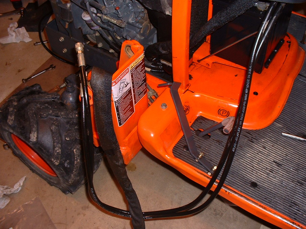

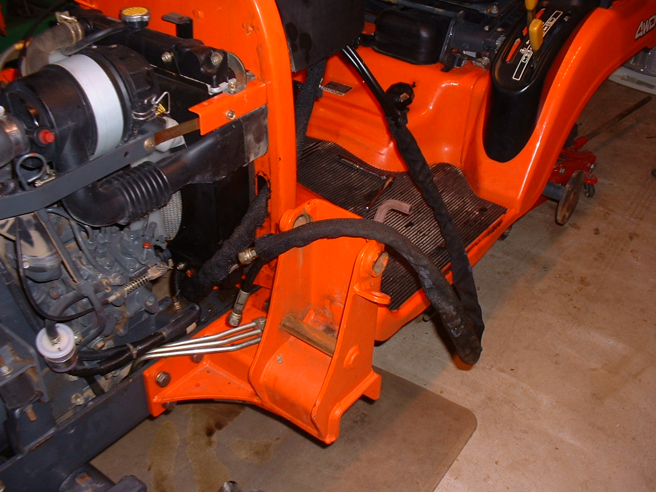

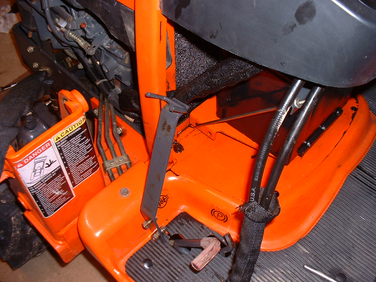

Not trying to discourage you but, like he said it's no fun. :eek: I went ahead and replaced all four hose's while I was at it. Here are a few shots of the leaky power steering hose along with the other three hose's and my Deere Kubota hybrid.:D I believe one of the others also had a slow leak.
Not to mention re-stringing the hose's through the frame under the belly and to the back wheel. I did it with no special tools / crow feet etc but, I'm sure it would have made things a some what easier. :eek::cool:
