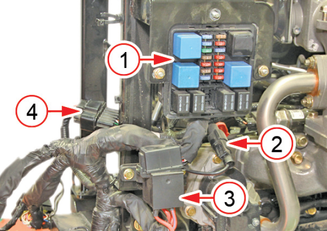

Jul 27, 2021 / main fuse 60A 4510 #1 A AVRY New member Joined Jul 27, 2021 Messages 1 Tractor KIOTI DS4510HS I can't find the location of the main fuse on my kioti DS4510HS. can someone help me with that?
Jul 27, 2021 / main fuse 60A 4510 #2 IndyJay Super Star Member Joined Apr 23, 2021 Messages 18,619 Location S.E. Indiana Tractor 2021 Kioti DK4510MS w/Loader, Grapple Prev: Massey 1250 Not sure of the difference between DS4510 and DK4510 but for the DK it is directly below the fuse box (#2 below)
Jul 27, 2021 / main fuse 60A 4510 #3 MinnesotaEric Super Member Joined Feb 4, 2014 Messages 5,490 Location Nevis, MN Tractor Kioti NX6010 The main fuse on an NX is right behind the coolant reservoir, in front of the radiator.
