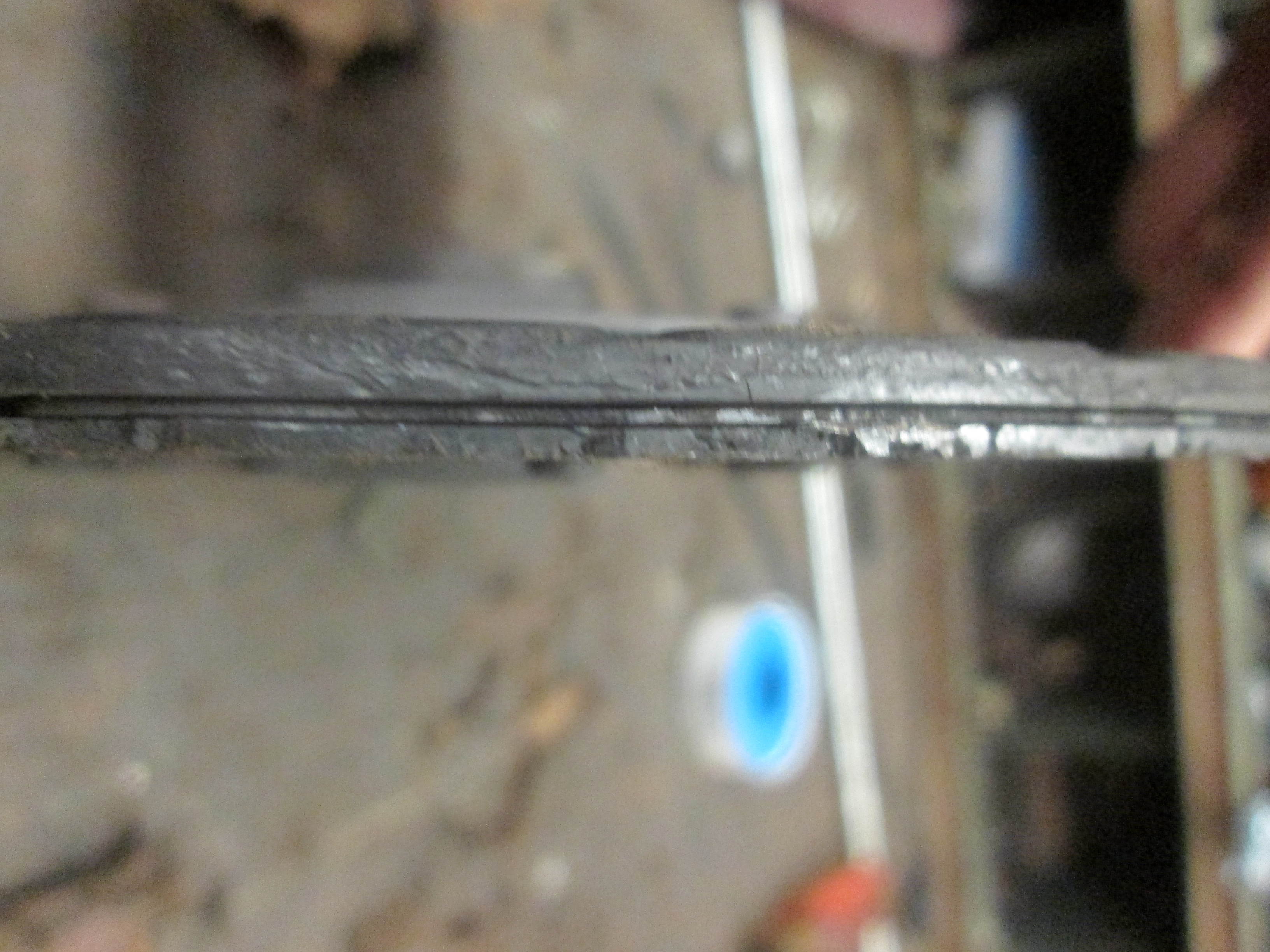

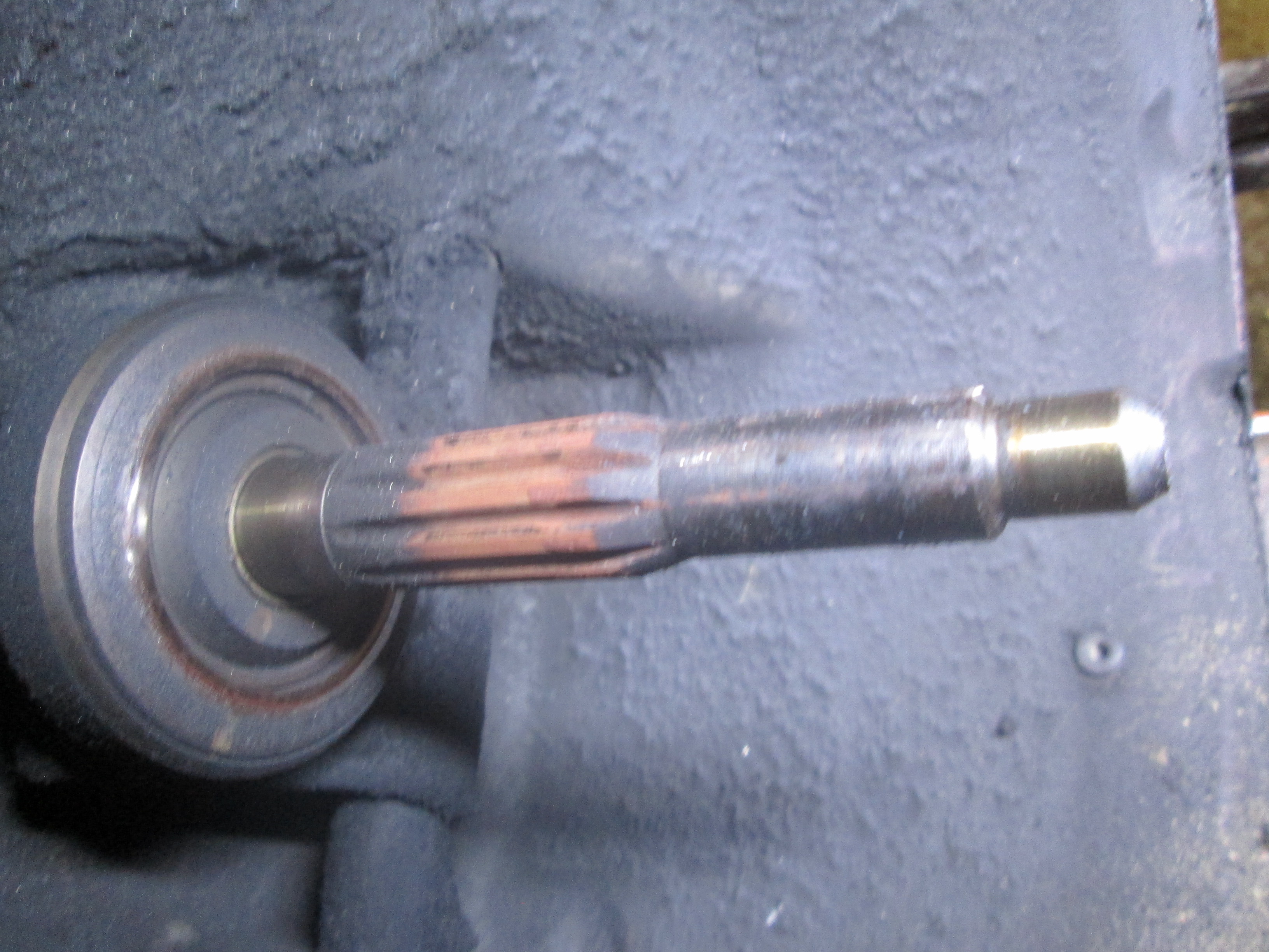

   / MahindraClutch Problem Revisitrd #3
This is what a found on the last Mahindra stuck clutch I had. Only had 100hrs on it. Excessive free play causes clutch wear by not fully releasing the clutch. To little can damage the release bearing, pressure plate and clutch. Usually loss of free play indicates the clutch material is coming loose from the metal disk.

If the clutch binding to the shaft is a known issue I’d think there’d be some type of lubricant or coating applied to prevent the corrosion and keep the clutch from sticking. Seems like a better solution then putting a little swing arm that you need to move to keep the clutch engaged when not using the tractor for some unspecified length of time.
   / MahindraClutch Problem Revisitrd #5
Lack of lubrication is the point. I'm finding little to none. JD had the same issue a few years back with the 5200 tractors. Spent the summer splitting tractors just to lube input shaft splines. :thumbsup:

If your tractor has a FEL butt it against something solid that wont move. Hold your foot on the brake. High range, high gear about half throttle. Let the clutch slowly out. It should stall the engine if clutch is good ! FYI A stuck clutch will wear the clutch as shown in the edge on photo of clutch I posted as a reply. Note the thickness of the clutch material on each side of the disk! This unit would move ok on the level with no load. Get on a hill and it would stop moving.
