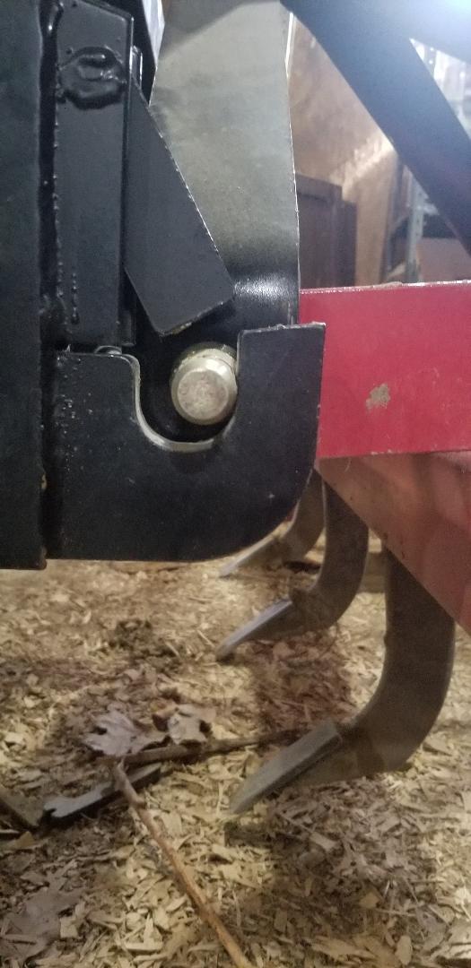

I currently purchased a Mahindra quick hitch and 6' box blade for my Mahindra 1533. I was wondering if it is sitting correctly because the bottom pins don't seem to rest on the quick hitch support. I have the top hook attached at the lowest point on the quick hitch, and not sure how to potentially correct this. Do I need bigger bushings for the 6' box blade? You would think when purchasing A Mahindra box blade and a Mahindra quick hitch, things would match up correctly. Thanks for everyones assistance in advance. Jim

Normally when using a quick hitch, bushings are used.
A cat 1 quick hitch the implement will get bushings cat 1 to cat 2,
a cat 2 quick hitch the implement will get cat 2 to cat 3 bushings.
   / mahindra quick hitch question #4
You need to buy some bushings. Cat 1 to 2 and Cat 2 to 3. Put them inside each other. This will work if you are running with a clevis style of implement. If you have to pin style you need this. Quick Hitch Adapter Bushing Kit - Category 1 Make sure you buy enough for all your implements so you are not switching them around.
