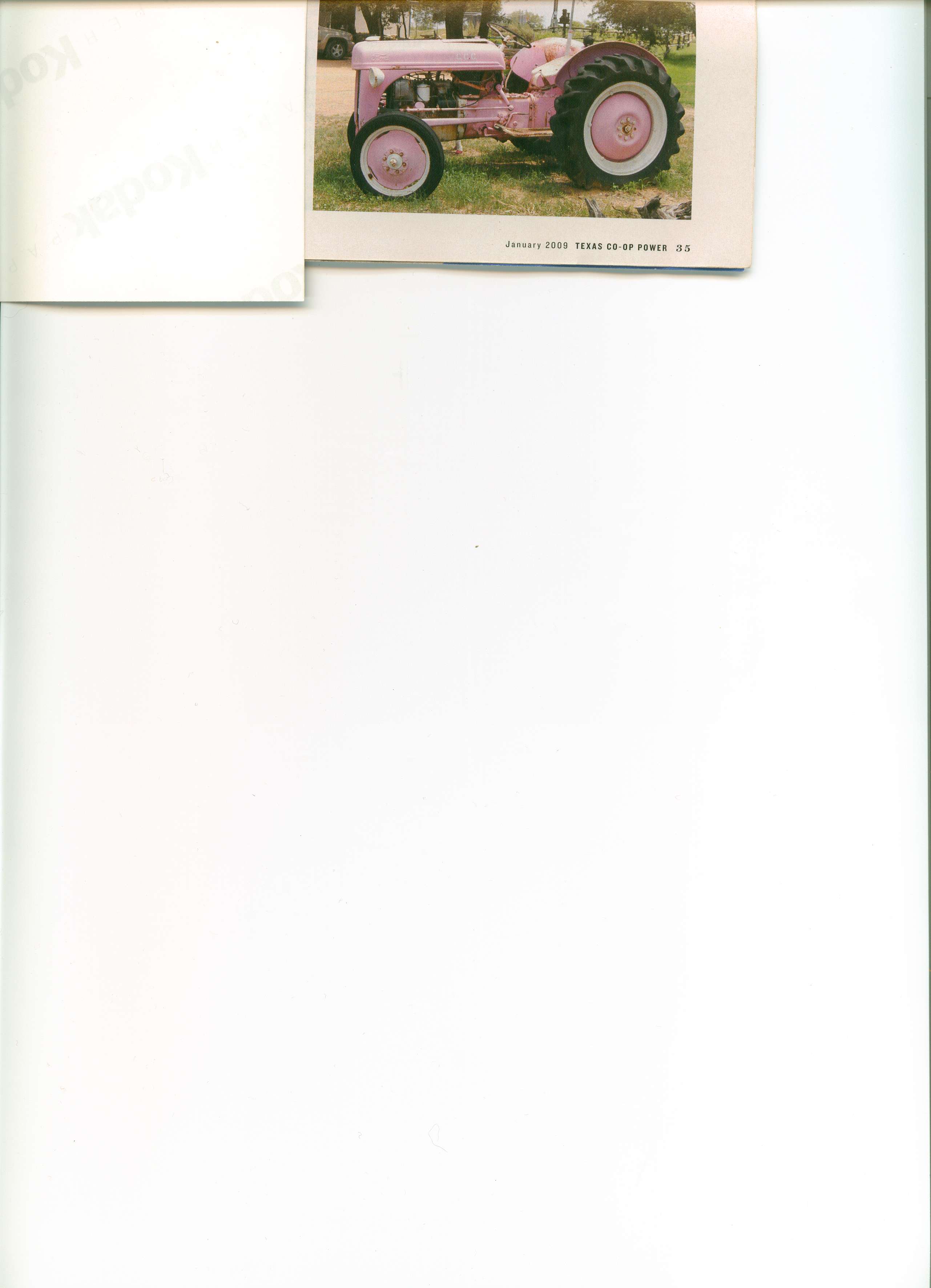

I have had my 6520 for 5.5 years and no fading on it or the KMW 275 loader or the Bradco 511 backhoe. My 2002 Red Dodge Diesel never faded either. Both sit outside. Never seen a pinkish Mahindra here in Texas. But I have seen a pink Ford 8n.
