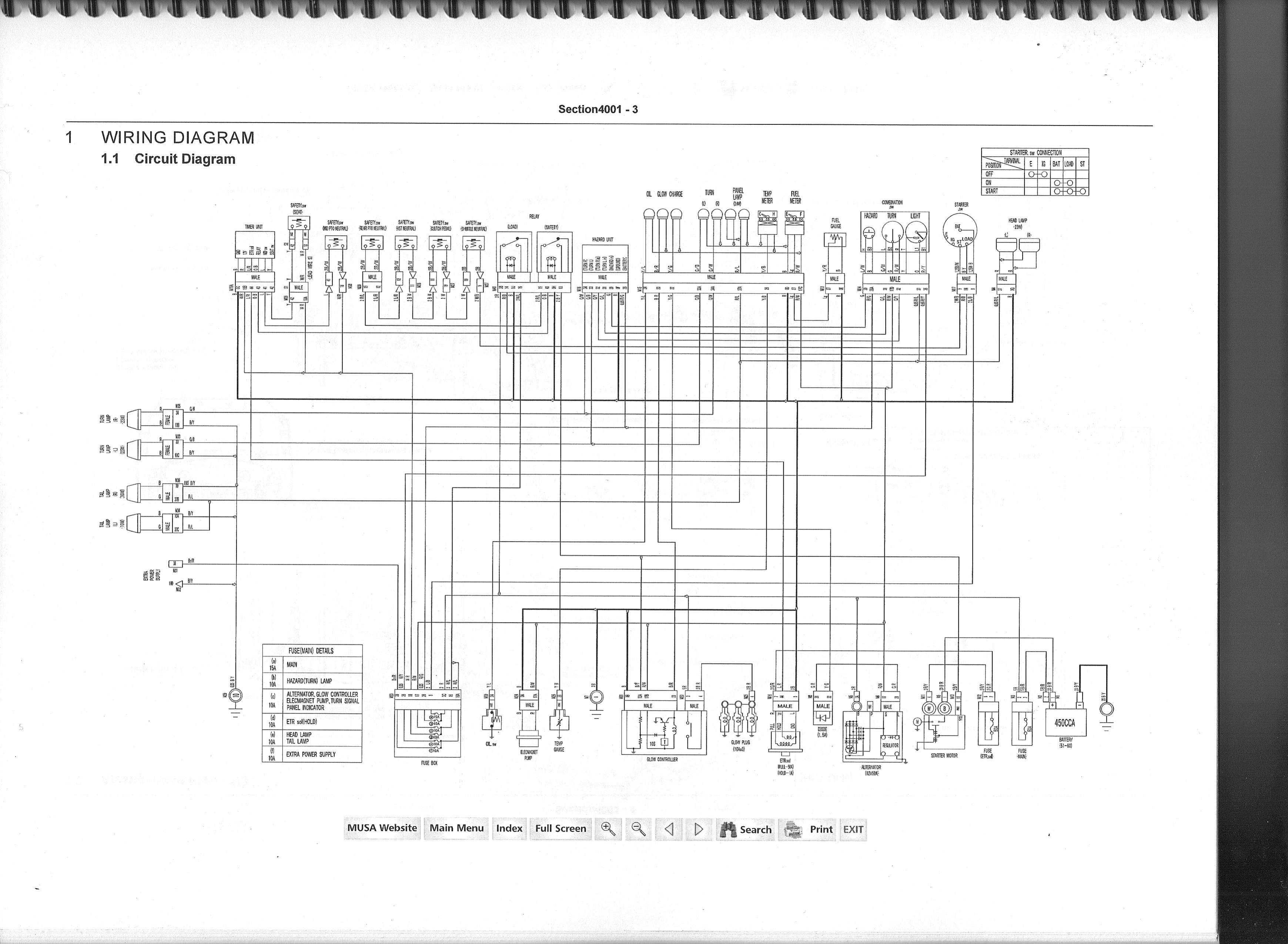

Jim

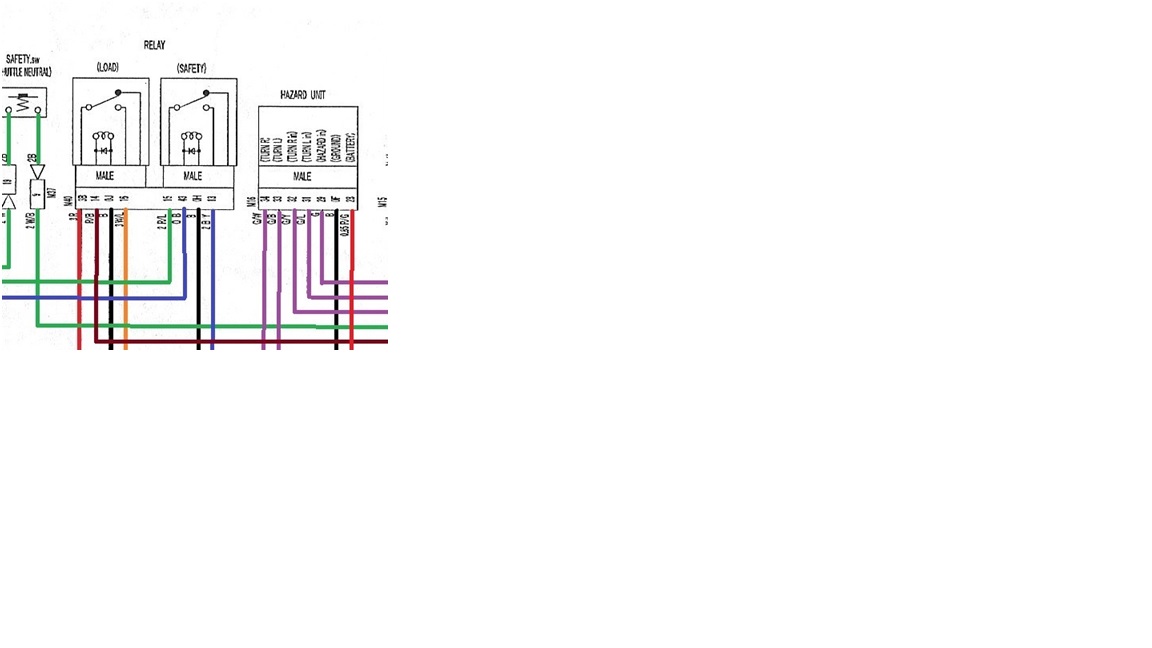

If you would like a good schematic of your tractor I can send you one via email. The Pic is large so you can read it easily. I colored it too, so I could see the circuit(s) better. The colors are not exact but make it easier to read. I would start at the two relays and go from there. There was water found in my ETR solenoid as well. Shoot me a pm and I will email it to you :)

It appears that I have the same issue... 2014 Max 28XL, was operating and all of a sudden just died. After a taking all the covers off and checking of wires, could not find a possible problem... trouble shooting, found that I lost power (12V) from the fuse, to the load relay. (after getting a really good schematic on line). Made a jumper, jumped across, and the tractor started right up. Now after several hours of operation the tractor won't stay running. It will start, but once you release the key, to go from start to run, it dies. I have checked on-line and the consensus, is that it may be the fuel solenoid. An easy check, from what I hear. Just need to find it. Any help would be appreciated.

Here’s a 26xl schematic with hst should be similar also copy of solenoid replacement for the MHI motor. Located on the back side of the injection pump hope it helps
