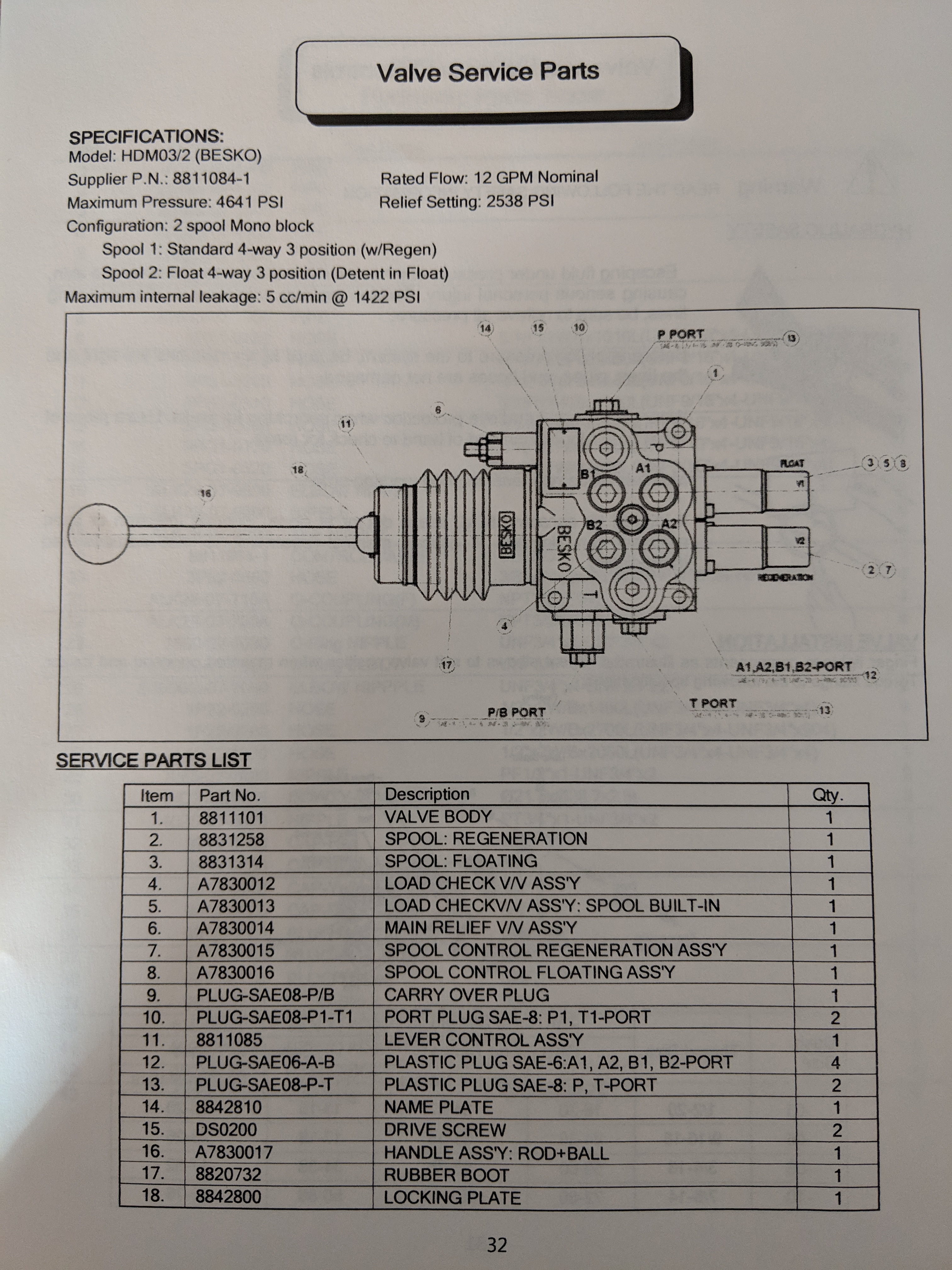

2014 Mahindra Max 26XL bucket will not lift at all. This is the only function on the front loader hydraulics that will not work.
I have bled lines, refilled, maxed out, changed lines, etc etc. I assume it has to do with the Besko HDMO3/2 (drawing of valve attached) spool valve but I cannot find any diagrams on the spool valve or any replacement parts. HELP!!! I have removed the floating spool and do not see any internal issues but im by all means no hydraulic mechanic, should there be some O rings in there?
It could be easier / cheaper to replace Besko Control Valve HDMO3/2 with something like Prince so I could get parts but that could be expensive and I would have no clue what model would compare.
Thanks in advance!!

Does your joystick have cables? Have you tried reversing the lift and dump hoses on the loader? If the bucket then lifts and will not dump then it could be a broken cable. They can rust out due to moisture in the sheath.
   / Mahindra Max 26 XL Hydraulic Besko Spool Valve Issues Bucket wont lift
I have reversed the hoses and the bucket does not dump. Hoses were switched and no change. This is why I assume it痴 in the hydraulic control and is more than likely to do with the spool valve i.e. internal 登 rings or ??
I really appreciate the help and response though!

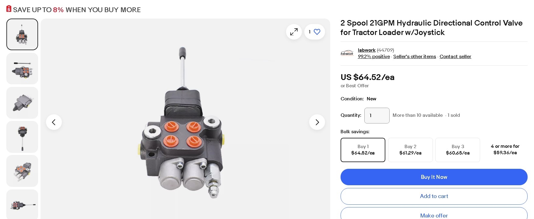

I'm going to try ebay 2 Spool 21GPM Hydraulic Directional Control Valve for Tractor Loader w/Joystick | eBay

Did it work?
