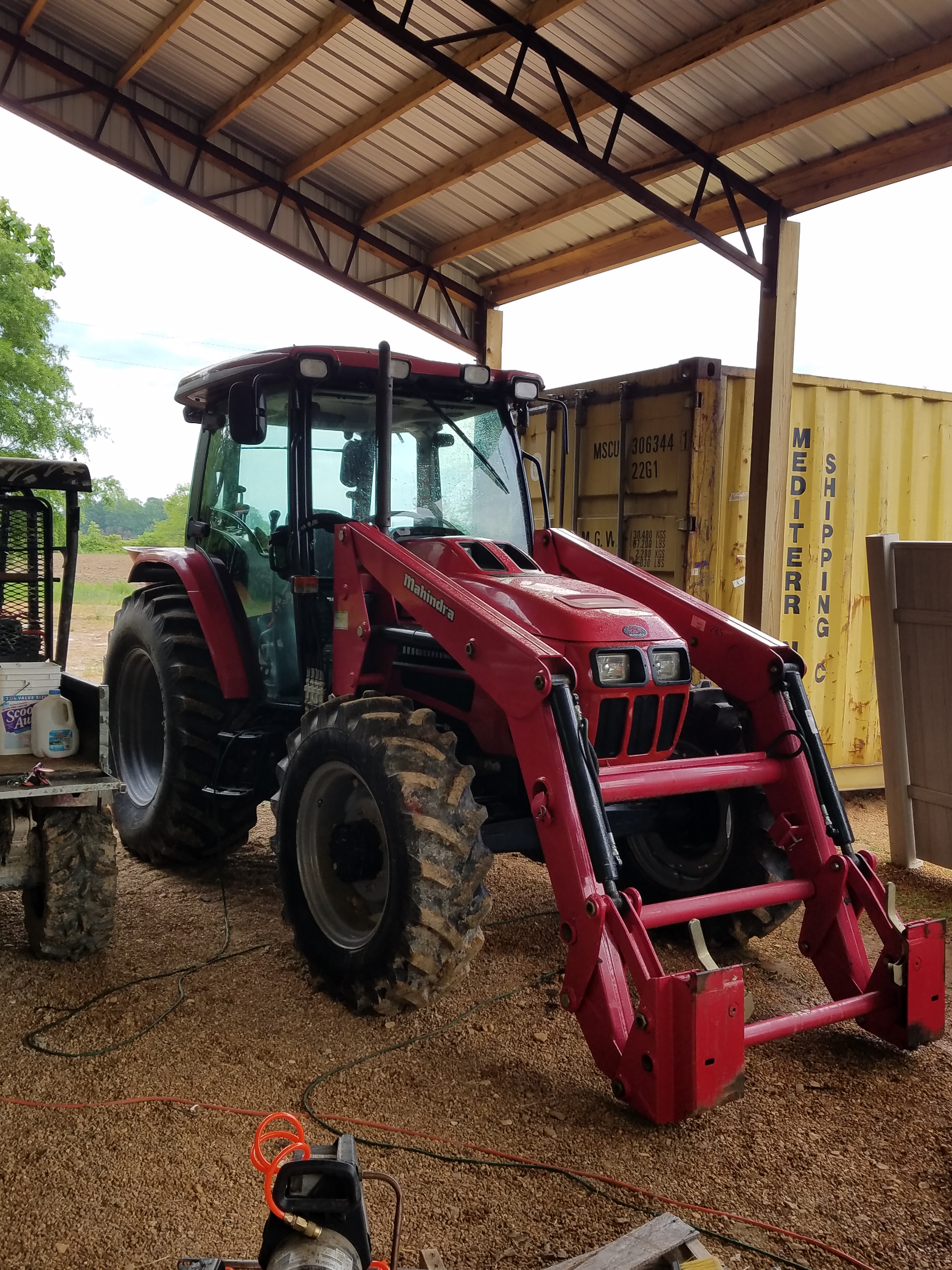

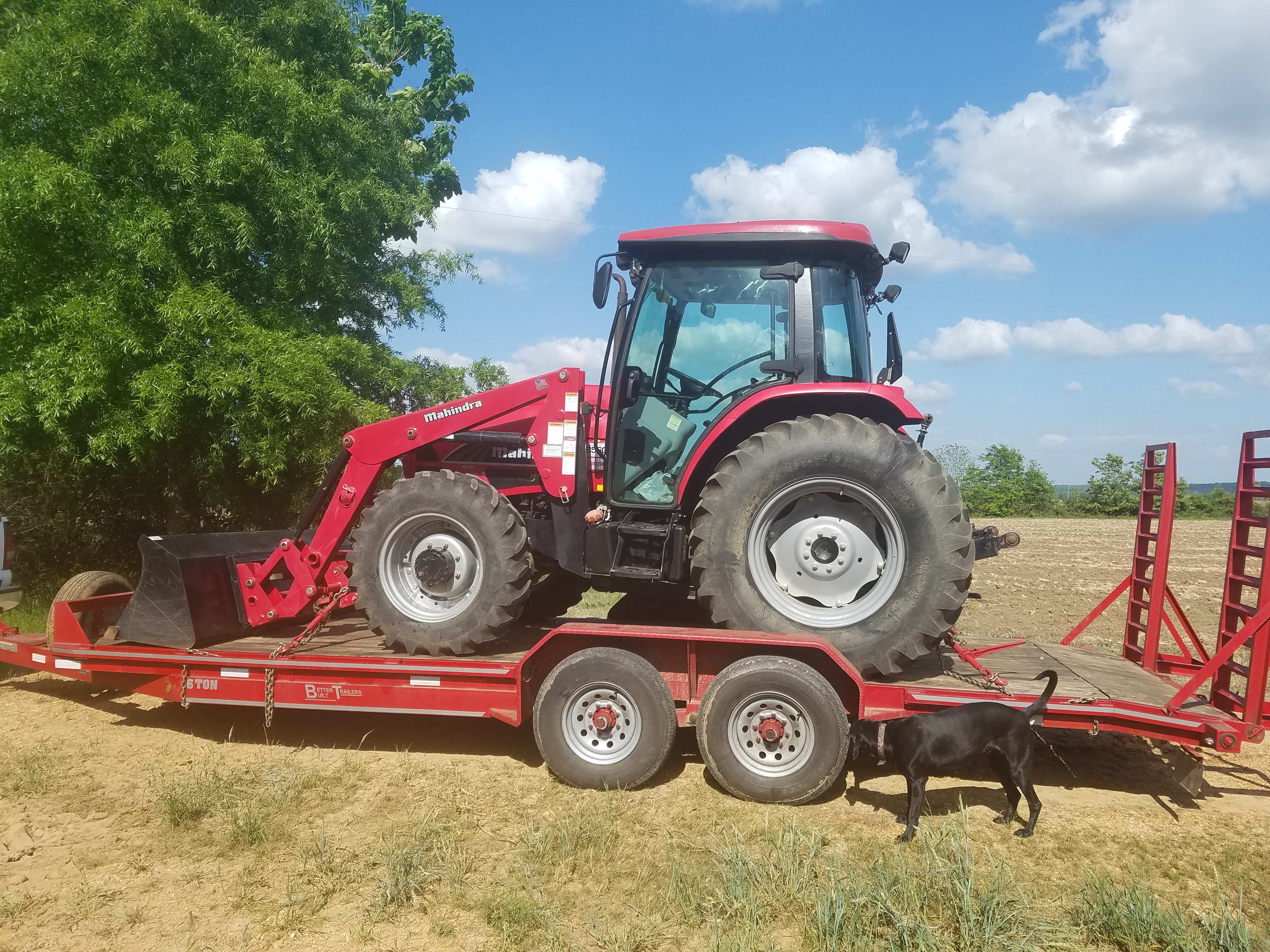

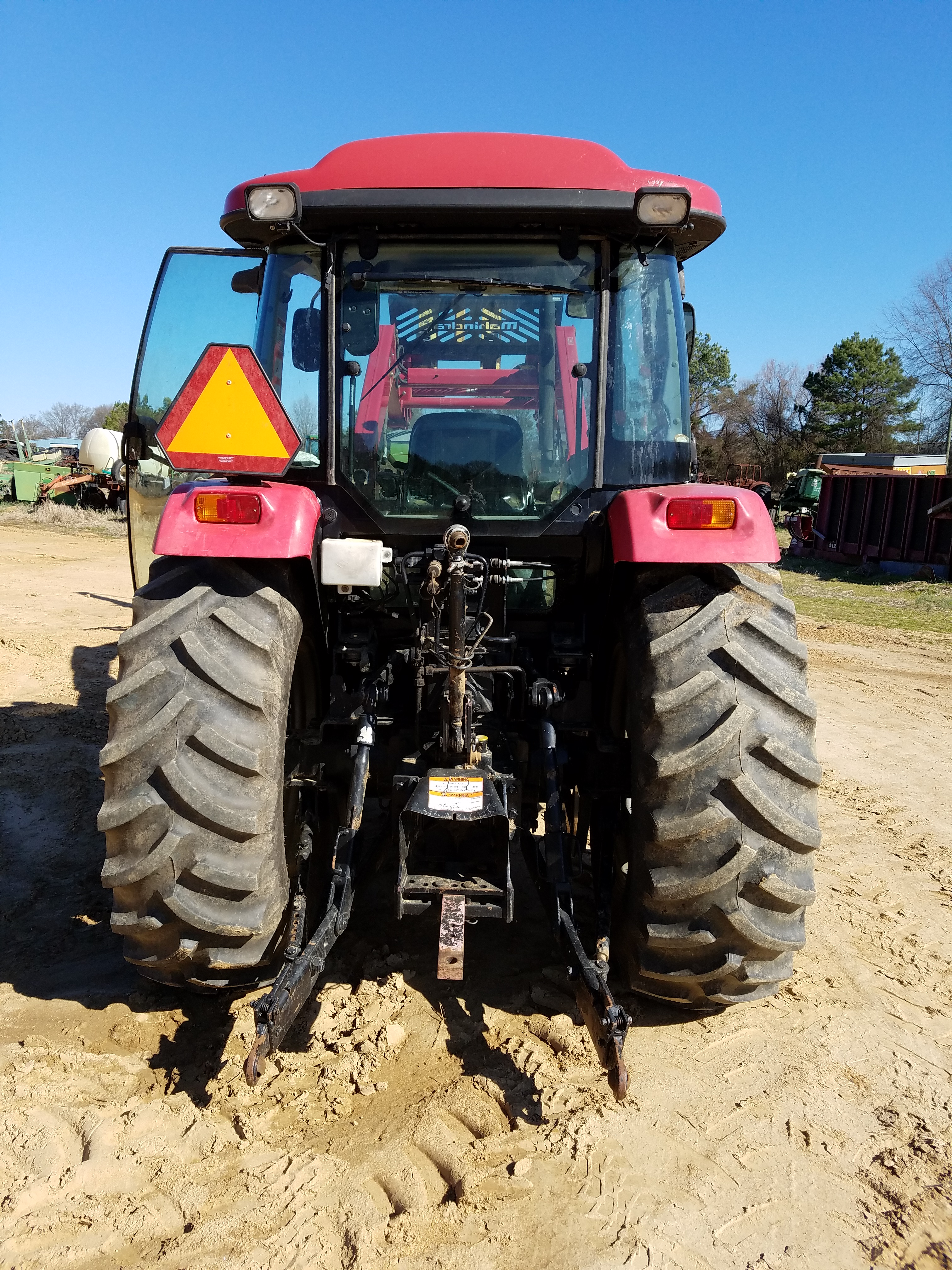

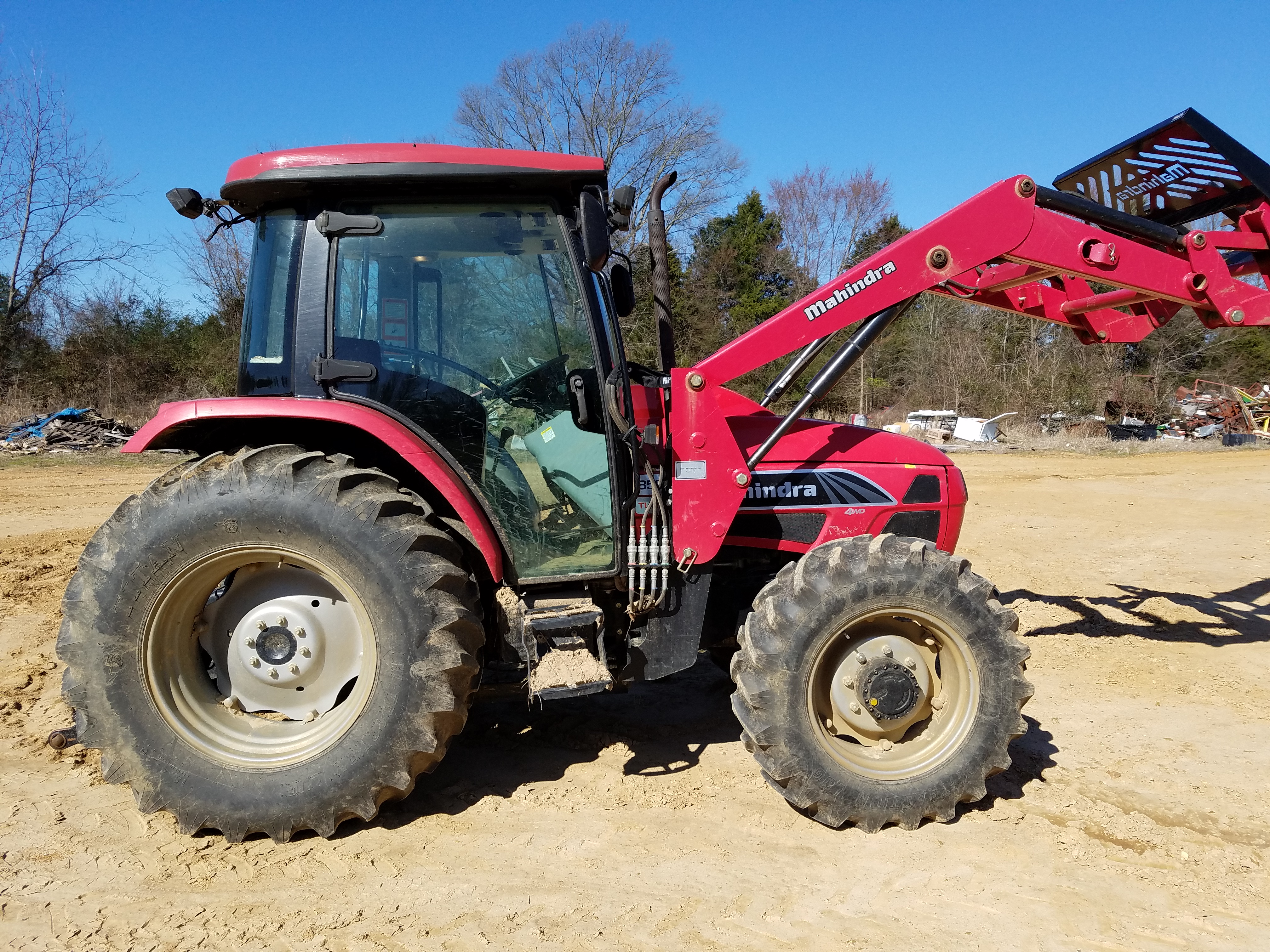

I got the 8560 last week, 5 years old with 275 Hrs. Needed some TLC on battery post, light connections, dented up grill and AC filters were plugged with dirt. Needs 16x16 tranny but will do what I need.
20170419_160609_001.jpg8560 (2).jpg8560 (6).jpg8560 (5).jpg20170422_075053.jpg
