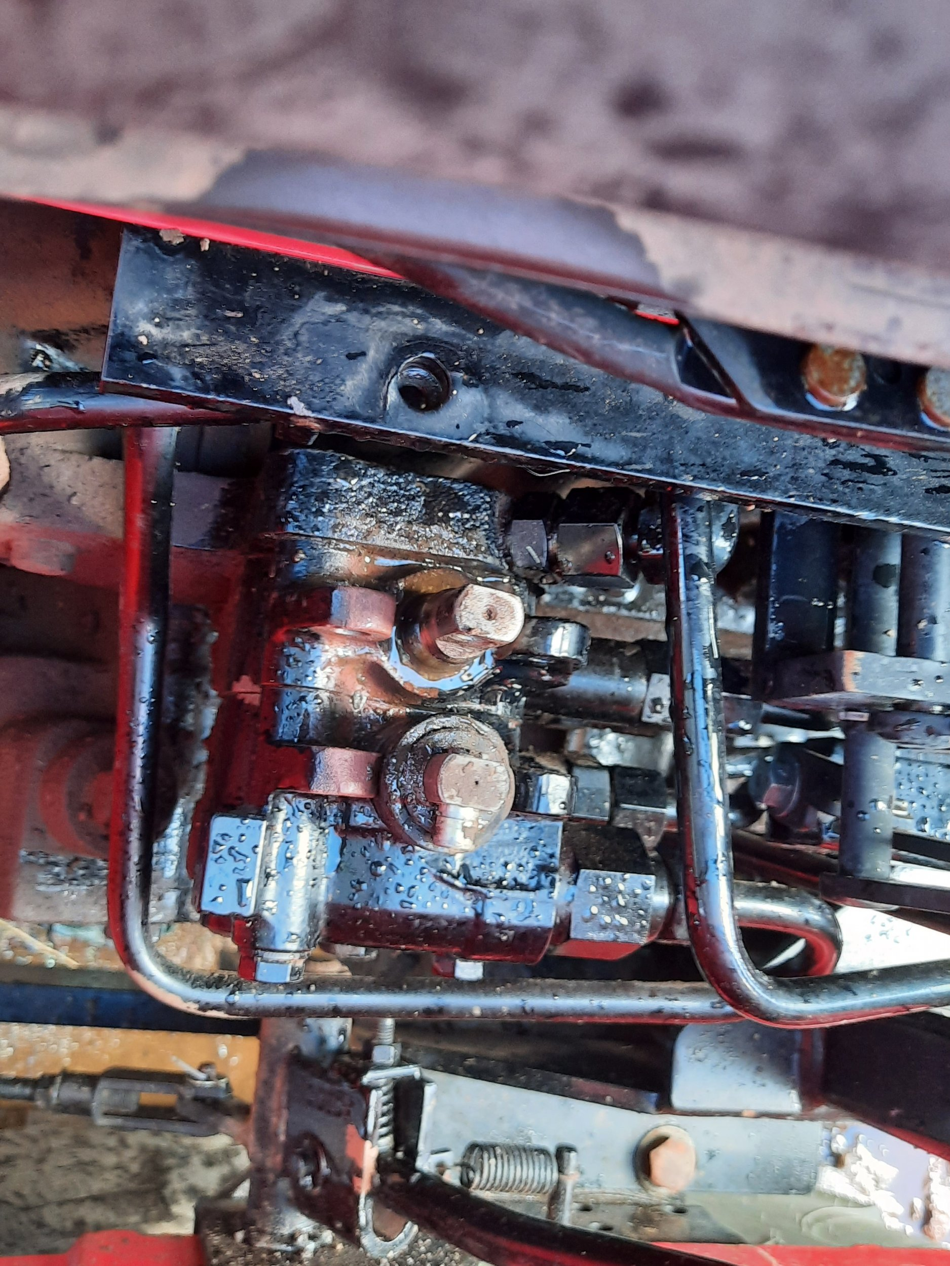

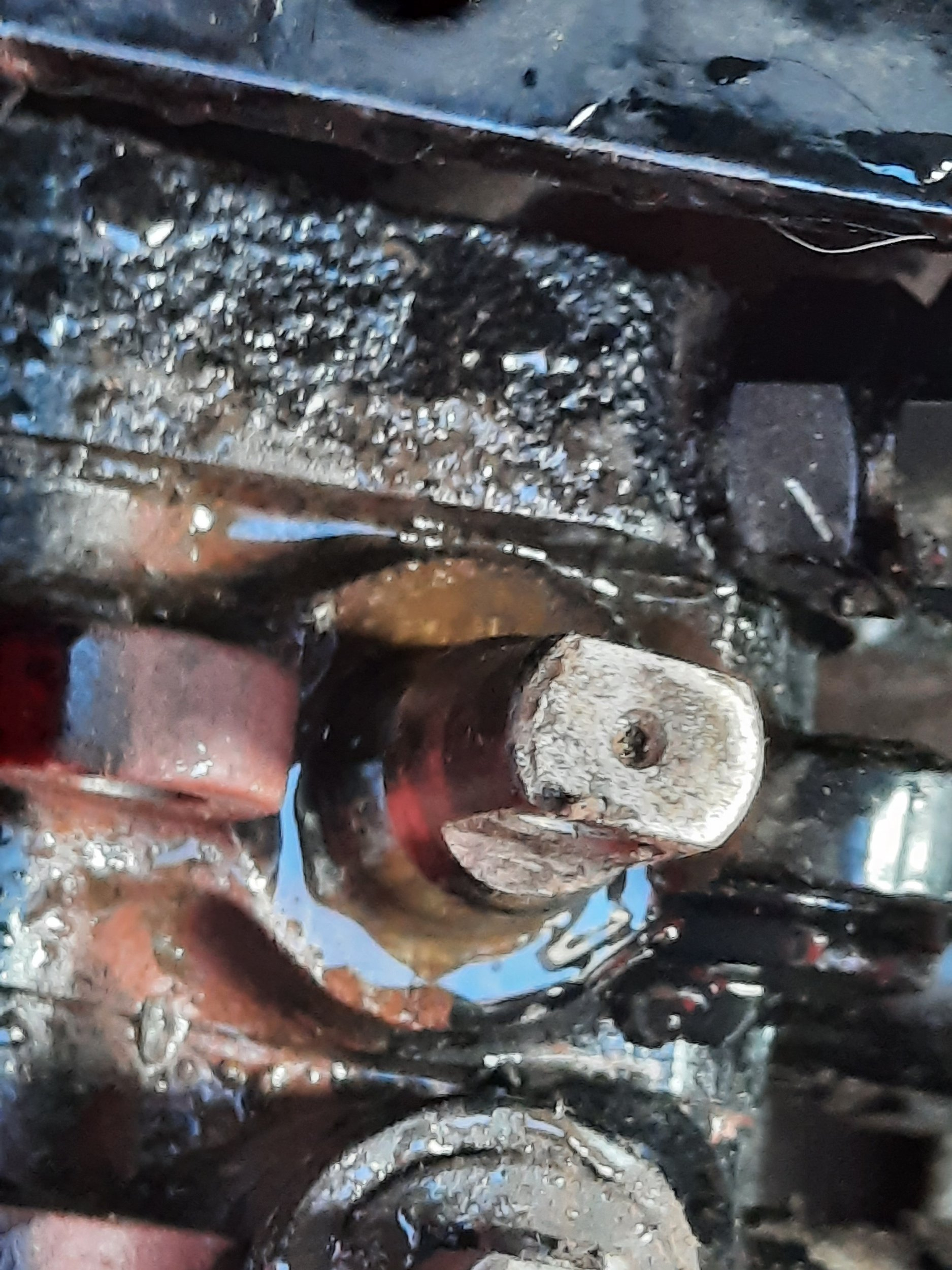

Absolutely know how to fix this. Same thing happened to mine. The seal that is used in that valve is called a quad ring. Looks like an o ring but instead of being round it’s a four sided ring that fits into a groove inside the housing and the valve shaft goes through it. The parts are not available from mahindra but they will be glad to send you a complete valve assembly for around 1100 bucks. The part you need can be found at most any hydraulic cylinder repair shop and it is a simple fix once the valve body is removed from the tractor. Supply house didn’t even charge me for the new ring as it would have cost him more in time than what it was worth to look up a cost. What you will notice is the ring that comes out of the valve from the factory is very stiff and from what I was told was not the correct material for what it was used for. Changed mine with a softer more pliable material in the same size and have never had another leak. I realize I’m several days late seeing this but hope it helps anyway. Please don’t fall for the line from the dealer about having to replace the entire valve body, it is a simple fix that at most may cost $1.00 and a little time.
   / Mahindra 5570 Rear remote leak #5
Also, Incase you get to looking for one and do not have the old one for comparison, the size you need is 3/4”id x 1”od x 1/8”. I’m sure the one Mahindra used was probably a metric size of some sort but this one works perfectly.

I attempted to take the valve bodies and the hard hydraulic lines to the remotes themselves off together in one group. It could be done and would likely be easier with removal of the rear tire cover but I fished them out and back in without removing a lot of items. 2 major notes....take pictures of the hard lines and how they are installed so its not guess and check on re-install.
Once their out, they are really easy/simple to take apart. I couldn't find a hydraulic shop locally that had the correct quad ring so I substituted for standard o-rings.

I'm really glad to find this post. I just picked up a 5570 w/86 hours on it and this valve is leaking. I've attached a couple of pictures of the valve without the controls connected. The close up is after I wiped that area clean and had run the tractor for only a couple of minutes. It starts leaking around the stem immediately. Thanks for posting this thread!
