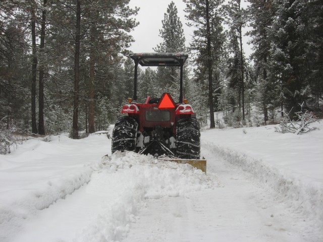

Plowing snow

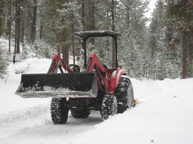

Backblading snow

All in all I have to say that I love the tractor. I would however, if I had the money, love a cab! AC and heat wouldn't hurt but I live with an open seat and besides I've run the canopy into the trees more than once!

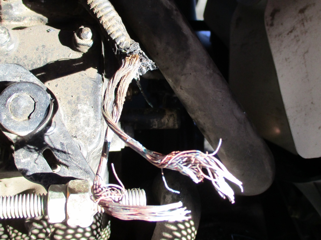

Well winter is here and after fixing my plow blade to get ready for the snow I couldn't get the tractor to start! After jumping it and getting the battery charged a bit it turned over.....and over and over and over.....no jelled fuel (wasn't that cold though it did drop into the teens a couple times but it was in the 30's when I tried to start it) and no other obvius problem.
Left the key with a neighbor as I had to leave and just learned the wiring harness has some melted wires in it! Not sure what happened as I drove the tractor to drop off the plow at my neighbors and then back to my place and parked it. No problems up to that point and now, a month or two later and the tractor is dead :( I'm going to try opening up the harness and splicing in some wire but am wondering if perhaps a rat got in and chewed the wires...no idea yet but am worried! It's 45 miles to the dealer and I don't have a trailer or truck to tow the tractor and couldn't get a trailer to it now anyway so it's either splice in some wires and get it running, or, sadly, let it sit all winter until I can get it to a dealer.
Well it seems I had the wiring to the injector pump solenoid burn. The fraying suggests maybe a rat got in their and chewed them but I have no idea.
$260 for a solenoid! Ouch!
