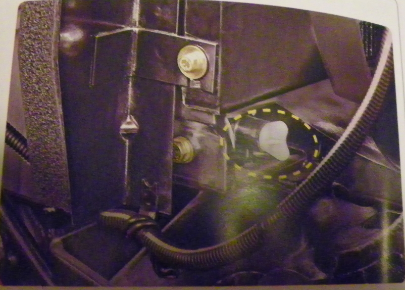

We have the 4540, it looks like if you take the grille off the front so you can get to the battery it would be on the bottom front left. Our book shows a plastic screw in plug.

Here's the picture from our book.

Thanks for the reply.
That is the plug on the bottom of the radiator, I saw that plug.
Cannot find the one one the left hand side of crankcase.
