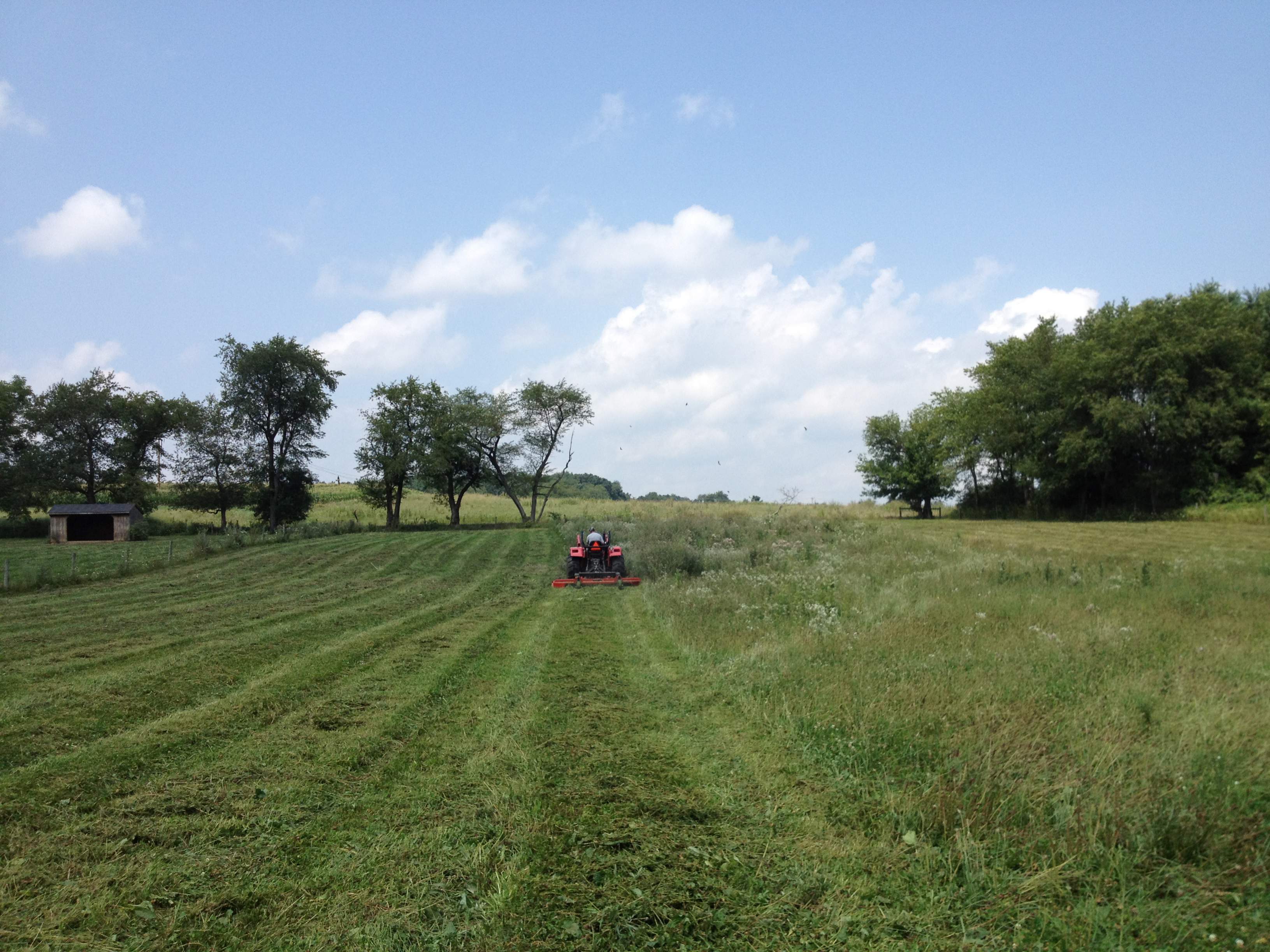

I also have a 5530. Great tractor. We sold our Kubota L4400 then upgraded to the larger Mahindra utility tractor. It's a 4X4, shuttle, R4 tires filled with Rim Guard, FEL, QA Pallet Forks, 8' Kodiak HD Landscape rake, and 10' Kodiak HD Rotary cutter (lift type). Weighs in the neighborhood of 9,200lbs! Here is a pic of our first time mowing with the 5530 and the 10' rotary cutter... Thistle was taller than me sitting on the tractor! Both tractor and cutter manhandled the weeds...
