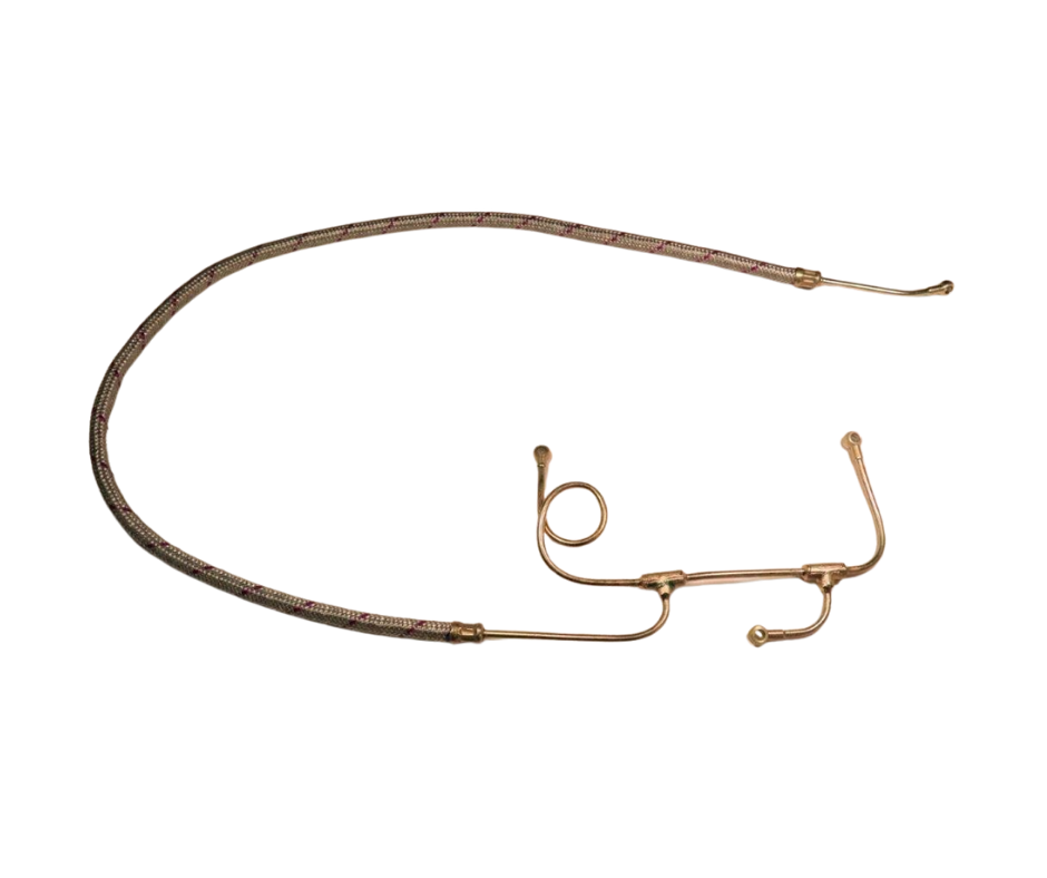

Hi fellas, can anyone help me identify this hose on my father-in-laws 4025? It runs from under the seat down through the floorboard and connects underneath the machine. The hose is leaking hydraulic oil (I think) and appears to have been chafed by the metal strap that secures it near the seat rail. You can see the shiny worn section of the braided hose where the leak is.
Also is there a way to tilt the seat up on this model to access underneath? If not I'll need to pull the whole seat off.

Thanks for the help! I was finally able to get the pic uploaded. Does that match the line you linked?
-edit after searching a little bit this guy had an issue with the same hose. His pics are much clearer. Mahindra 4025 Hydraulics

yes, I had to replace mine
Also, there was a left hand and right hand version of the line, the way the tube was bent at the banjo fitting. Can't remember which was the correct one.

Thanks again for the help. I received the part today and will be installing tomorrow.
I appreciate Simon's advice on tilting the seat too. I was scratching my head over that one.
