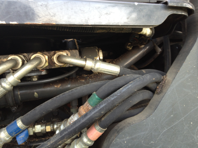

I bought a 2010 Mahindra 3535 with the fel. I bought a new 5 foot standard duty brush hog without the clutch. (oops...) I finally got the tractor delivered and with a big old grin i jumped on it to give it a try. She fired up like a dream. I pushed the pto button and bang! The sheer pin in the brush hog bit it in 1/10th of a second. I wasn't all the way idled down but it wasn't revved either. I drove into town the next morning and got a grade 8 bolt to put back in. It worked (i used very low idle to start it) but it sounds really scary when it fires up. Talk about a hard starting son of a gun... I learned here about the accumulator fix for the hard starting pto.
The question is how do I know if mine already has the upgrade? The dealer thought it did. I am concerned about running other implements and damaging them. I will get the slip clutch added to my brush hog but that doesn't help any other implements.

I agree with Jim, that grade 8 bolt for a shear bolt isn't a idea. Look under your right foot rest and see if there is a little metal tank under there. If there is then the tractor is up to date.
   / Mahindra 3535 sheer pin
Hmm... Well sounds like I am headed back to the hardware store for some grade 2 bolts. Thanks for the advice on that.
I don't see the accumulator there. Am I looking in the right spot?

the way your are describing it is doing the same thing mine did before I had it fixed with the accumulater issues. no issues since it was fixed but prior to that it started so hard. I think it was even shearing of grade 5 in a second.
#9
donawilcox,
Can you post a picture of the accumulator? I am pretty sure mine doesn't have it but I would like to be armed with information before I call the dealer back up to fix it. He didn't seem sure of what I was talking about when I mentioned this to him.
