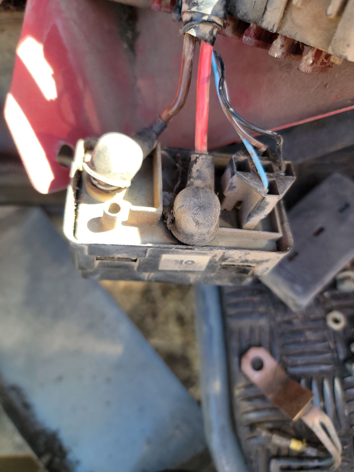

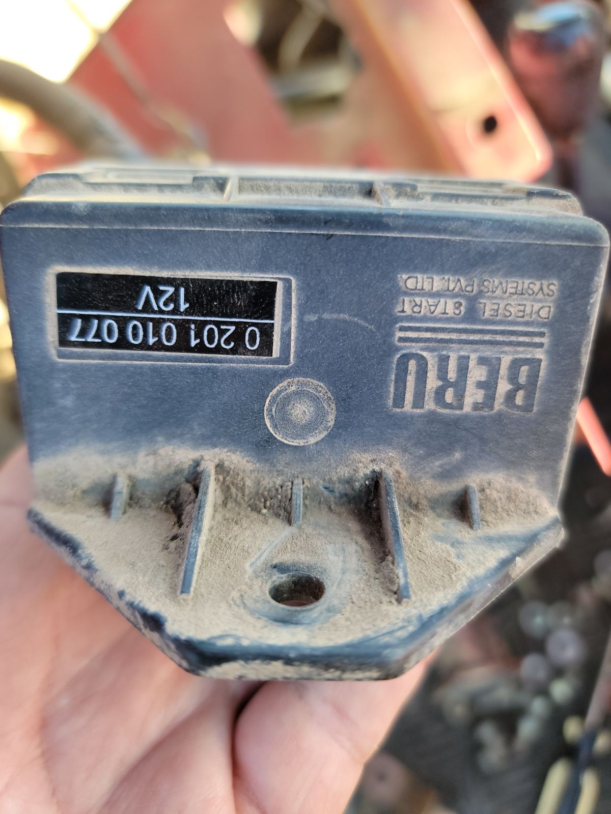

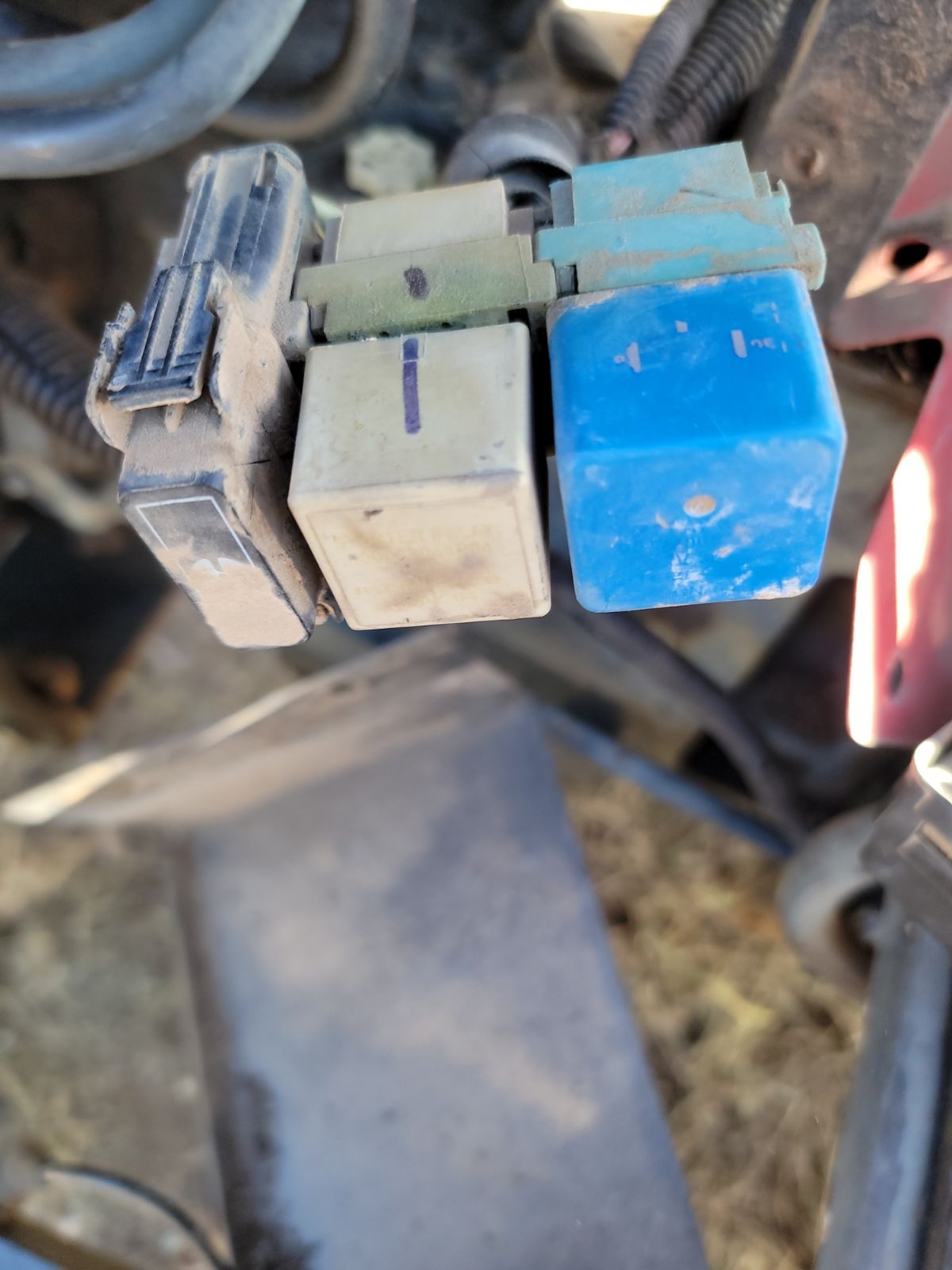

Thank you all the is my first post. I drove the Mahindra 3525 diesel tractor to dump some limbs, and it just started dying. I had to tow it back up and charge up the battery. It cranks good and there is diesel at the fuel rail, I drained them to check for water. I also checked the fuses, and I am wondering if it is one of the relays or controllers but not sure how to check them. Here is a photo of the relays and controller. I checked for voltage at the controller with a test light and got constant power on the brown and the red was on till you hear the timer click then it shuts off. What else should I check maybe the ksb timer?
