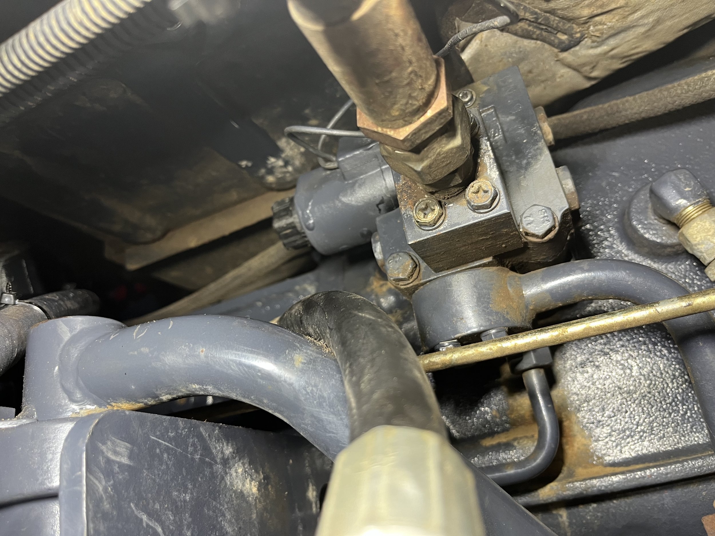

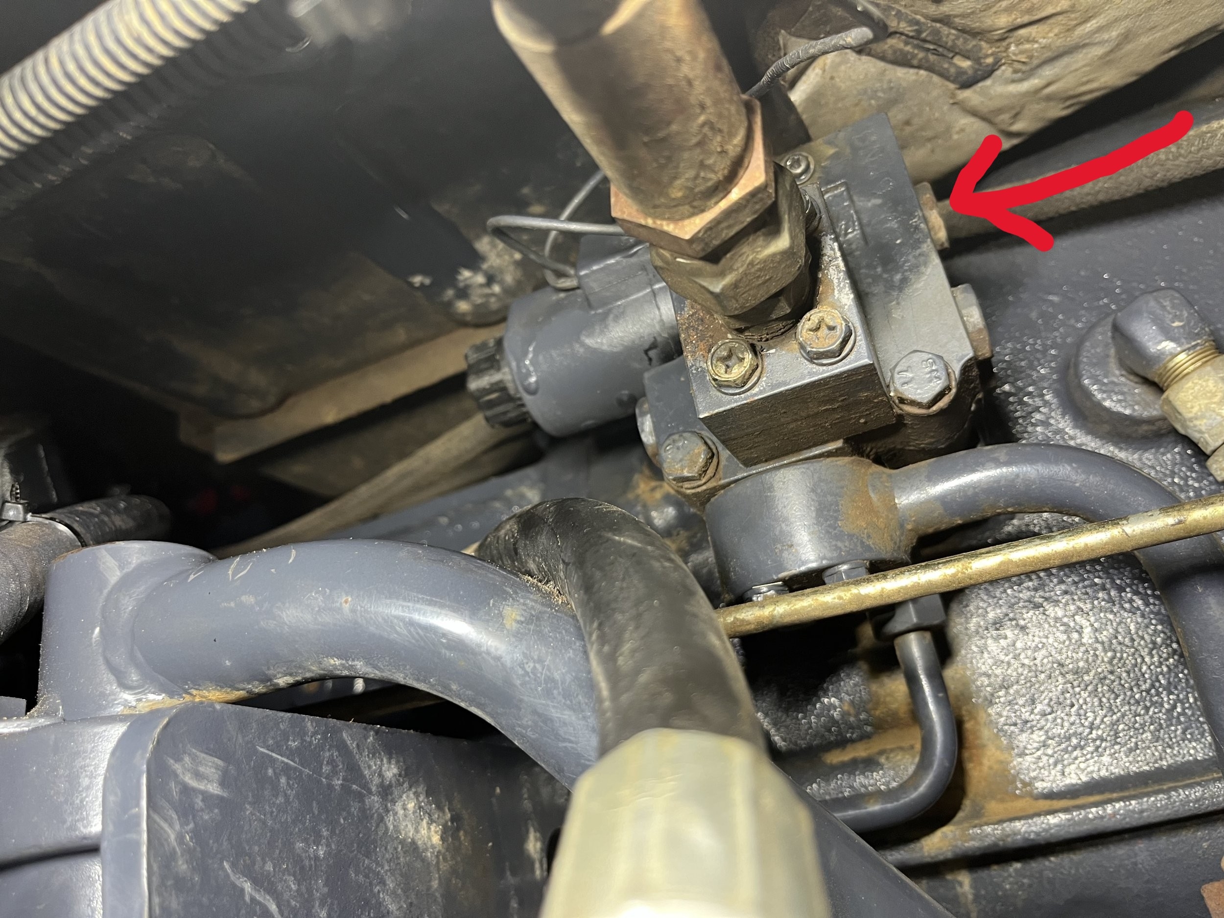

I know this post has been out for a while, but I had the same problem. I found a post where another member had sent me the solution. I had noticed when I don't use my PTO for a period of time, it won't activate.
The solution is to take a regular hammer (does not have to be a heavy one) and tap on the PTO Valve in the location as shown in RED, in the attached picture. 4-5 taps usually does it. If not, repeat, it has always got me going.
Again, I can't take the credit, if I knew the member I would credit him.
