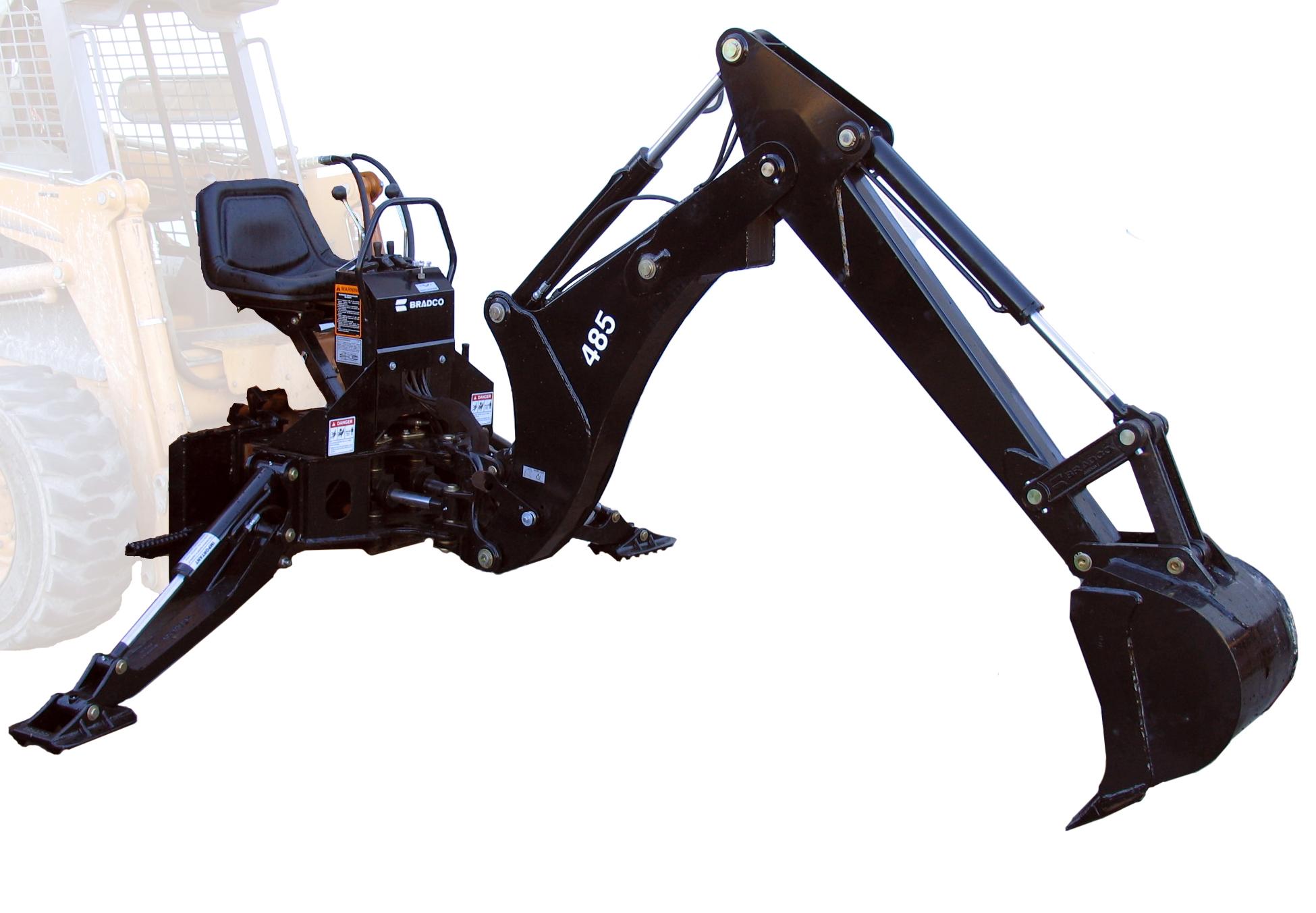

Where can we find the specs on the 485?
Google, or go to Bradco's website, but here you go: 8'5" depth, 10'7" reach, curved boom, adjustable swing speed, looks nice.
