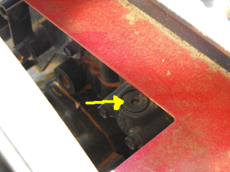

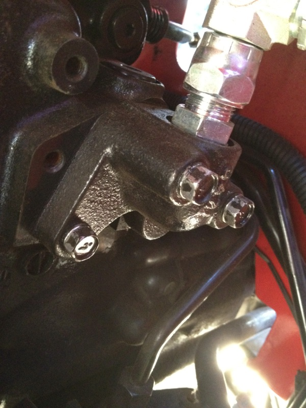

I believe this port , which if it exists on your model will be located under the right side of your seat, can also be used as a hydraulic tank return, instead of T'ing to your loader valve out. See pics. Second pic is from fellow member yeeehah.
