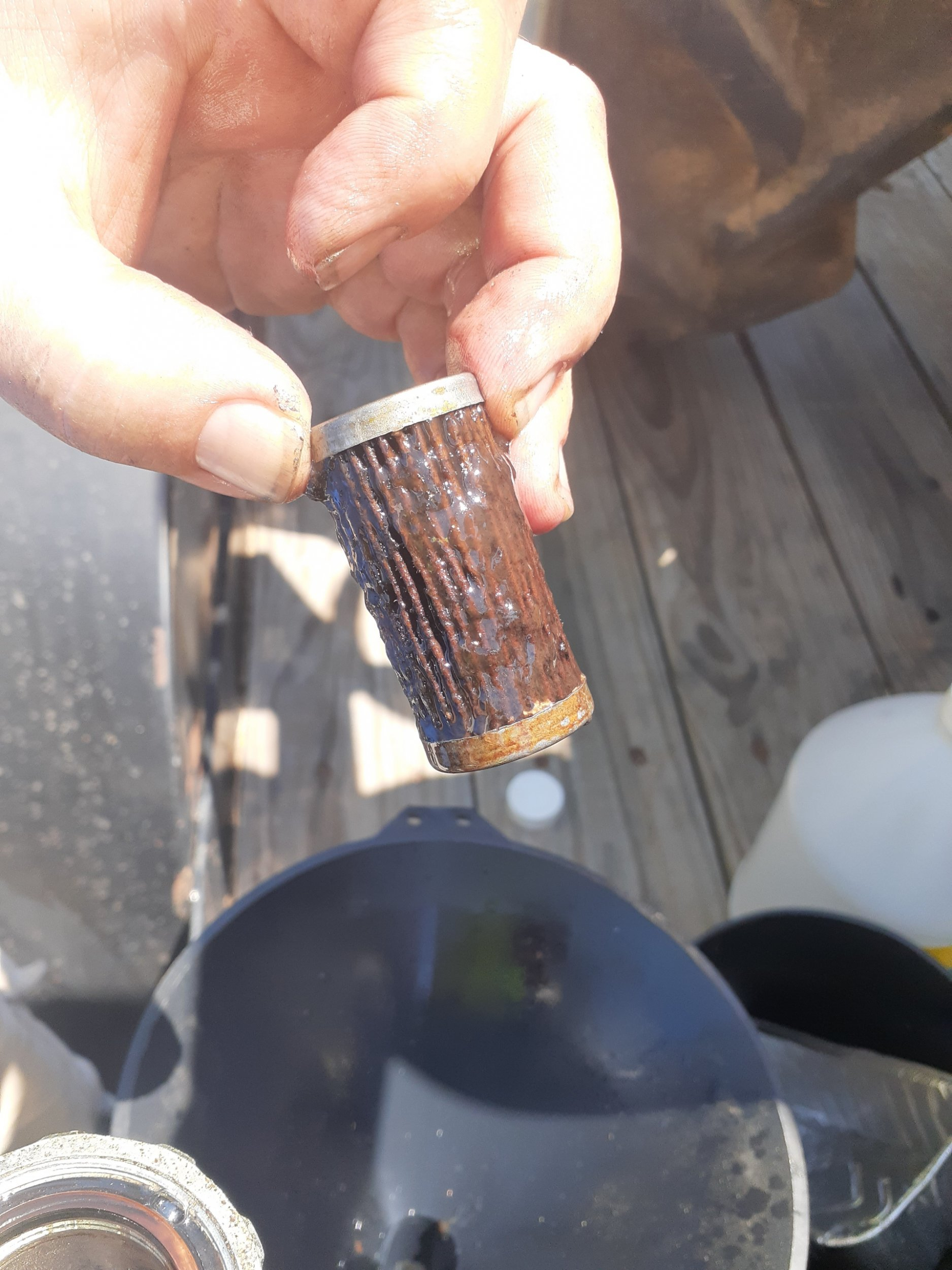

Throttle moves freely. I took the shutoff lever off the side and the part of the injector pump that looks like a barrel latch is completely frozen. So i'm thinking pull the injector pump out and soak it with the waterand gunk ive seen so far i'm betting the pump is either rusted or gummed up almost completely.
   / Mahindra 2810 run away
This is the fuel filter i pulled outof it

Lol.. so u know what the inside of the pump looks like..
Whatever you do, don’t hammer on the control rack..

Typical Bio Fuel after it sits..

Pulled the injector pump and soaked overnight. Got the shut off sliding freely, all good now. Starts right up and idles good no smoke!
