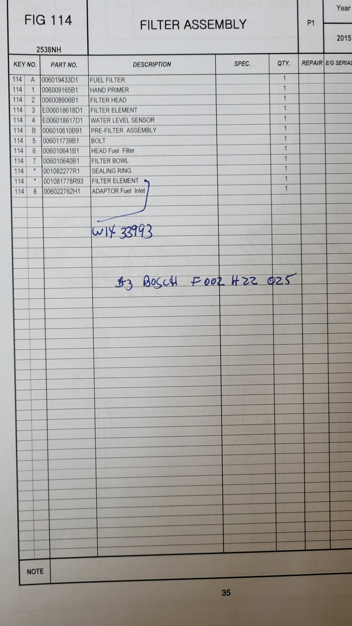

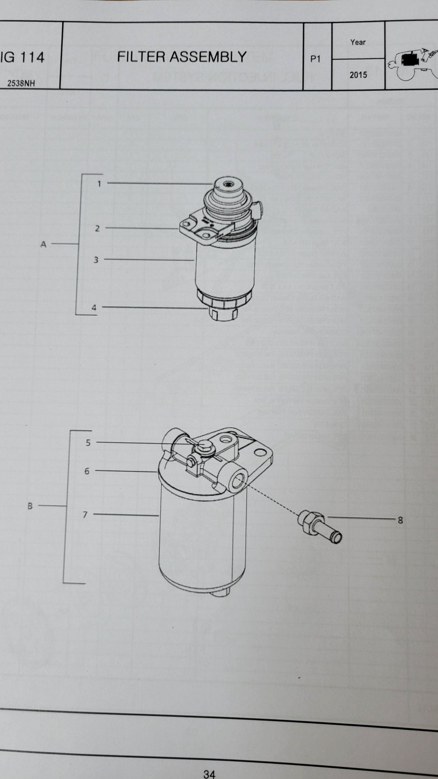

See the attached pics, may need to click on them for better resolution. The filter at the bottom is what is in your picture. The filter at the top is the one with the fuel sensor. After looking at Mahindra's part list you have the same Bosch filter on your tractor.

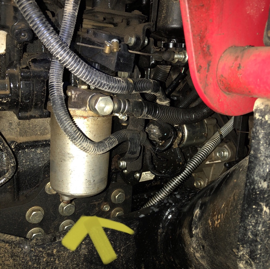

Thank you for responding bearthebruce. I used it two days for a couple of hours. Ran out early today before it got too hot and it wouldn’t crank. I drained both filters again and caught the fuel and there was zero water. All diesel.

Looks like silver cannister near engine block houses your fuel filter. After you drained it did you refill the cup or pump the plunger next to it to refill it?
Hello RustyA I did. I left the bottom lightly tightened and primed it, pure diesel when it ran out after letting it drain, so I knew it was fuel and I could finish tightening.

I think your 1533 and my 2538 have similar engines. So, on my tractor the silver can is the primary filter and on the other side of the engine is the secondary filter. The secondary has the water sensor at the bottom of the filter. You may want to see if you can remove the wiring connector from the sensor and then unscrew the water sensor to drain out the water. The extra line may be return to tank, the injectors intentionally bypass some fuel back to the tank for cooling of the injectors.

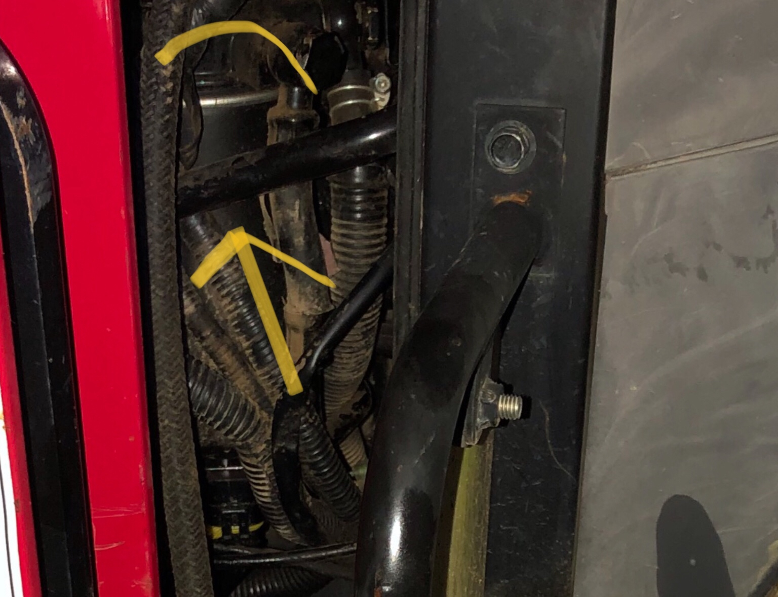

Hello mwayne. On mine there is a filter close to the firewall that sits up high and has the sensor then the other one sits closer to the front of the tractor on the left side. Both on left side. I knew the guy that drained the fuel out before when this happened stayed only on one side. I drained both of those. I think with this happening twice that it has the main filter all clogged up. There was a lot of junk in there. I have learned my lesson on buying fuel from that place. I have heard others saying the same thing. I may try to change the filters myself. Everything is tight in there but I think I can do it. I am going to give it a try. I may be back on here. lol Do you order online for parts and where may I ask? The dealer is high.

First picture is hard to see but that is the main filter, on left side close to firewall with sensor and plug. The 2nd pic is the lower filter that has a nut in the bottom, just remove but don’t lose the washer and let it drain. Both were clear diesel today. But no go. It wouldn’t crank. So filter time I guess. Thank all you gentleman so much. If you can think of anything I have missed please let me know. Have a good evening.

I'm now a dealership orphan so have been getting filters from billstractor. Also in post # 11 I wrote the Wix and Bosch part numbers, you can Google those numbers and see where else they are available. Good luck!
That is it. Thank you!
