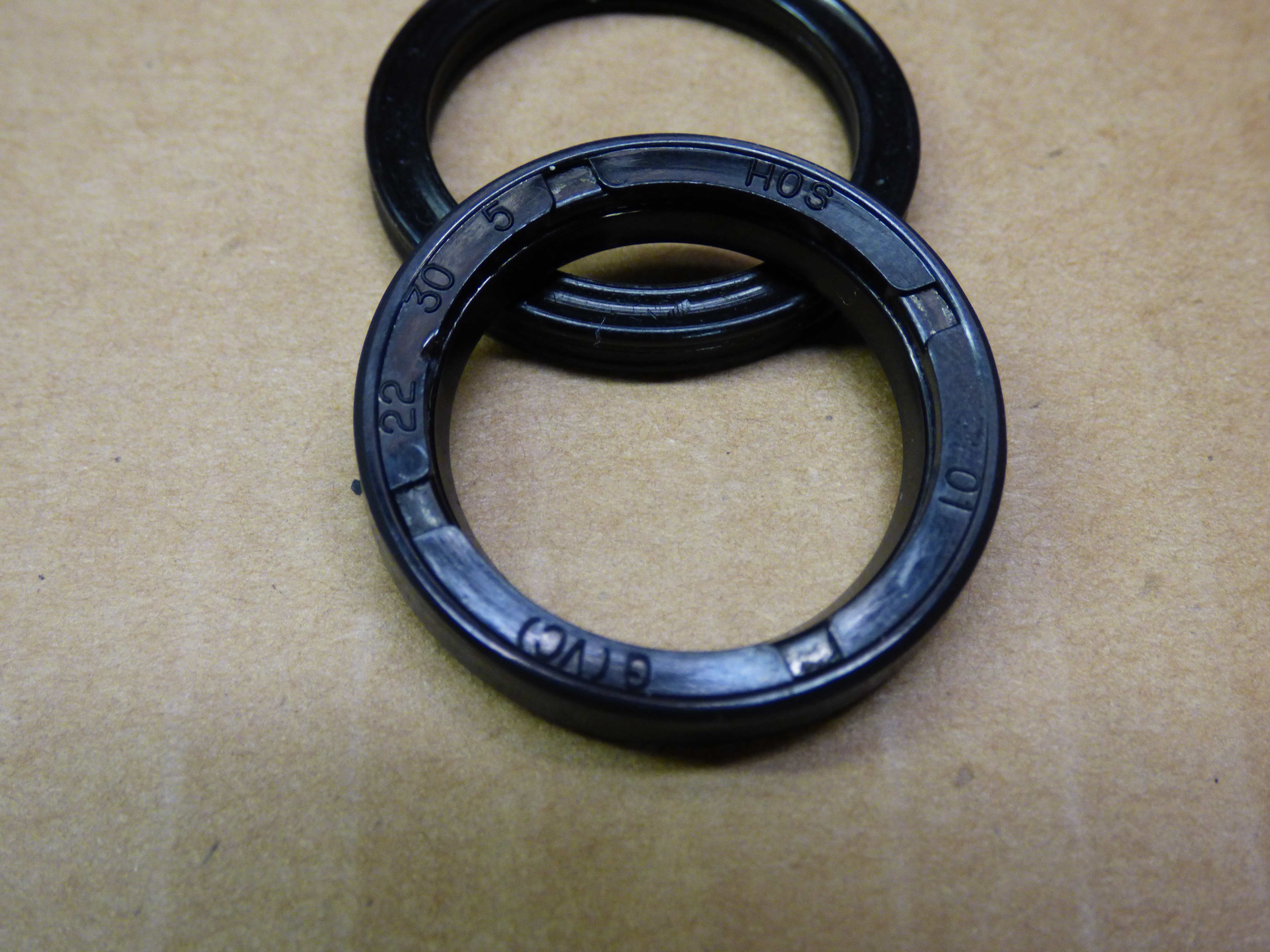

Take these two seals and go to a "good" bearing/hydraulic shop and match 'em up. They may or may not have the inner seal on hand as this is a "soft" seal (don't remember the technical name) but it can be gotten. Buy a few as you'll be doing this repair probably every 300 - 500 hrs. or plan on replacement of the HSU on roughly the same time frame
If anyone else ends up going this route can you post the manufacturer and part number of the replacement seals? This would be very helpful to others. I agree it seems totally foolish to have to buy a whole new valve to replace $15 worth of seals.

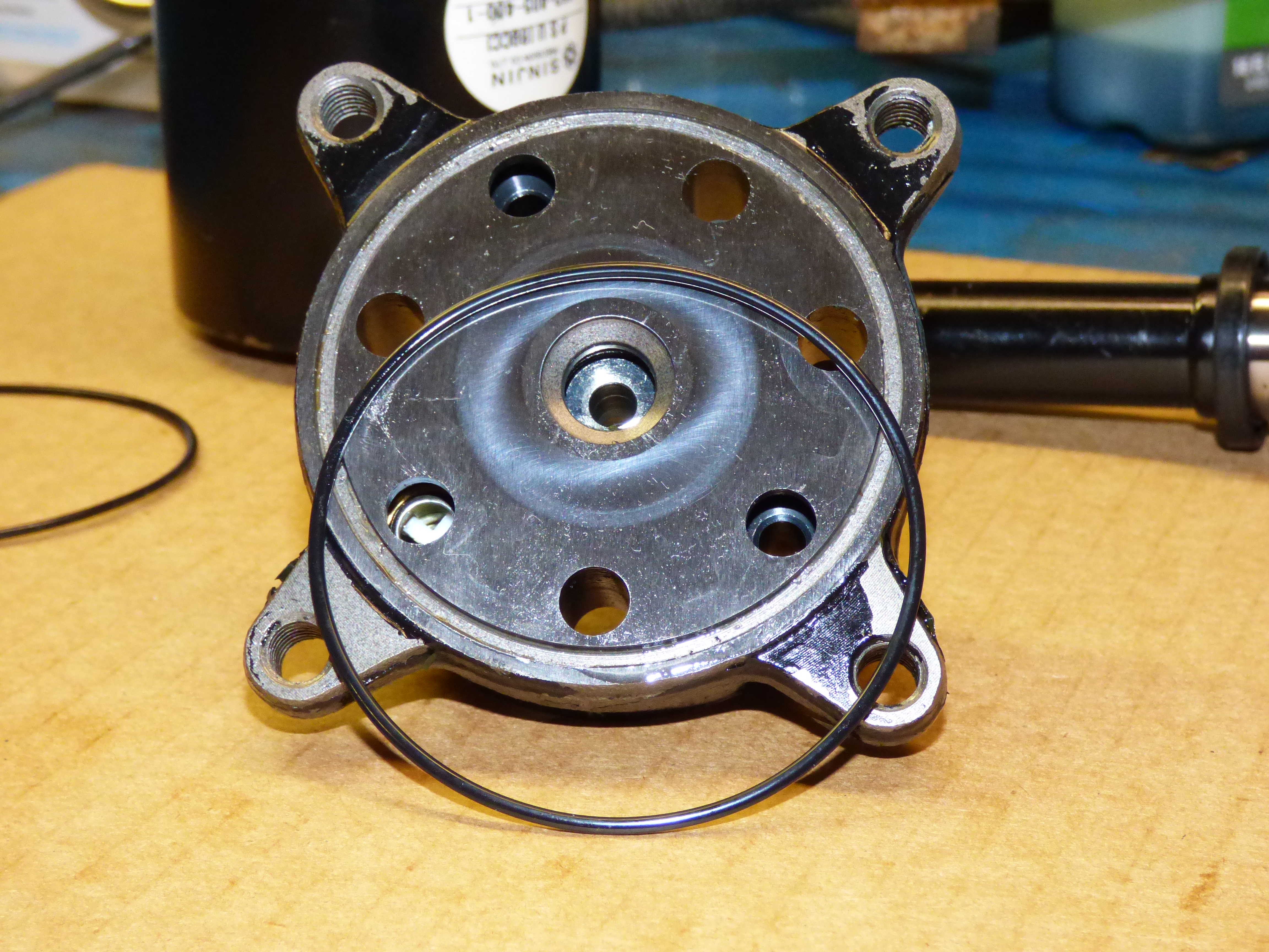

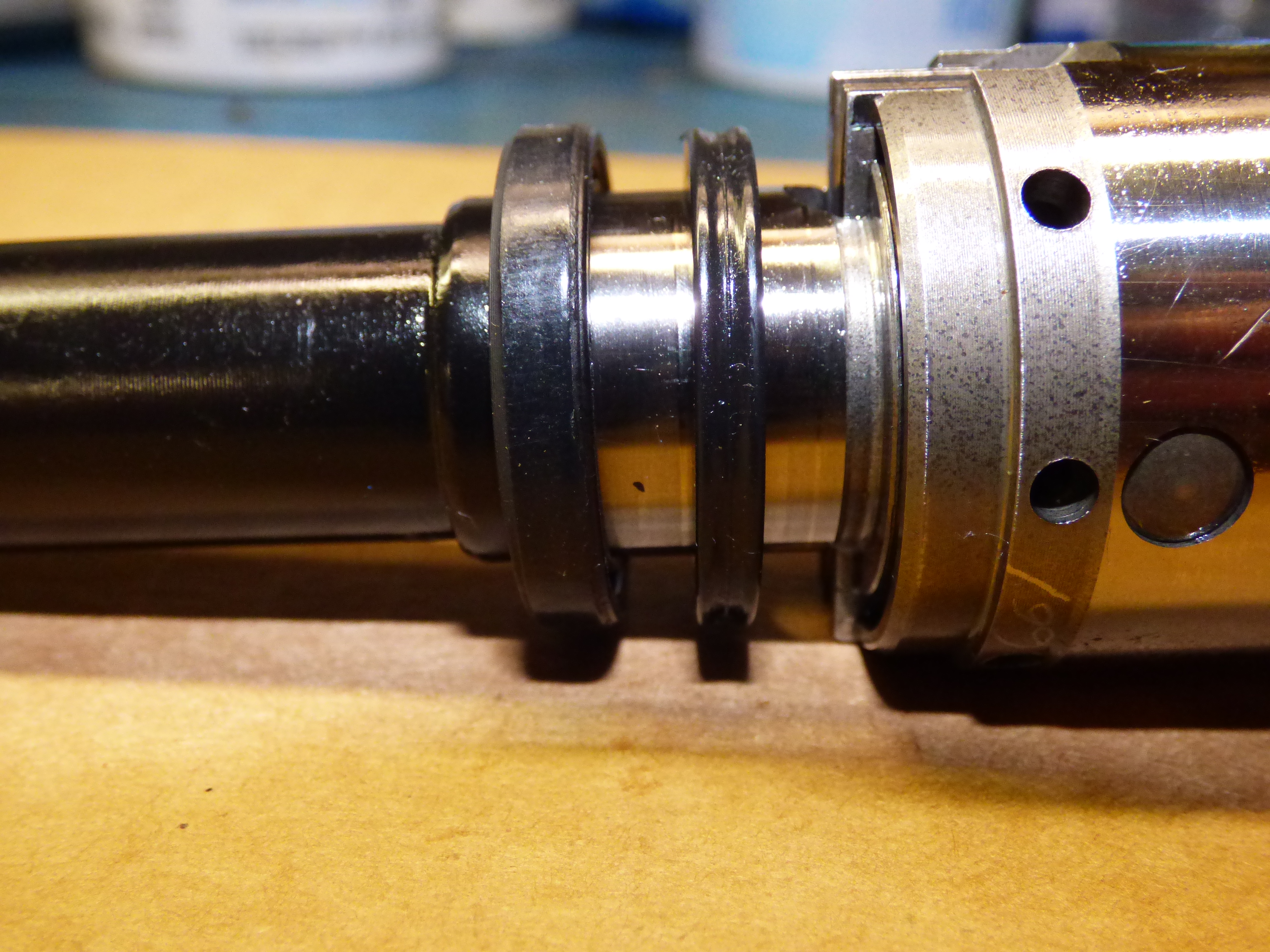

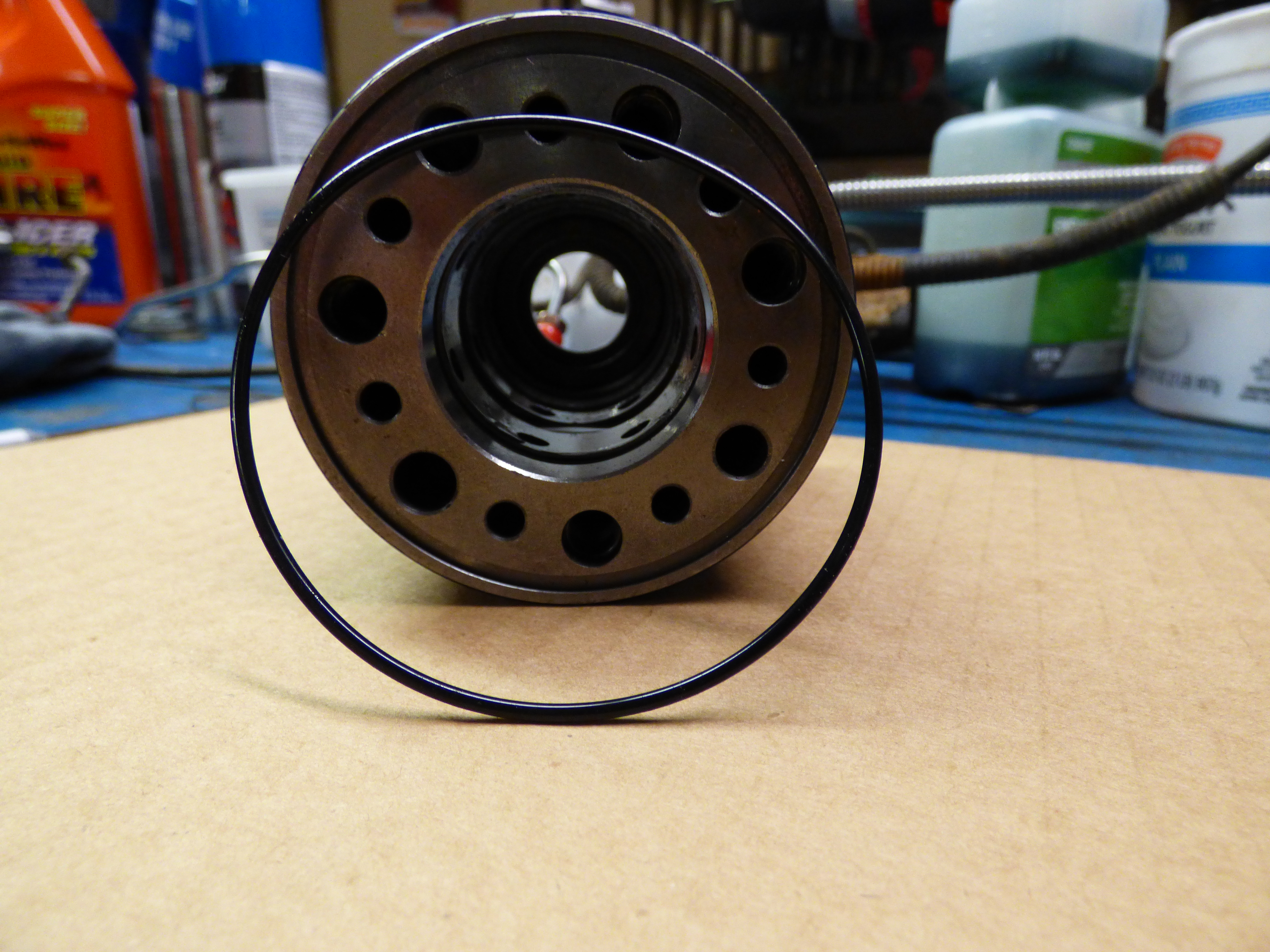

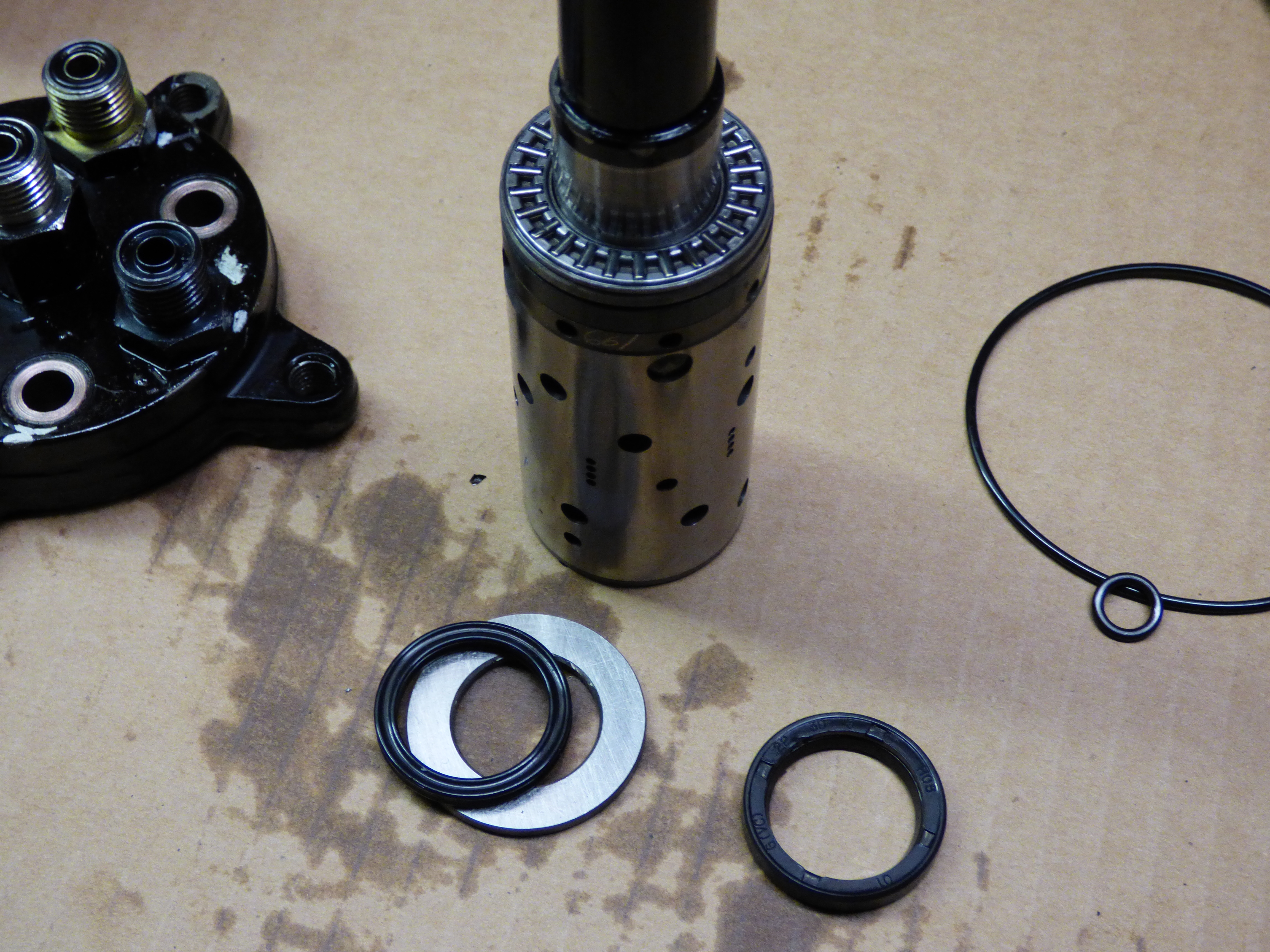

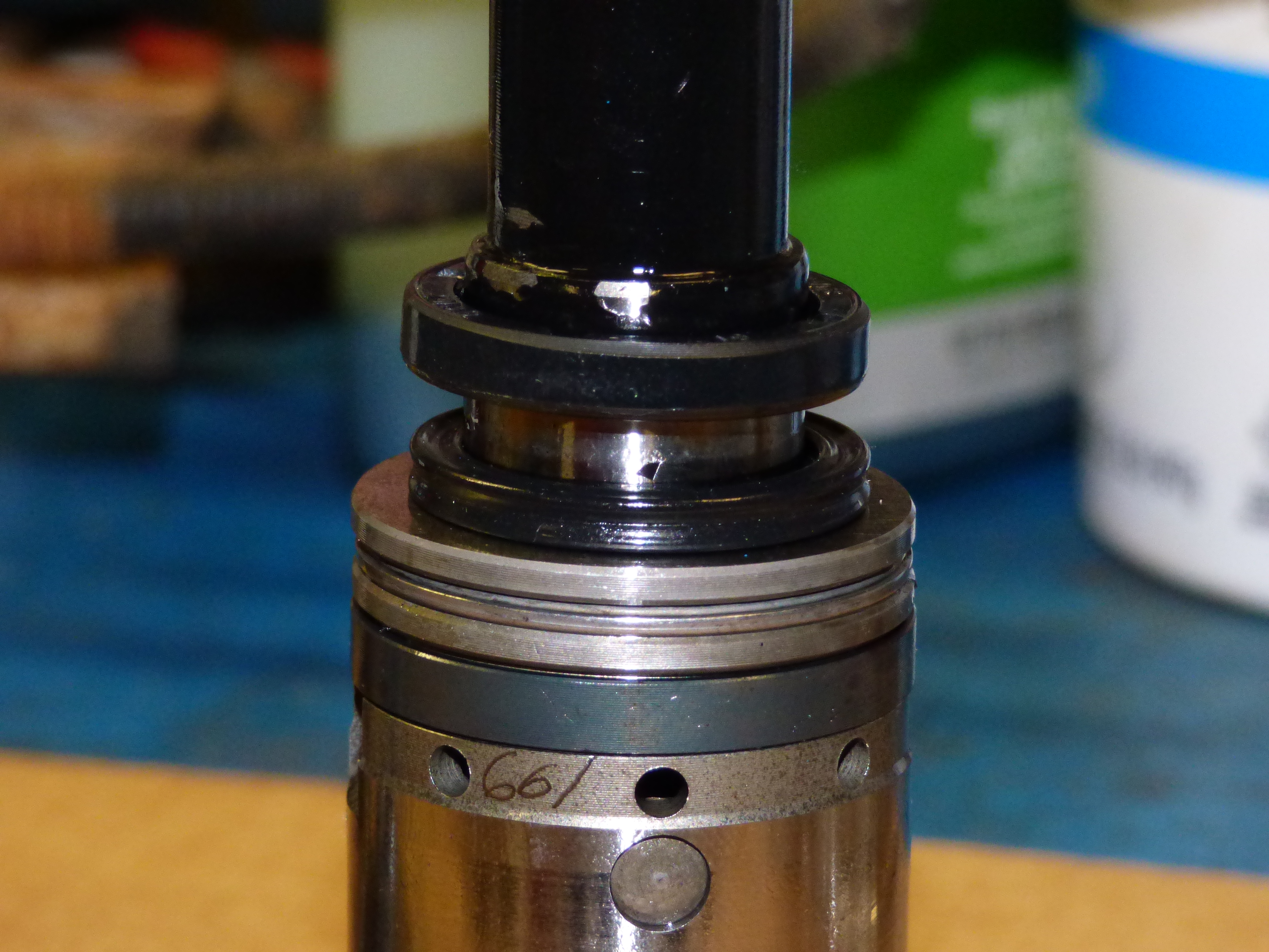

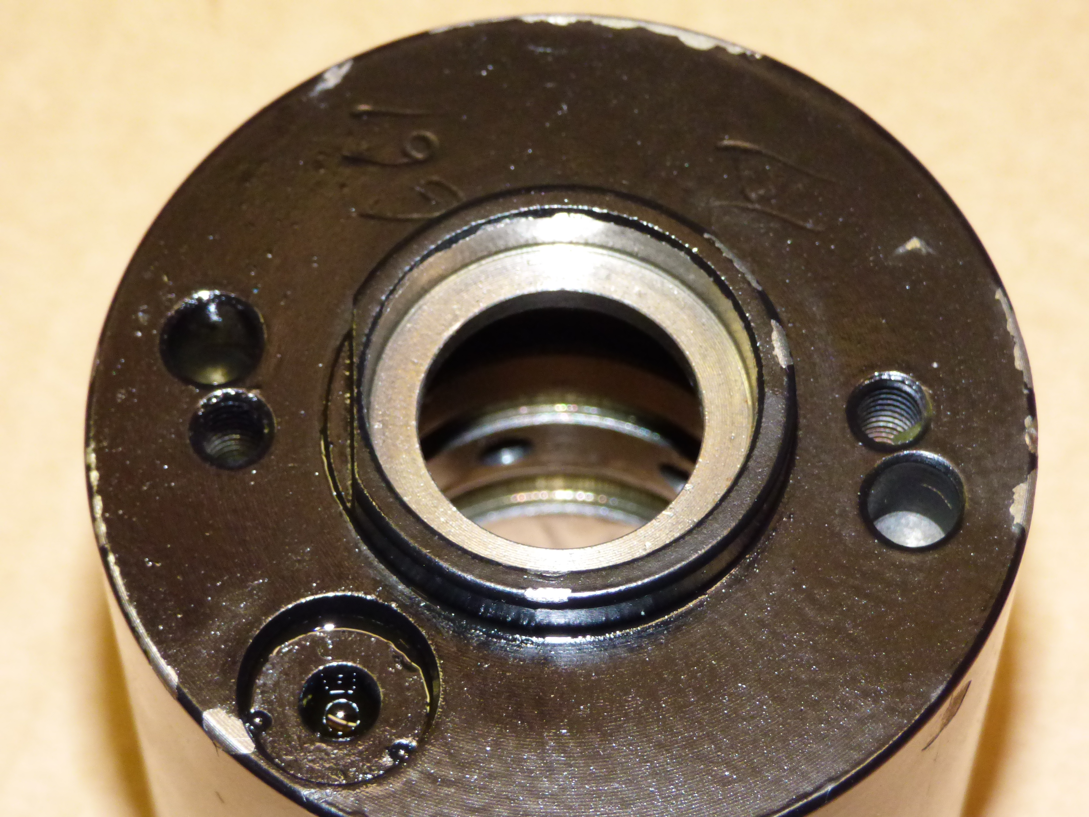

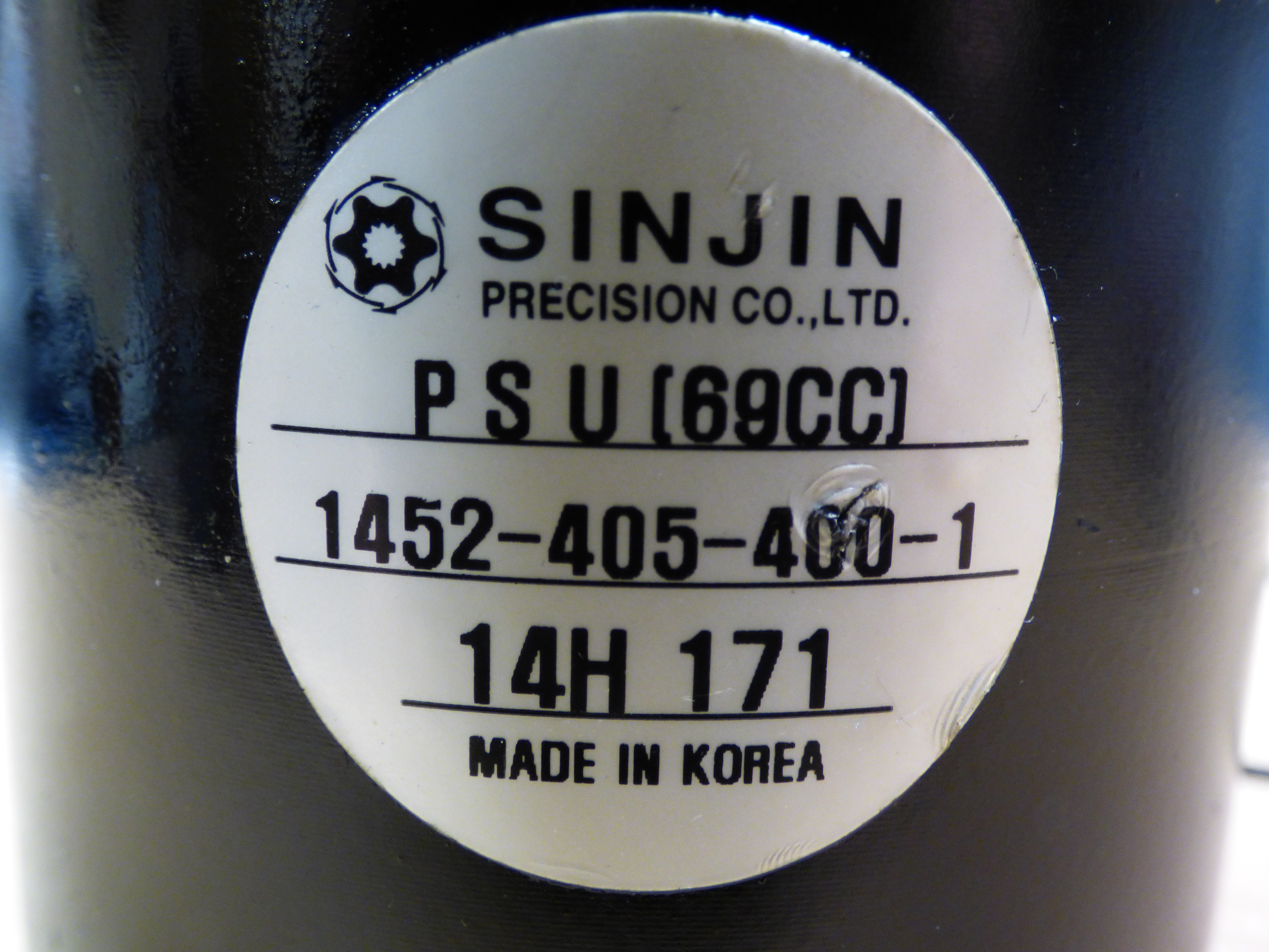

I have the Sinjin PS unit apart. The case and covers are hard metal. Difficult to mark with a punch or awl. The unit only has two seals the are sealing the SW shaft. One is a quad ring or some call it an X-ring. The other is a dust seal. This seal has part numbers. I have both of them out and took as many measurements as I could. I will take good, detailed pictures of everything and post them. I was always told, a quad ring should not be used as a pressure seal, but that is what Sinjin used. The original quad ring has expanded or grown. It doesn't fit tight on the steering shaft. It also is thinner than the depth of the groove it fits into, which doesn't make sense. Who knows what the quad ring material is. There are other O-rings I'll replace as long as the unit is apart. These O-rings weren't leaking, but they seem hard. They are on the case and the hose fittings. I'll send everything off to that seal company I spoke with.
I took several measurements for the PS unit. The shaft measures .865" at the sealing surface. The cut out in the inner part of the main housing, where the quad ring fits into, measures 1.127" across and a depth of .149". The dust seal fit measures 1.177" across. I didn't measure the dust seal since it has size numbers. It did fit well. The quad ring measures .137" in height and from .125" to .135" thickness. The quad ring shows some wear on the shaft seal area and it has grown/expanded or it was too large to begin with. It does not fit the shaft, it's loose and it will not fit into the cut out inside the main housing, the seal is too large. There are three O-rings, all the same size, used in the housing, measuring .072" thickness, crushed. The grooves for theses O-rings measure 2.739" outer diameter and 2.555" inner diameter. These grooves where difficult to measure. There are four O-rings, all the same size, that fit into the hose fittings that are on the end cap that measure .065" thick, crushed. The grooves these O-rings fit into measures .430" outer diameter and .250" inner diameter. Also difficult to get an accurate reading. The only leak on the PS unit was at the shaft seal.

I just wanted to update everyone on the PSU seal leak. It looks like several other people have the same issue. I wanted a seal company to look at this and see if they had a better seal to install, other than a quad ring. They all agreed a quad ring was not their choice for the inner seal, but because of the built dimensions, they couldn't replace the quad ring with anything but the same, without getting into major changes. That would have cost me more than I wanted to spend and there was no guarantee the leak issue wouldn't return. The design flaw with the SINJIN PSU is, it doesn't have a steering shaft bearing for side load for side to side stability. The PSU has a roller thrust bearing, but that doesn't help side load. The seal engineers said this is a problem. SINJIN uses the quad ring as a stabilizer or bearing, to keep the steering shaft centered. Operating the steering causes side load on the quad ring, which causes wear. Just a poor design. Unless SINJIN redesigns this PSU, we are stuck with it and it's issues.
I ordered a new Viton #212 quad ring, an outer seal 22x30x5, three new Viton #038 O-rings and four new Viton #011 O-rings from The O-ring Store.com. The total cost was $26.52. I'll clean and reassemble, once the parts are here. Hopefully, I can repost good news with no leaks.
   / Mahidra 2555 HST power steering control valve leak. #19

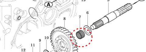

........ The design flaw with the SINJIN PSU is, it doesn't have a steering shaft bearing for side load for side to side stability. The PSU has a roller thrust bearing, but that doesn't help side load. The seal engineers said this is a problem. SINJIN uses the quad ring as a stabilizer or bearing, to keep the steering shaft centered. Operating the steering causes side load on the quad ring, which causes wear. Just a poor design. Unless SINJIN redesigns this PSU, we are stuck with it and it's issues.
With that being said, you'd think them "rocket engineers" would just use a needle bearing, like the one pictured, on the shaft (this one is used on the PTO out-put shaft). But on the other hand, it's good to see you're still pursuing the "better mouse trap". Once you get it done and it fixes the issue, you may be able start your own little side business of repairing these and all the members who have the problem could just ship them to you for repair. Just don't let Mahindra or SINJIN catch wind of it or you could end up being sued for depriving them of profits!

Thanks DirtHauler. I gave up on the seal redesign issue. It is what it is. I ordered new seals, but in Viton. I hope they last longer and don't leak. The PSU has a roller thrust bearing, but it only works for the end play of the spool. The spool is only held in place, centered, by the quad ring and the spool fit in the housing, which has clearance of several thousands. If there was a bearing, or even a bronze bushing for the steering shaft, I believe the side thrust, which comes from operating the tractor, would be almost eliminated. That would save the quad ring. The picture I sent, shows the roller thrust bearing.
