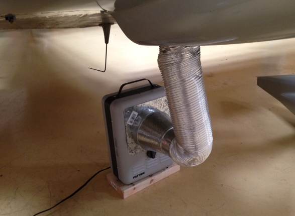

Here's a picture of a home made one....
The caption says $20 for the heater, $16 for the parts. Gets the oil temp to 100 with a blanket over the engine and the cowlings stuffed with towels. Takes an hour to raise the temp he said.

That looks nice and warm. You should just take your poor little PT indoors with you.:(
I had one of those heaters in my well house for several years. I got it for a dollar at a recycle store . The fan froze up this year and the top of the heater got a little warm, like scorched paint warm, but a good whack started the fan back up. I really need to put in the infra red emitters and get rid of the fan.
