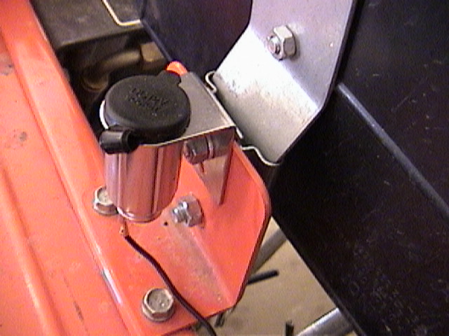

Hi Mutt,
<font color=blue>...Bob
I can't say if it's crazy or not, but I installed a cigarette lighter socket at the SMV bracket for the amber rotary light. It casts a lot of light on some of the hilly roads I end up on after dark.</font color=blue>
I don't suppose you have a picture of this socket you installed? I gather it's behind the SMV and hooked to the seat? That might be where I end up installing a couple also. Have to do some more looking. Did you run a special circuit, or just splice into the gray wire?
Thanks,
Bob
   / Magnetic lights? #36
Bob
I have a pic now. There was a extra wire at the rear that is hot when the key is on. All I had to do was add the connector. Did not want to put any holes in it (tractor) so I found a convenient location with enough screw length to hold the bracket on.
regards
Mutt

Mutt,
Very cool!!!
Now I have to go out and look some more.. /w3tcompact/icons/smile.gif I'm sure I'll find the right spot eventually. In your second picture, operating, the light at the top is your new addition? It's hard to tell from a stationary picture if this is a flashing light or if it's a front flood.. I would guess the latter?
Anyway, thanks! I'm almost there. I have the lights, the magnets hang on to the ROPS like their life depends on it (which to an extent is true /w3tcompact/icons/smile.gif), and all I need is to find the right place to mount these sockets. Yours looks great!
Thanks again!!
Bob
