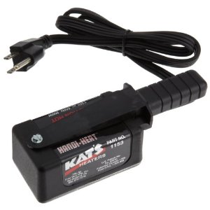

A magnetic block heater simply sticks to the block via magnets and hopefully transmits the heat to the block thru the magnets. A real block heater is a permanent attachment
heres a pic of a magnetic heater

I've got quite a few of the magnetic heaters as well. They're take-offs from returned rental equipment. They're *better than nothing*, but just barely. In addition to the already-mentioned poor transfer of the heat they produce, there's something else to consider: watts.
While *real* block heaters that go into a frost plug hole are typically rated at anywhere from 400-1000 watts, (even more for large diesels), typical stick-on magnetic heaters are around 150-300 watts. So you're not only transferring the heat far less efficiently, but you also have less of it to transfer.
You could stick on two or three magnetic heaters, and then add a wrap-around blanket heater for your battery, plug them all in simultaneously....and end up with something comparable to the results you'll get with a *real* block heater.
