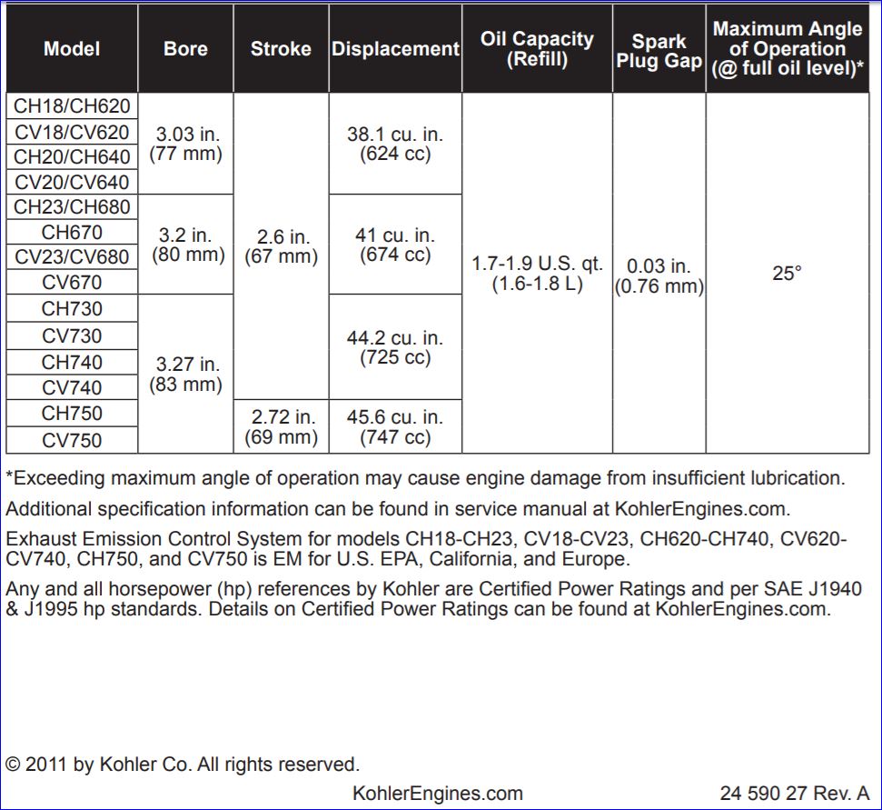

Hi, I have been looking at the Struck hydro crawlers for a job on slopes, at different times they have used Kohler Command pro, B&S Vanguard, & now Honda GX 680.

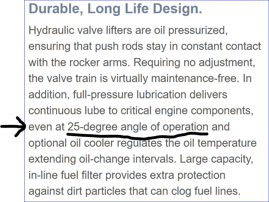

I have checked the max angles the engines can work at, B&S 15 deg constant, up to 30 deg intermittent (however B&S will not define intermittent.) Honda GX 680, 20 degrees, Kohler 25 degrees.
I cannot find from where I am if the Kohler max angle is a constant rating, specs do not say, there is a toll free phone no - but this is not practical from overseas. I cannot email them as their site does not recognise my phone no or postal code.
On the face of it the Kohler seems the best engine for slopes, & all the owners using them on steep grades seem to have the Kohler powered MH 5000 anyway.

Don't know the specific model number that Struck uses, but saw several references to 25 degrees, like you mentioned.
http://www.kohlerengines.com.cn/onlinecatalog/pdf/24_590_27.pdf
Kohler Engines: CH26: Command PRO: Product Detail: Engines

Thanks Xfaxman,
This is pretty much the info I have seen, wish I could find out if the 25 deg is short term only or continuous. I was thinking of asking Struck if there could be a suitable Kohler option on the 4900, Otherwise the 5000 & 4800 models used Kohler 25 Hp.
