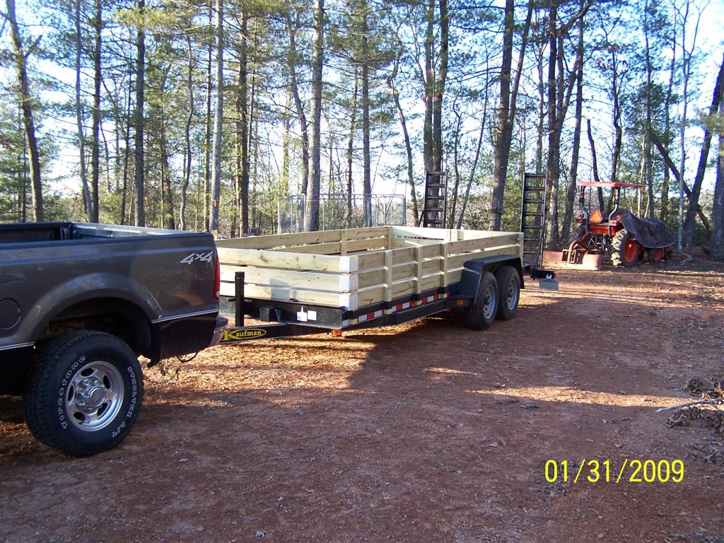

I finally got around to making the side rails for my trailer. I used treated wood and bolted it together.

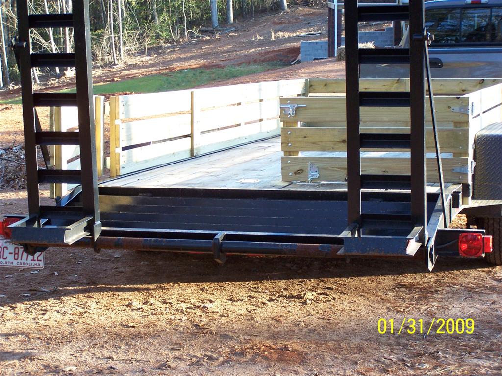

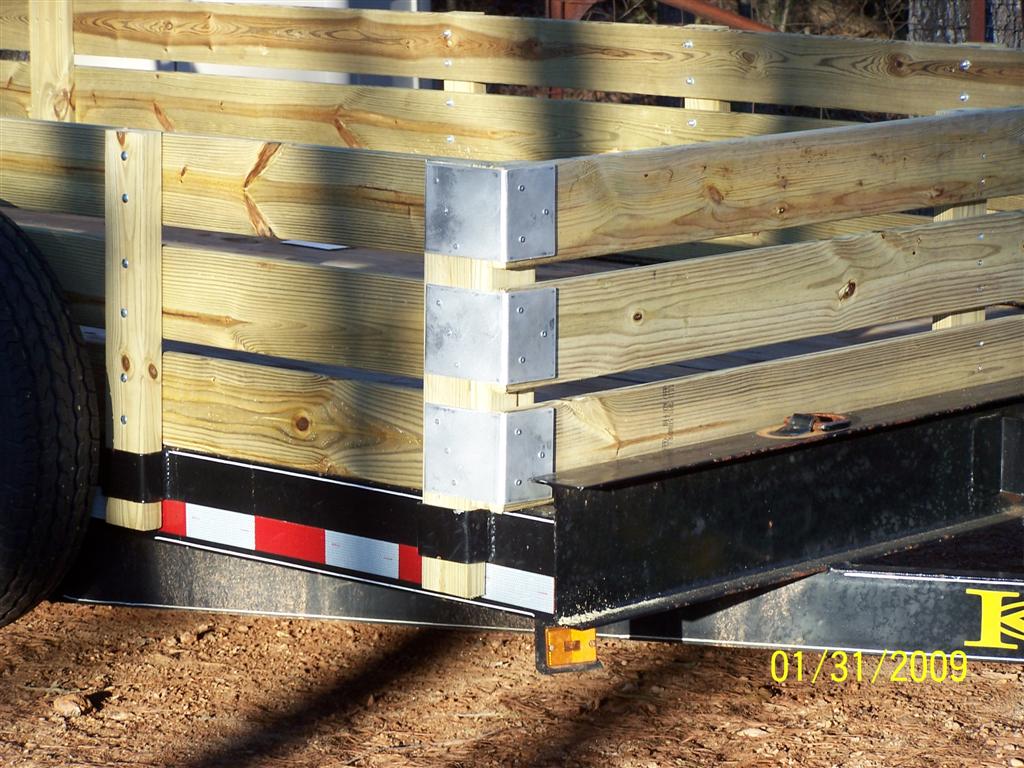

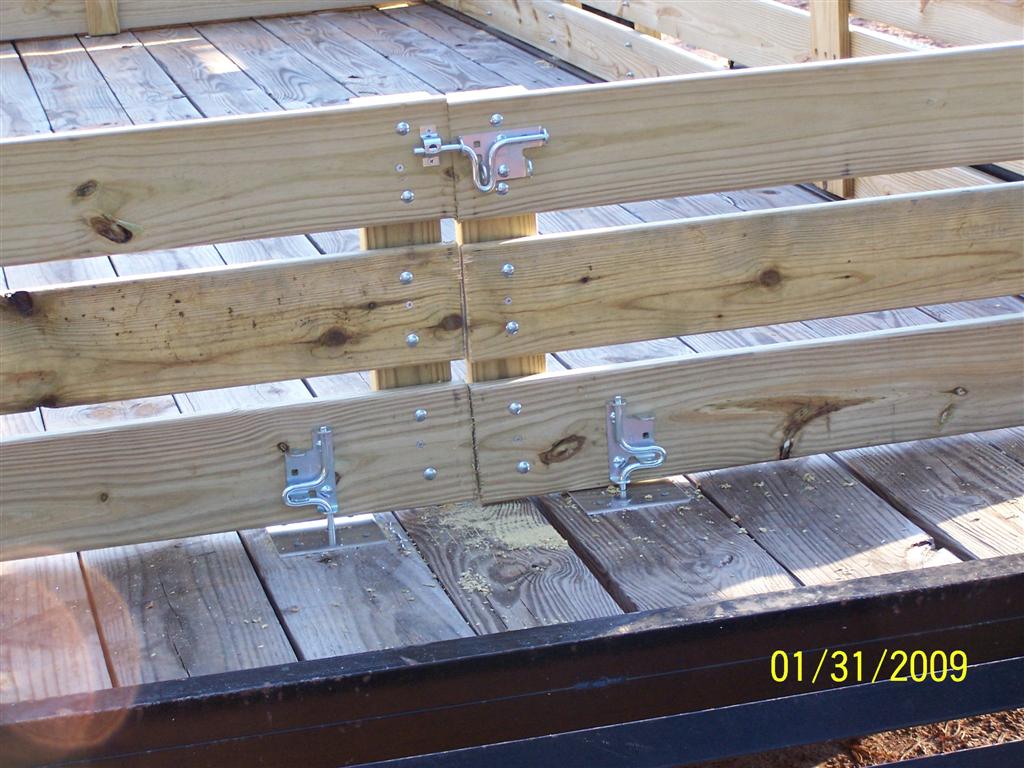

I made corner brackets out of metal at work to hold the front on. I made it with a two piece rear gate. I did not go the full length of the trailer so I could open the rear gate without droping the ramps.

Looks good.
I've often thought about doing something like that with mine.
Are your corners quick connect or screws/bolts ?

Nice looking trailer and truck. I really like the brackets you made.

Brackets are screwed in. I ran out of bolts. I was looking for some heavy hinges with removeable pins but could not find any and did not want to drill the pins out. I can remove the screws on one side of the brackets and lift the sides off.

I picked up some corner brackets from Northern Tools. They had the straights too. They had them in stock back in the trailer section. They work great if you're making the sides removeable.

Thats one of the reasons I made these. I need to haul some straw to seed the yard. I was unable to get any grass started last year due to the drought.
I also have a lot of things I need to haul that would be hard to strap down but will travel great with the side rails.

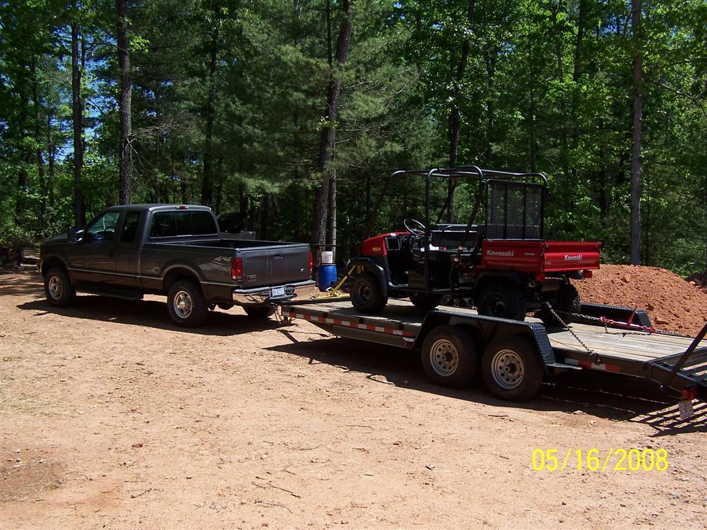

2002 F250 Powerstroke, 50,000 miles.
I could of made the rails a little nicer but was pressed for time. I have some granite I need to haul from the other farm. They are a good size for a stacked wall I plan to do infront of the house. I should be able to haul one or two layers with the siderails on. Plus I have some creosote beams and old odd and end things from the old farm house we plan to use.
