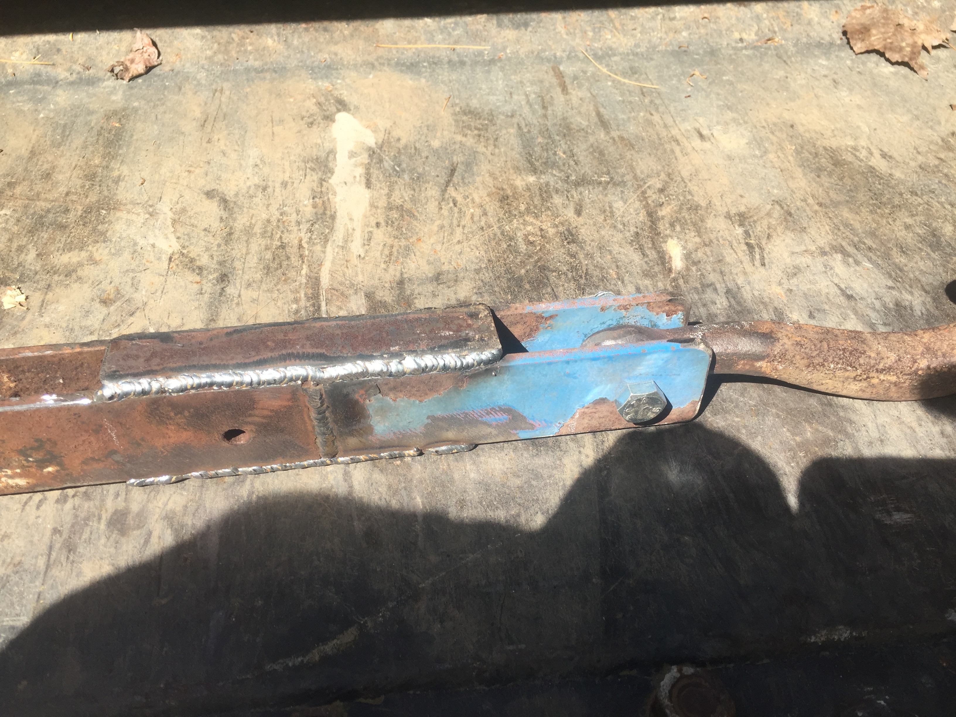

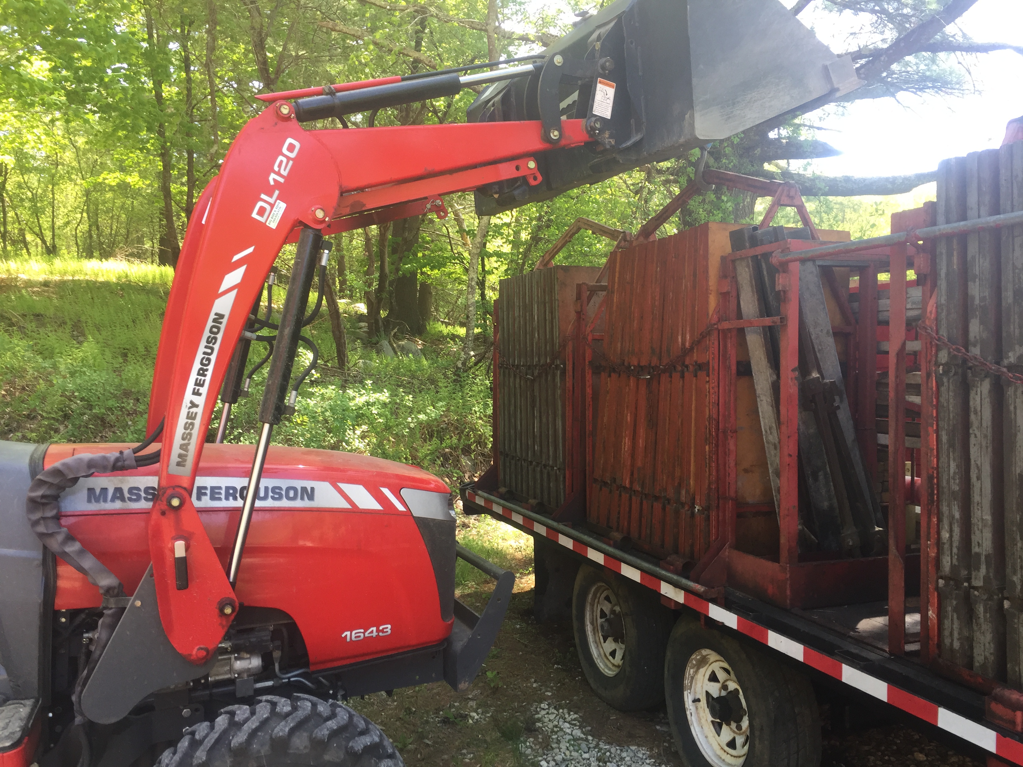

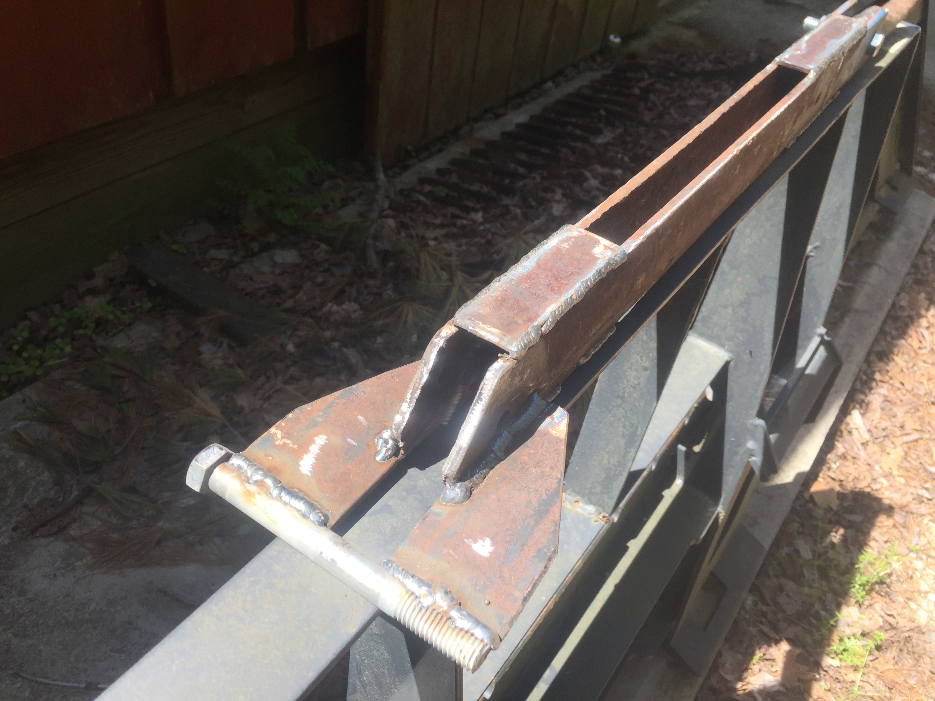

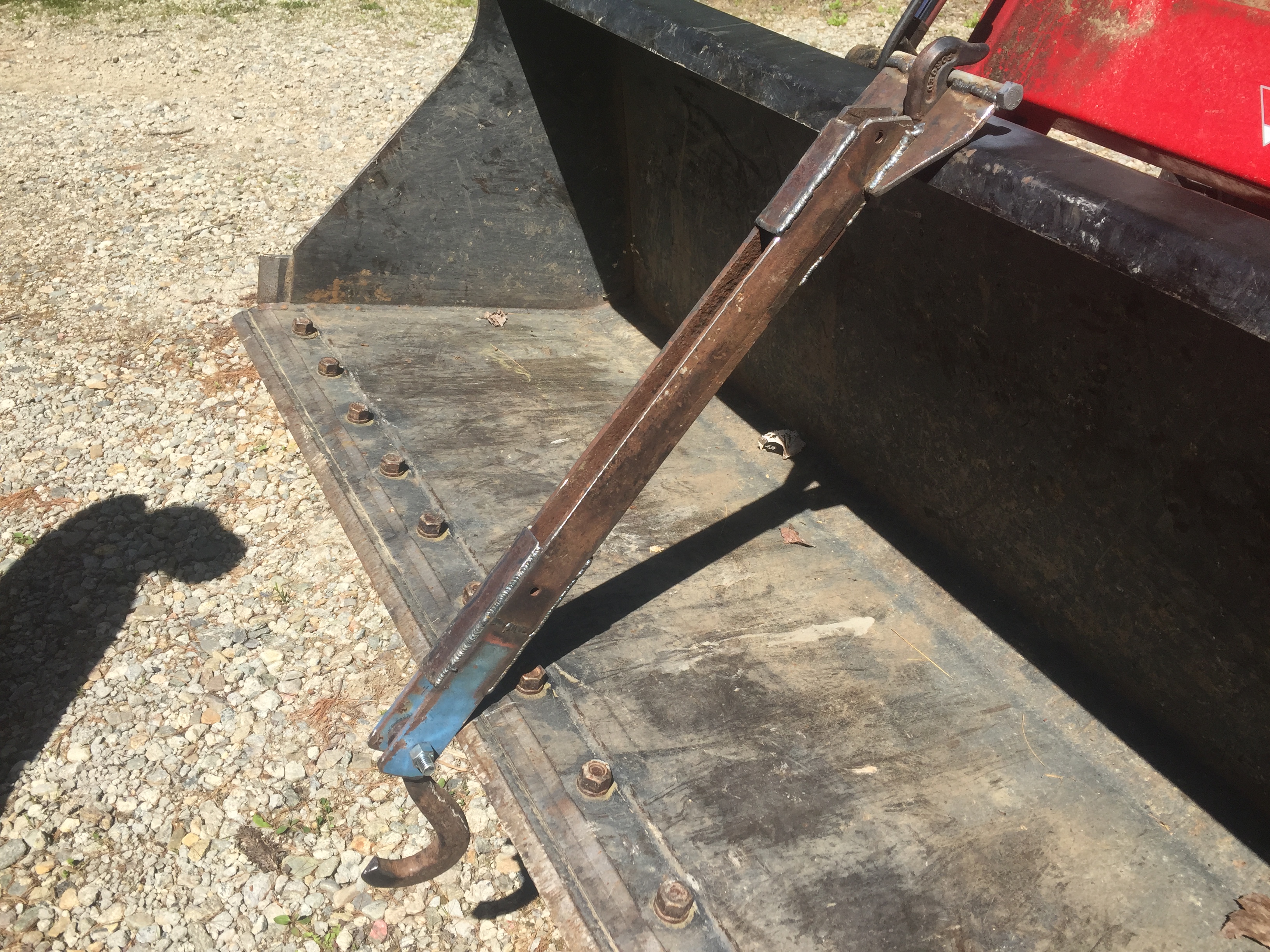

We've used our 2001 CAT 262 skid steer to lift and load/unload cages of concrete forms for years now. Wanting to ease up on the hours on that machine, my dad and I made an attachment to use the MF 1643 to load and unload our lighter cages that hold 4' panels. These particular cages weigh about 1,000lbs. The attachment is simple to use: just slide it over the welded hook on top of the bucket and let it rest on the cutting edge.
