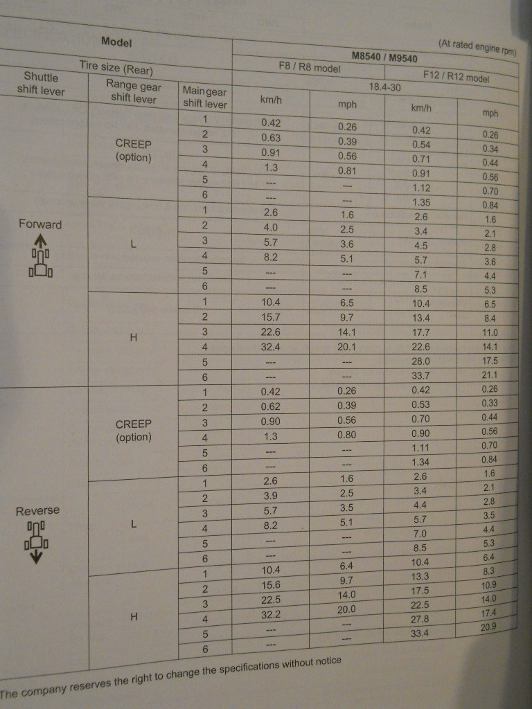

How about take a picture with your camera of the speed chart. does it say how wide it would be 16.9 34s thanks for all your help guys

I will give this a shot, if it doesn't work, PM me and maybe it will work better as an email attachment.

Thanks for doing that, it is perfect just what i wanted to see. thanks for it is much appreciated. I think this is the best fourm on the web :thumbsup:

TripleR/dieselbill, I rotated the orientation to make it a little easier to read. Was straining my neck to see that last column. :laughing:
