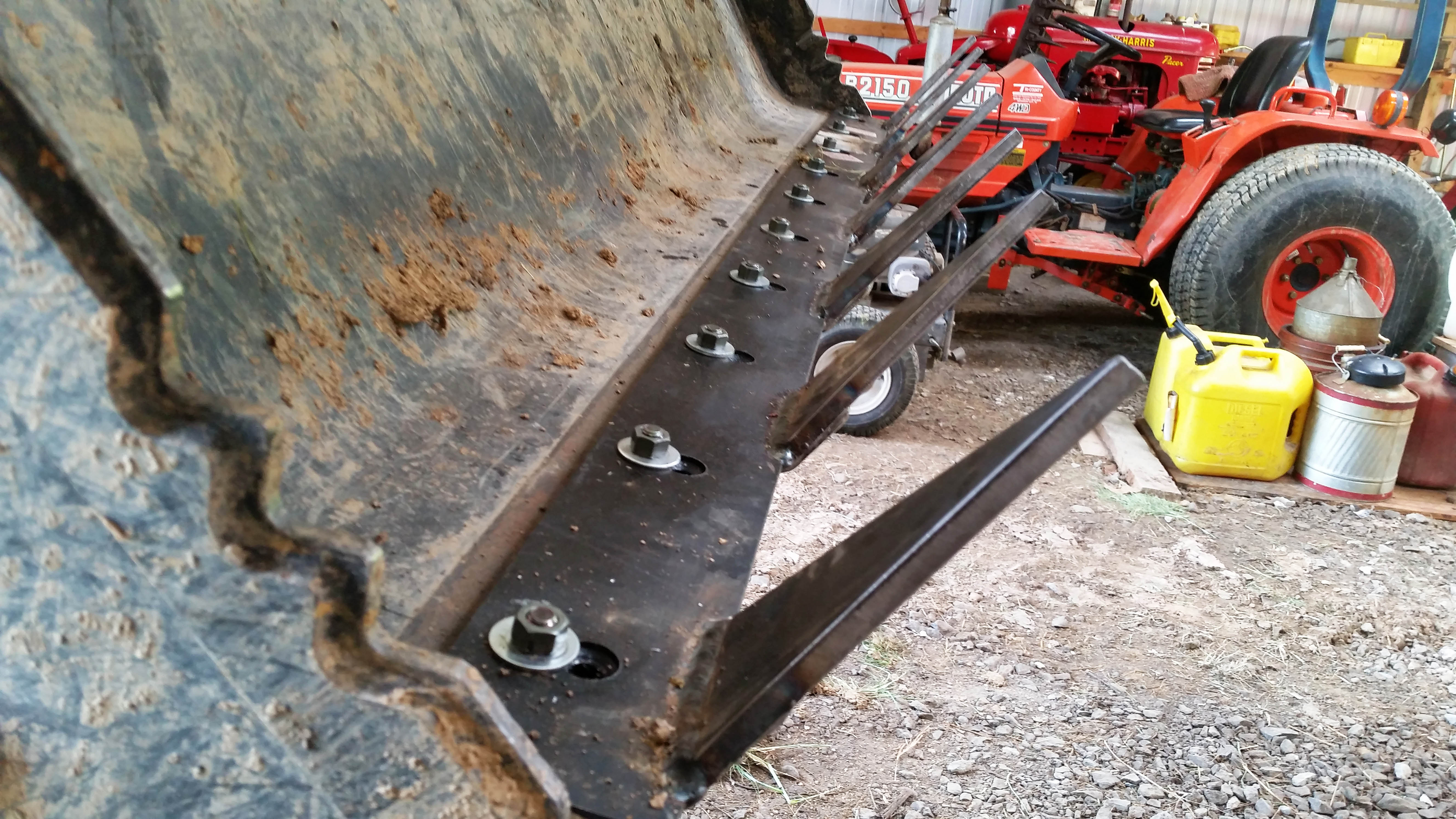

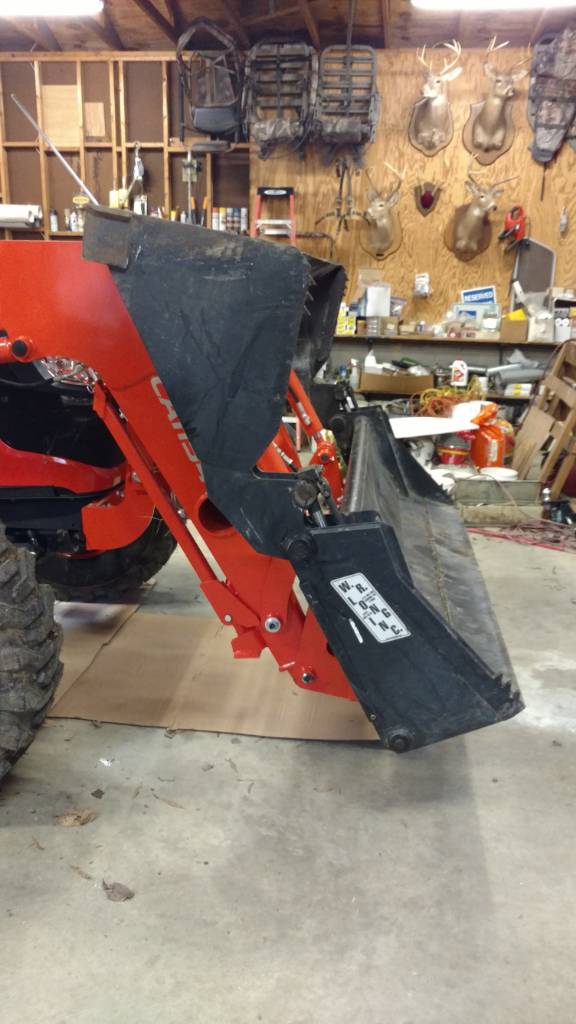

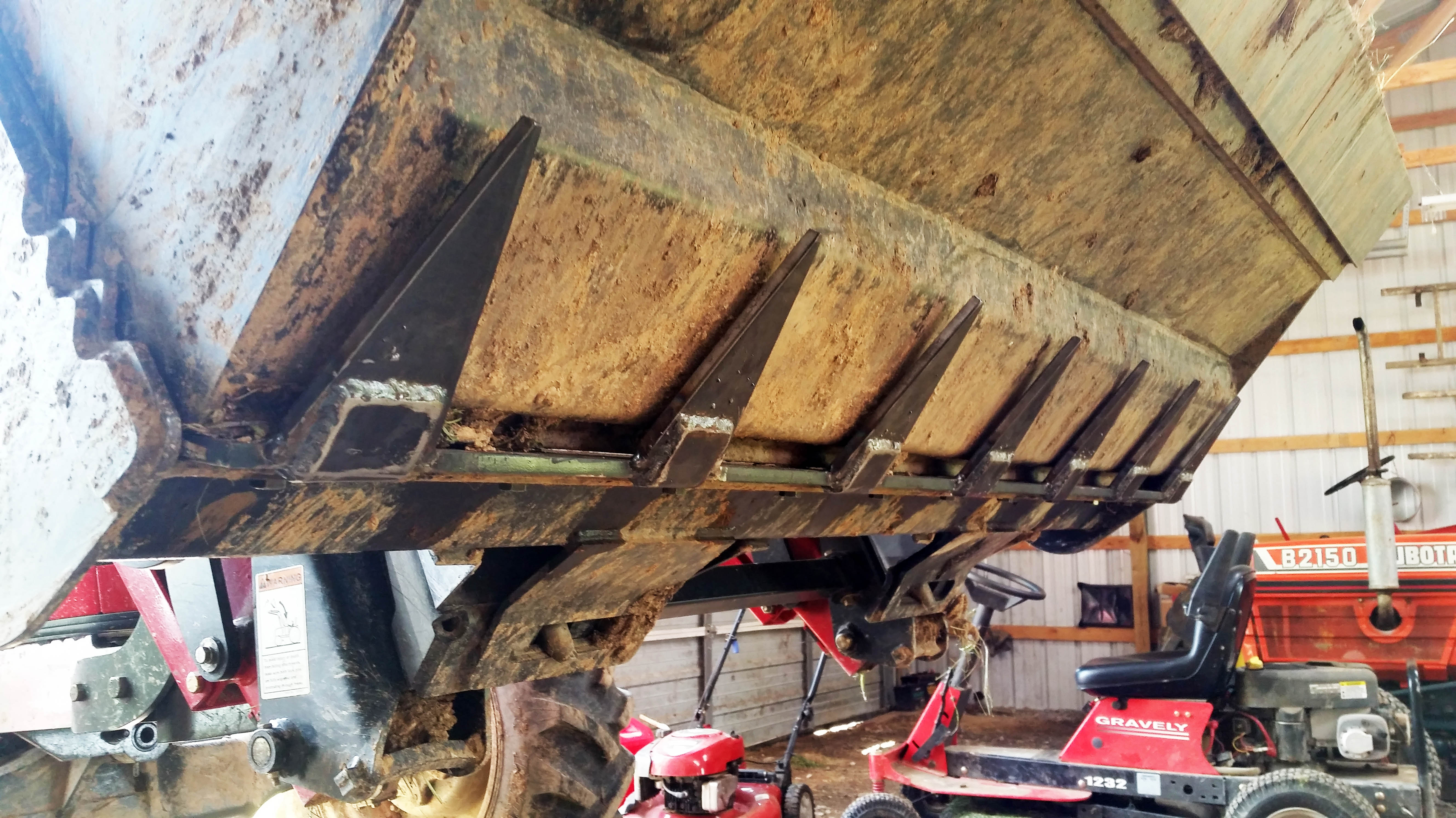

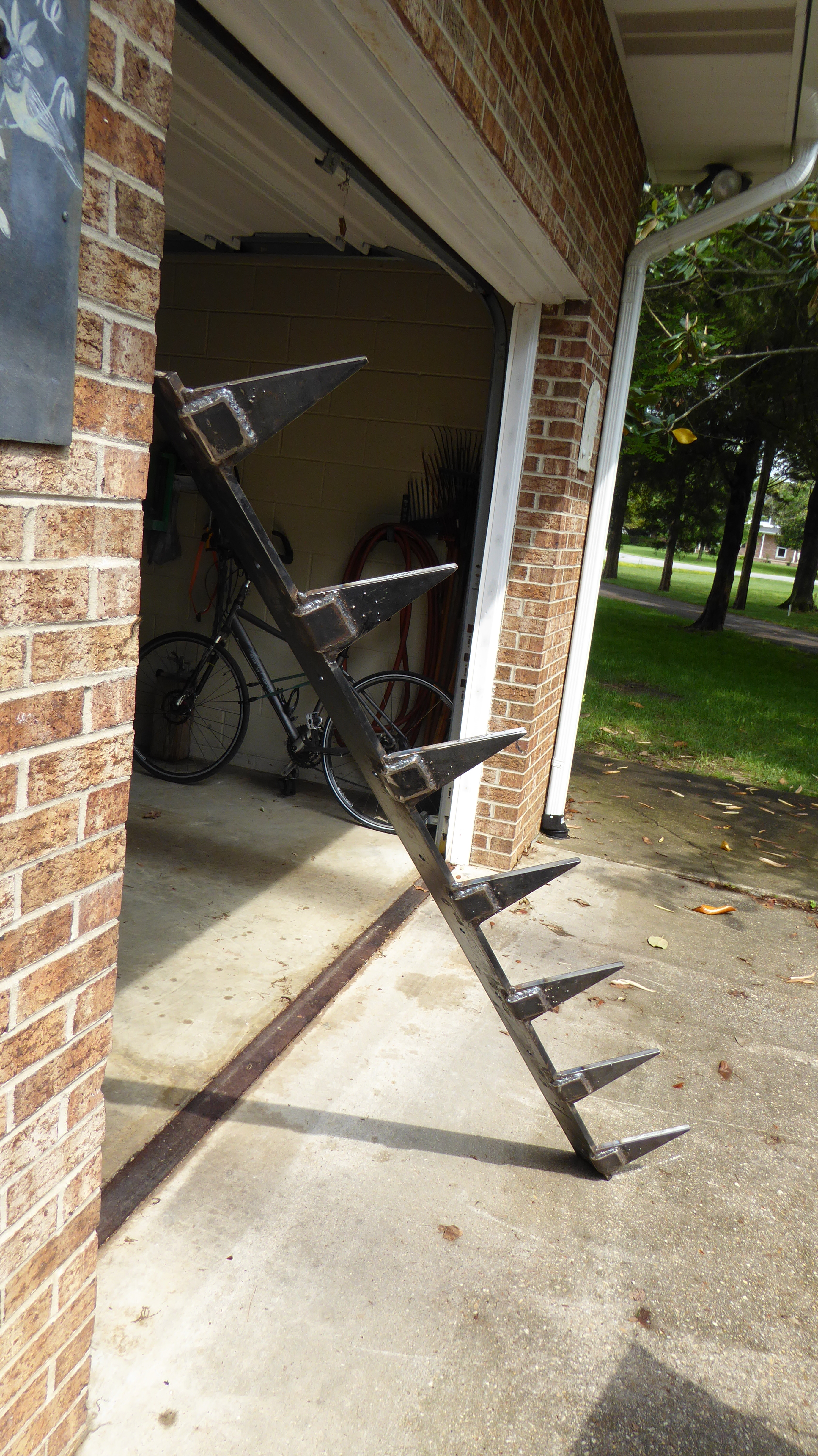

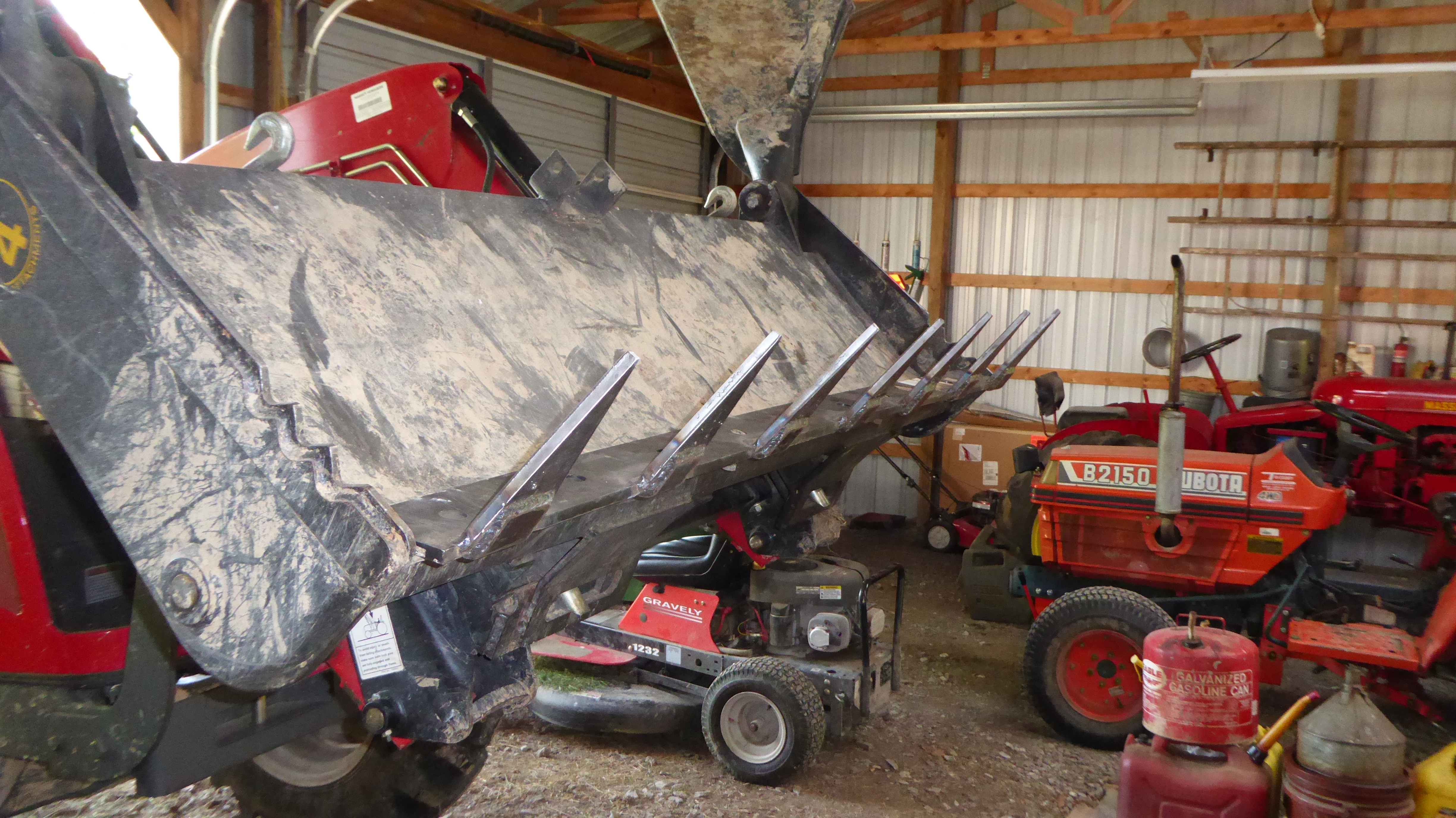

Wally: Sure. I have a lot of picts of that mod. One with the teeth pointing upward/forward with more of the garage wall showing you may notice is with the pinch bucket wide open and that was with the toothbar just sitting there in place but before I installed the bolts. By the way, that bucket weighs 1000lbs. It is on a MF 2660 and interfaces using a skid-steer compatible loader kit. Since it is bolt-on, I bought a separate knife edge to have the teeth welded to and kept the original plain knife edge for the bucket in case I want to go back anytime. So far I have not had reason to go back.

That looks like it would work like a root grapple, great at picking things up off the ground. Great invention.
