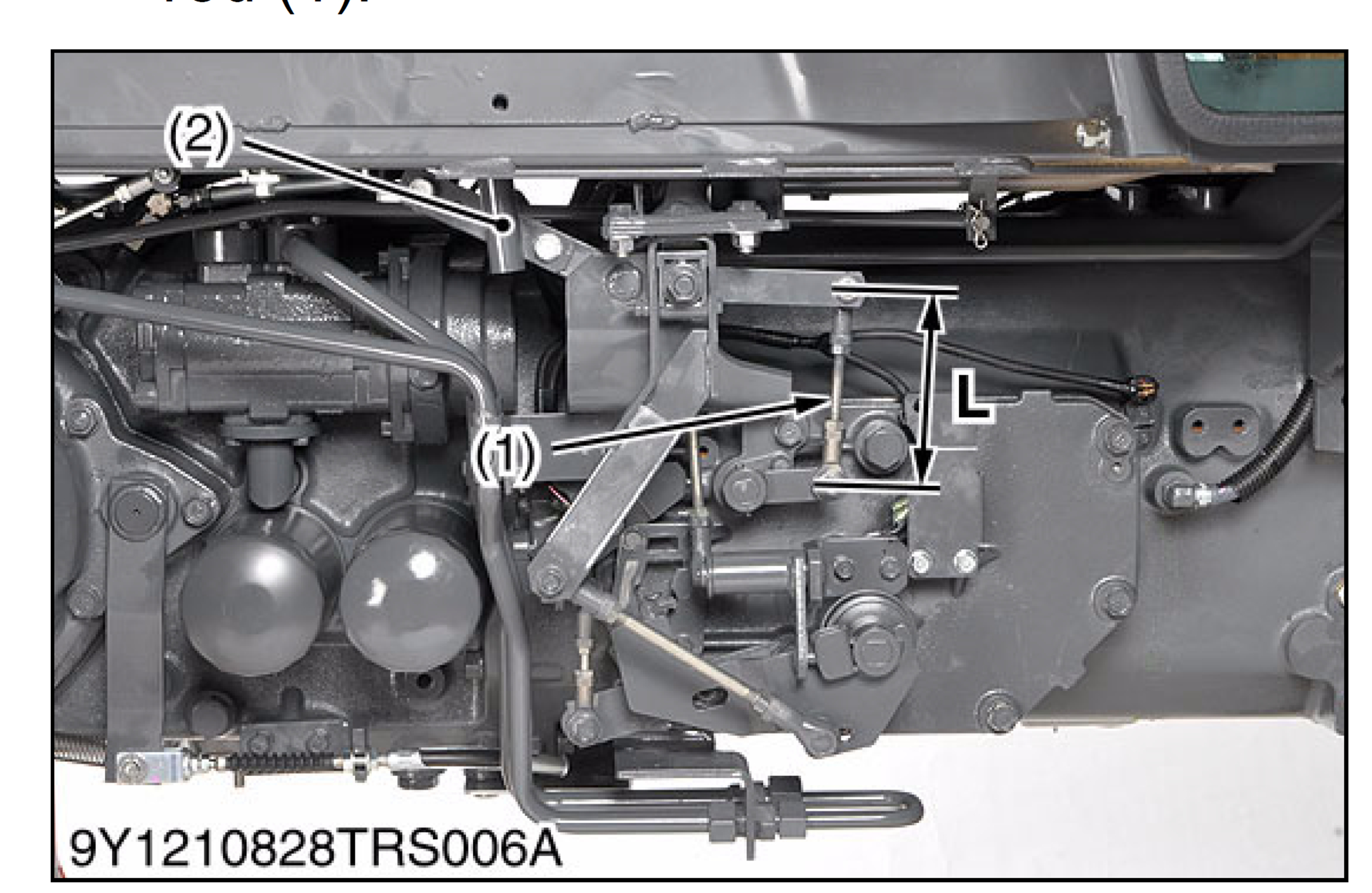

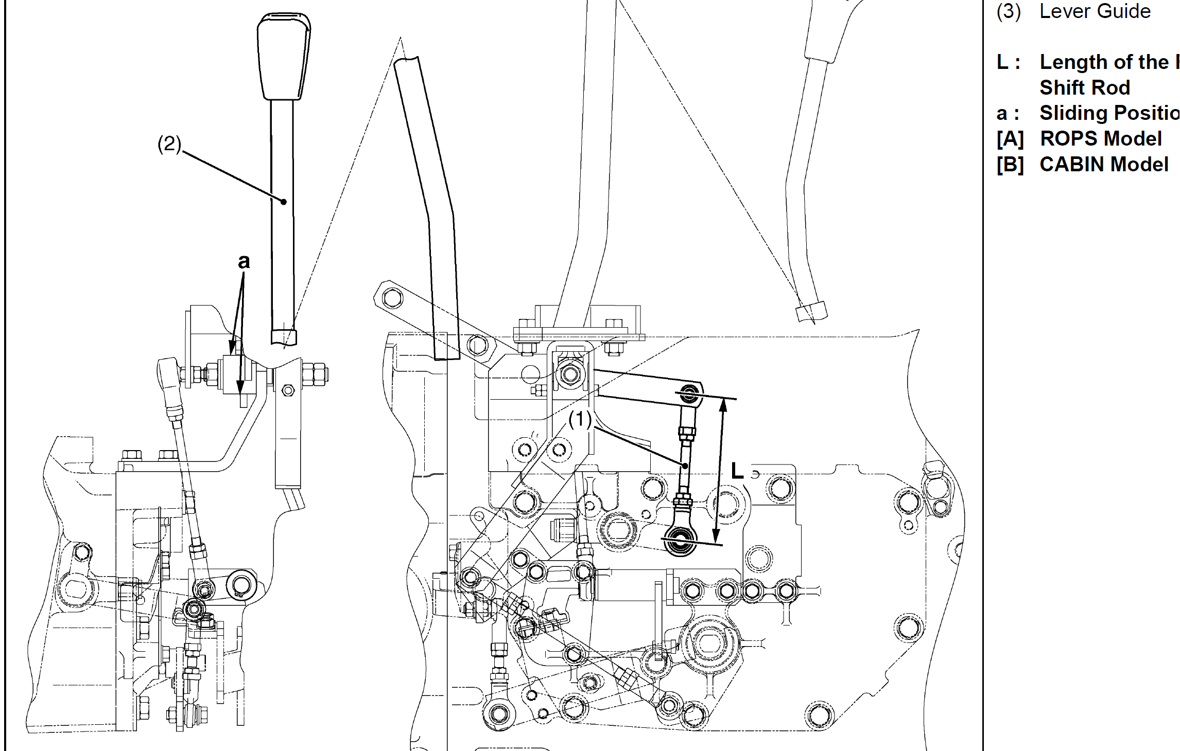

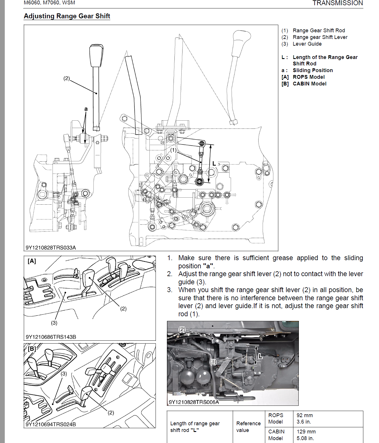

   / M7060 HSC 12 with creep
Here is what WSM Shows
   / M7060 HSC 12 with creep #6
Your bigger 7060 is radically different than my smaller Kubota with creeper. I'm no help here. Go by Dave 7040 and Oosik's advice.
WSM drawings you show clearly illustrate how to keep the range lever from rubbing against the sheet metal slot in the fender for the lever -- but I doubt that is causing your symptoms anyway.
