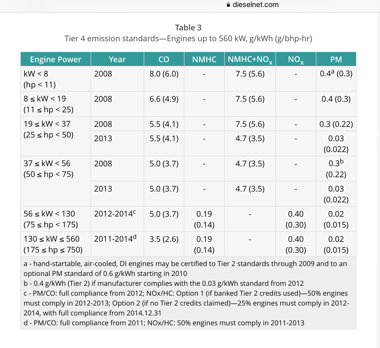

is tier 4 required on all diesel tractors? or just after a certain horsepower
   / m7060 engine warning 50% power reduction #84
Tier 4 or soon to be Tier 5 in the US, it's required on all tractors. However, tractors under 25HP can meet the requirements without any extra stuff attached to it.
From 25 up to 75HP, will need DPF to meet the requirements. Above 75HP, along with DPF, it will also need Adblue.

I'm not aware that Tier V has been adopted in the US and could not find anything to support that it has.
   / m7060 engine warning 50% power reduction #90
There is no Tier 5 for North America. The latest rules were set in the Federal Register dated June 29, 2004. Stage 5 Europe has not been carried into North America.
