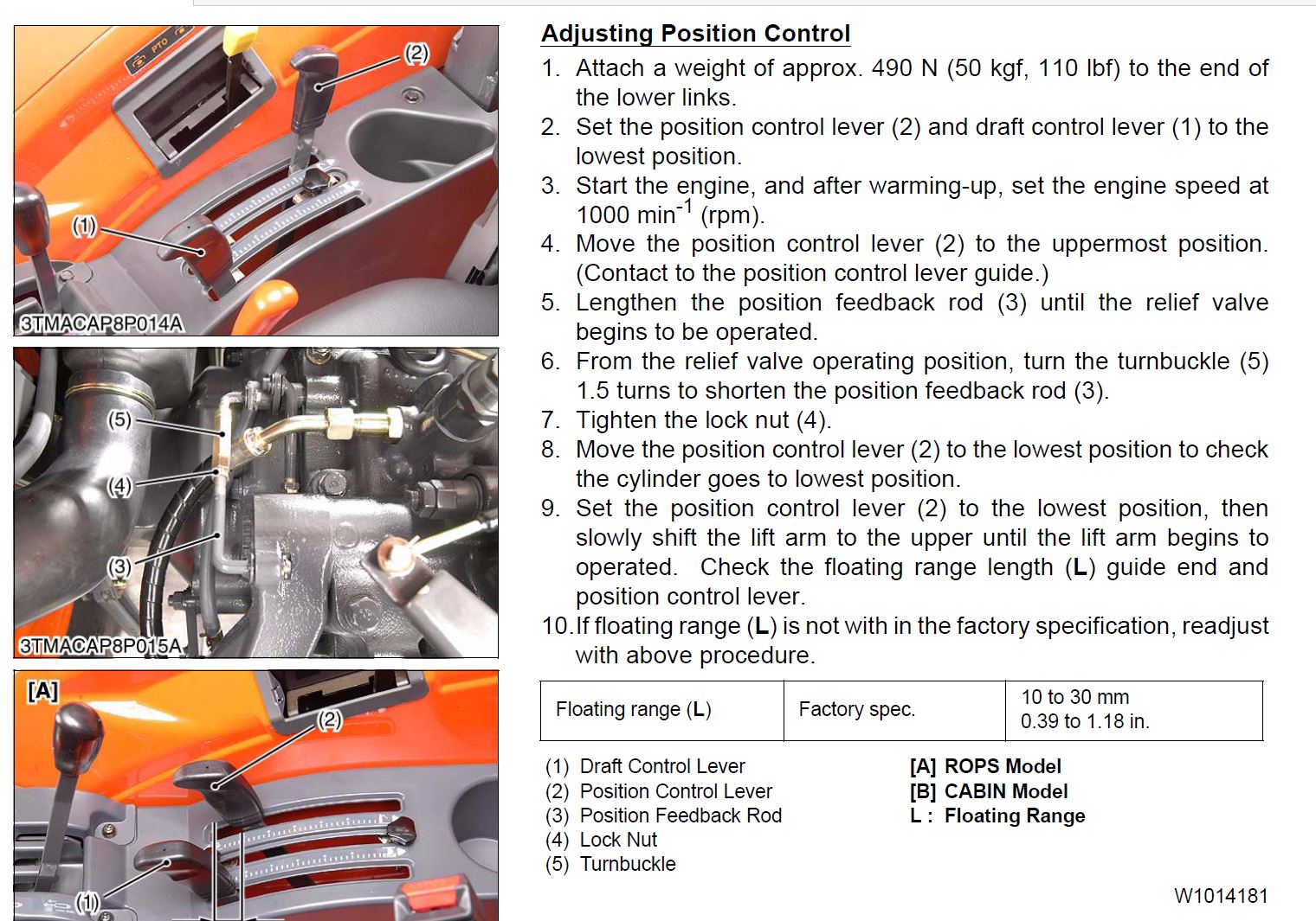

My lift cylinders on the 3 pt are different than the ones in the page from the WSM I posted earlier.
The cylinder push rod is not exposed on my tractor.

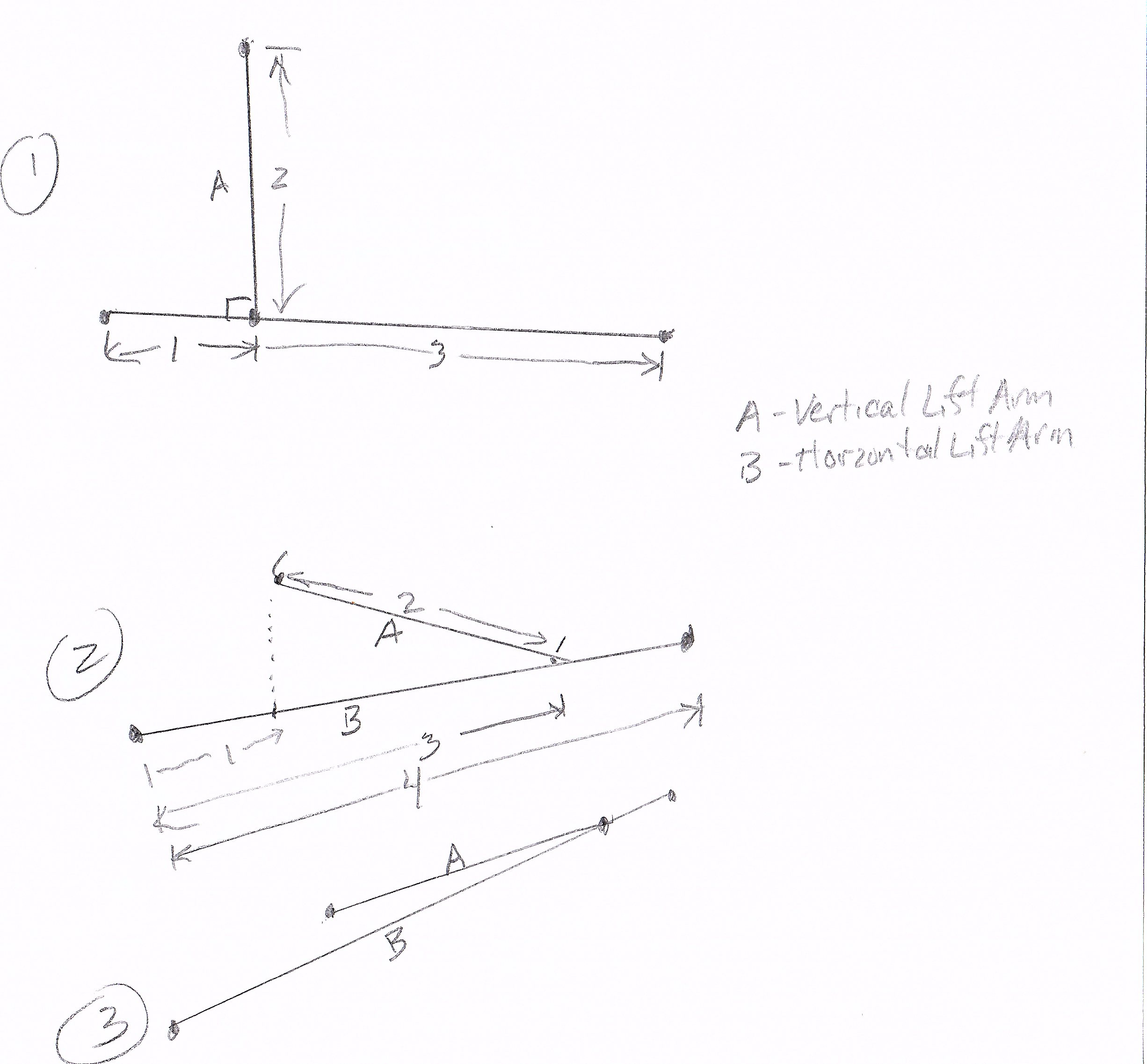

See the crude drawing below. (I think we are talking about the same thing.)
Of course, theory is fine but to find out for sure requires an experiment!
Dang I've forgotten most of the Algebra & trigonometry I took in high school so I'm lost on your drawings but I still think with pin in hole in draft arm closer to tractor will raise implement higher!!!!!!!!!:D

You have R4s? If you went to hole A your lift would be higher, and you already have 1 3/8 on me.:confused::confused:

If you are missing out 1-3/8"( and likely more since you are using hole B) then I would do the procedure first suggested by GWdixon.
The post I made (including a section of the WSM) seems to say that the simple test is to raise the arms as far as they will go and then try to lift them further by hand.
If they will go up more than the small amount listed by Kubota then you adjust the rod since you have some unused travel in the hydraulic cylinders.

> The photo in post #21 illustrates a point I was trying to make earlier. If attachment point A is used then the attachment balls will be lifted a bit. The lower link will be further from the ground. A higher lift might be had with attachment point B but not much. Remember, the OP needs for the end balls to begin as high as possible.
