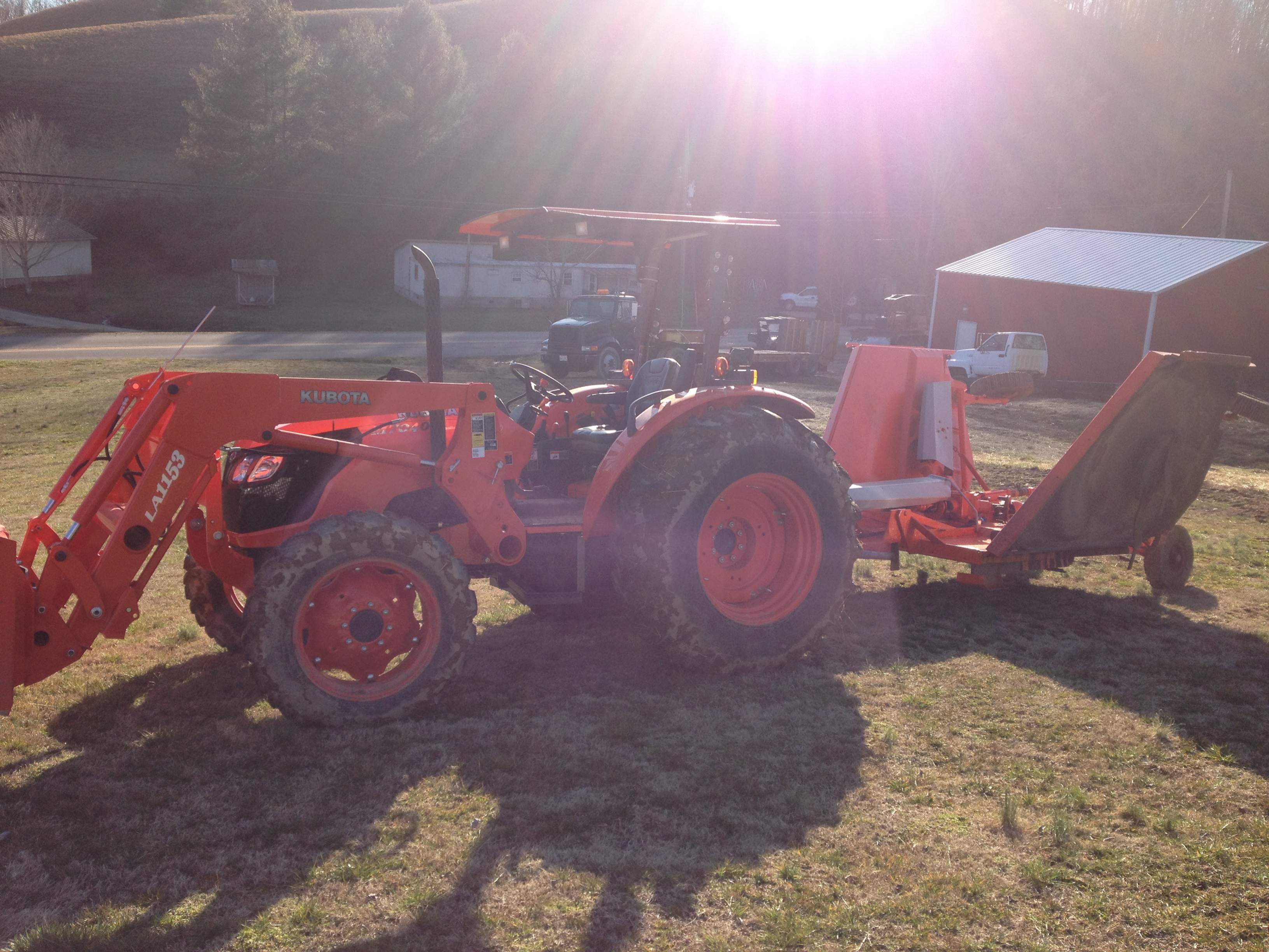

Yeah my tractor is a 2013 M7040HD hydraulic shuttle 4x4 with a FEL, with cast iron centers on the rear wheels, front weight bracket, open station with canopy, canopy lights and an overhead stereo.
   / M7040 "hissing" noise from under seat?
#32
This is a bad pic but its the last one I have taken after a day of bush hogging
