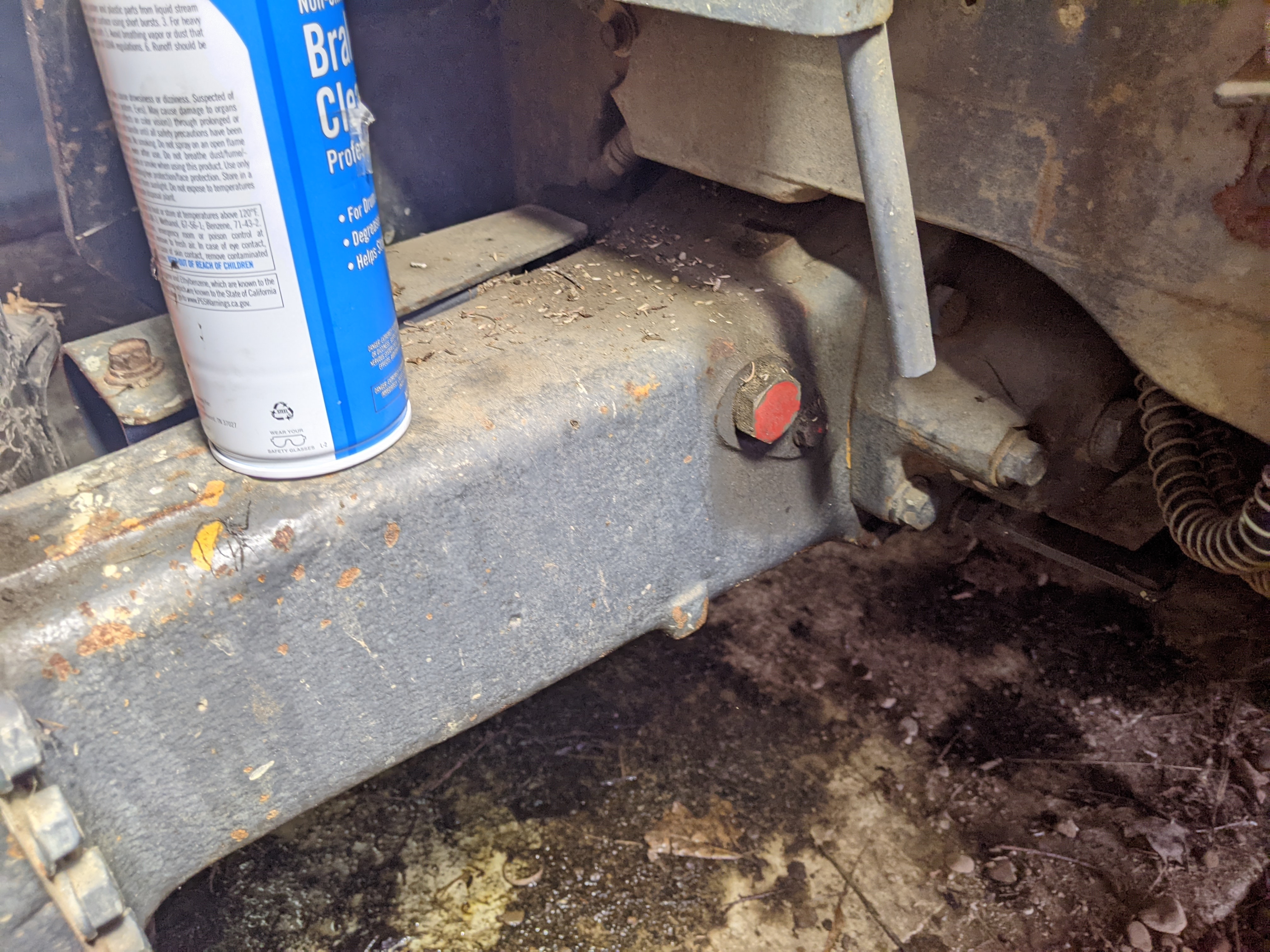

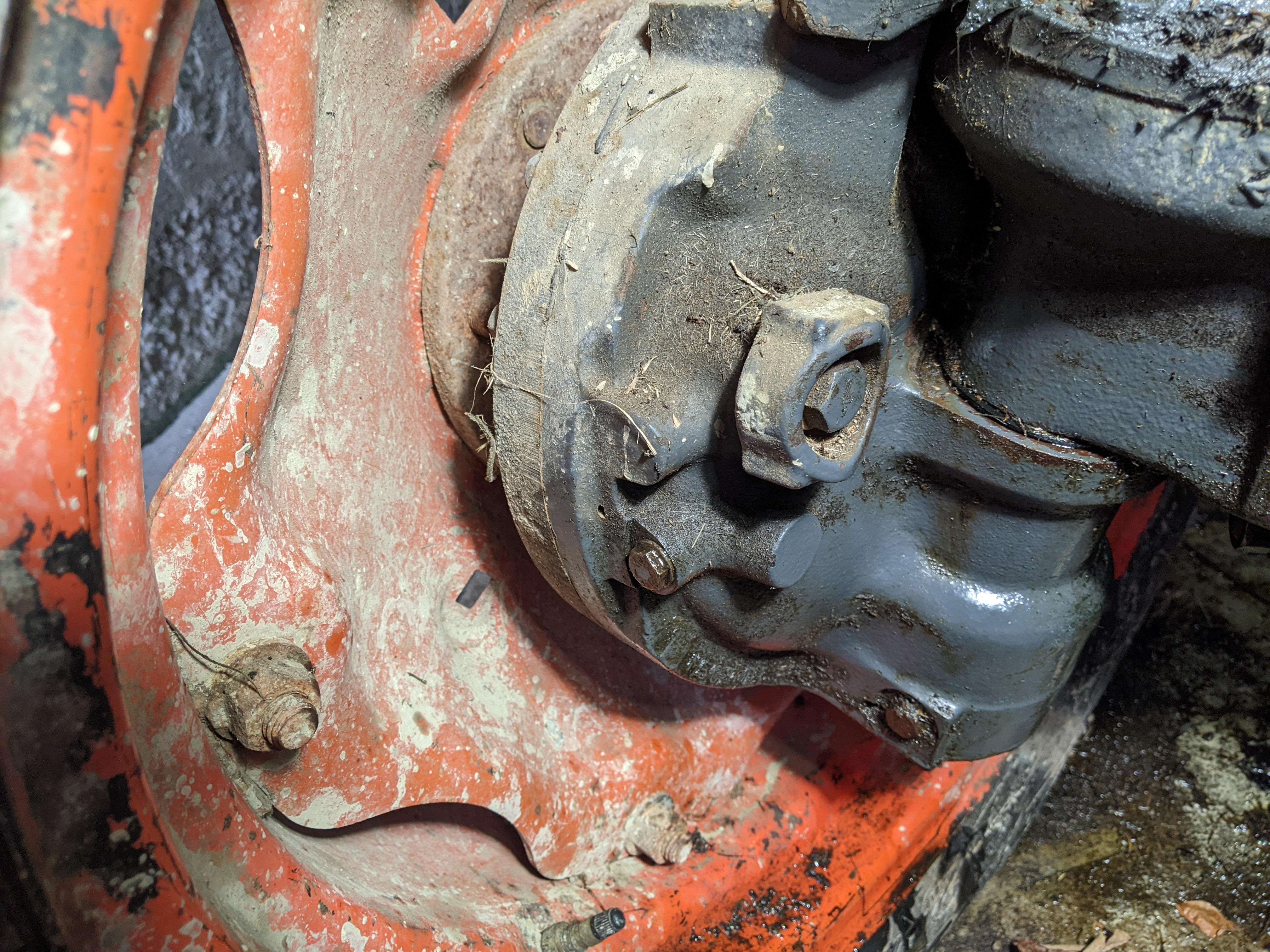

I found the axel was low on oil and added 75-90 gear oil. I am not using the tractor much so will see how much oil it is leaking. Do I dare use corn head grease in that front axle in an attempt to stop the oozing? I have attached a picture, it shows the drain plug and the fill/level plug. What is the plug inside the nut in the middle of the picture? You can also see the seal that is oozing. The second picture shows the axle fill/level plug, that's where I would put the corn head grease.

The center housing is separate from the final drives. I wouldn't suggest putting grease (cornhead or otherwise) in any of them. Just my opinion.
The cap on top with the grease fitting. It has four bolts holding it in place. Are those bolts in a square pattern or are they in curved row? There's apparently a difference between an "old type" and "new type". Old type has the rectangular bolt pattern. The book shows something like what's in your first photo. They call it an adjusting bolt. It has shims under it. I have no idea what it would adjust. It might be explained better in the WSM.

I have some 75-140 gear oil rather than corn head grease. I am going to pull the grease fitting and see if that is low too. Not sure where you check the level. I was surprised when I took the fill/check plug out of the axel, there was a vacuum in the axel. I have added about 1 1/2 quarts gear oil. Got to build a tool to inject the gear oil. I can't figure out where the axel is leaking. The only oozing was at the seal in the bottom of first picture, opposite the bolt to adjust shims.

Your axle looks very similar to the M5030DT.
Axle, the large plug is for fill, small plug to the right and slightly lower is the fill level. Going by memory of WSM. Do what your manual says.

The grease is just for the top cap. It's not connected to the lubricated parts inside.
Very good. The grease fitting it to lubricate the radial contact area between the upper knuckle and the center section.
Repairing the 'oozing' all depends on where it's oozing at. If the oozing is collecting on the wheel rim inside, it the outer planetary seals. If the oozing is between the upper and center section or between the center and lower section, it's the radial seals that you can see (black rings). The reason why they start oozing is the insert bearings that carry the through pin have become sloppy and are allowing too much slop to exist and the the radial seals can no longer seal the lower and upper sections to the center section and must be replaced as well as the seals and it will only get worse as the insert bearings wear more.
You can do it yourself but be apprised the outer planetary assembly is heavy and is located using locating dowels in the inner gearcase and it must come off straight and go back on straight and there is a large 'O' ring that seats in a milled groove in the outer planetary assembly that has to be in that groove 100% to seal plus you need to coat all the mating surfaces with 3 Bond, not dime store RTV either. The upper and lower insert bearings must be press fitted into the upper and lower sections, as well and installed straight and true or they will fail.
My suggestion is, it you don't have the equipment to lift and align the outer planetary assembly to remove it and reinstall it (I use a cherry picker myself( or don't own a precision seal / bearing driver, take it to a Kubota dealer and not some shadetree wrench either. The tools requires to effectuate the repair are specialized and the assemblies are heavy. I've dome my own in the past on both my M9000's, which are getting pretty old 2000 and 2002 and get worked hard. If you do it, pay close attention to the fastener torques listed in the shop manual as well. Correct torque on the radial seal between the inner housing and the outer planetary assembly is critical as well as the fixing nut that preloads the lower and upper sections to the center section and effective sealing of the radial seals is dependent on correct torque.
Again, the zerk fitting only provides lubrication to the radial sliding surfaces on the upper and middle section and there are a set of level and fill plugs, 2 on each outboard, and one drain plug on the very bottom as well as a level and fill plug on the center section near the axle pivot and the axle pivot needs to be greased regularly and the pre load checked regularly as well or the center section will start 'oozing' as well when the slop gets too much.
When replacing the fluid, don't use UDT or SUDT, use 80-90 0r 85-140 GL4-5 hypoid oil. It provides much better shock load and the higher viscosity don't ooze as much.
