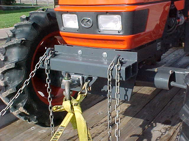

This front plat was used to tie down my tractor and has a receiver in it. The carrier fit into the receiver. You could make something like this and fill the tubes with lead from wheel weights. Use good ventilation.

Thanks for sharing the great pics! Looks good, did you build, or have built, the plate on your M6800? How thick is the plate? Used 4 mounting bolts? I like it! I guess you could build a removable radiator/brush guard to plug in.

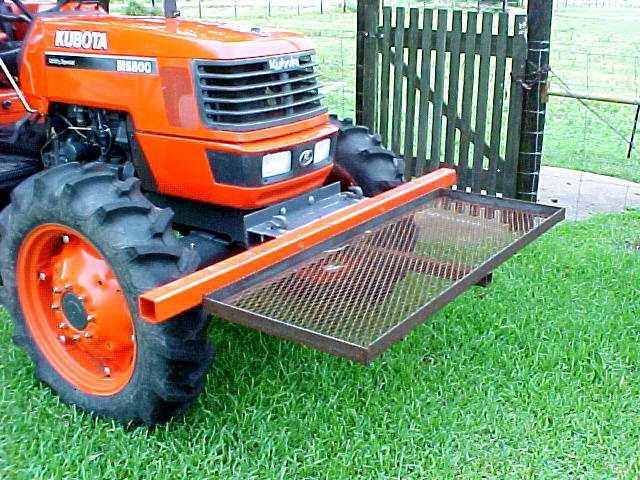

I've done a ton of custom things for my M6800 is you want to see some pics. My thought is pretty much If I have to do it once I probably will have to do it again. When I use equipment I want every thing safe, fast, and easy to connect or use. It has been a lot of fun and the machine is sweet.
The plate is 1/2 thick, but 3/8 would work. I bought the metric bolts because the tractor front plate it bolts to is also the same one the FEL mounts to. Don't save money now on cheap bolts, just to have your FEL not bolt up later.

I'd appreciate seeing any pics of mods or projects you've done for your M6800! I knew there were at least 6 mounting holes, but it looked like 2 of them were covered by the two pieces of boxtubing on your plate.
