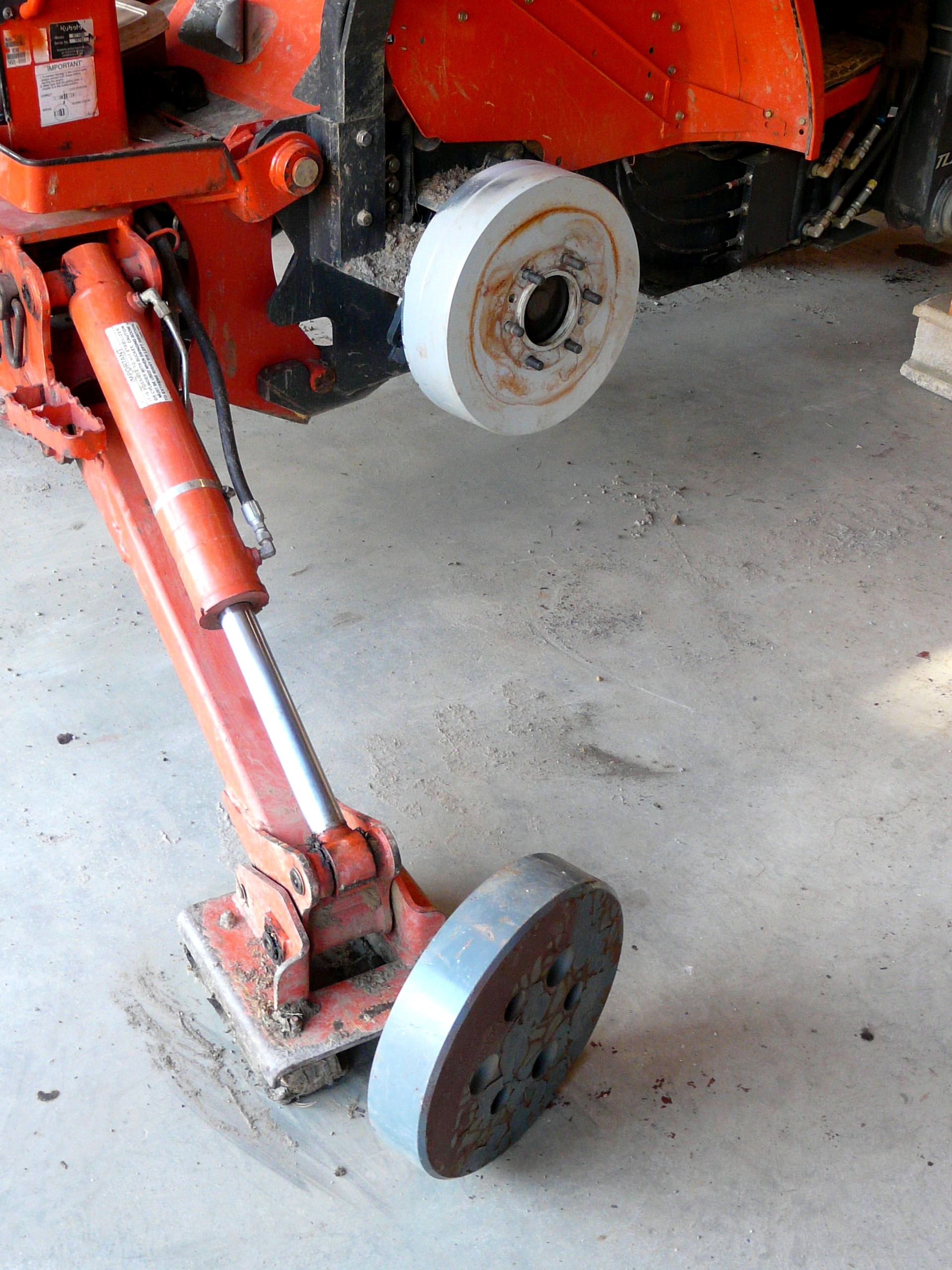

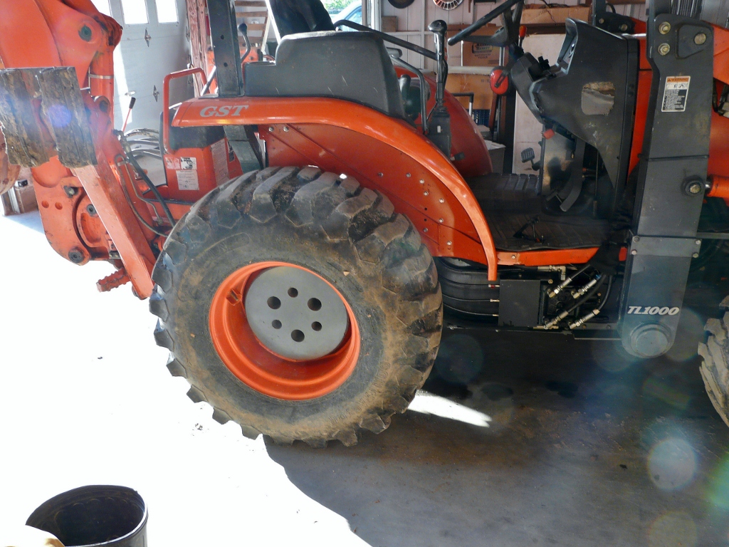

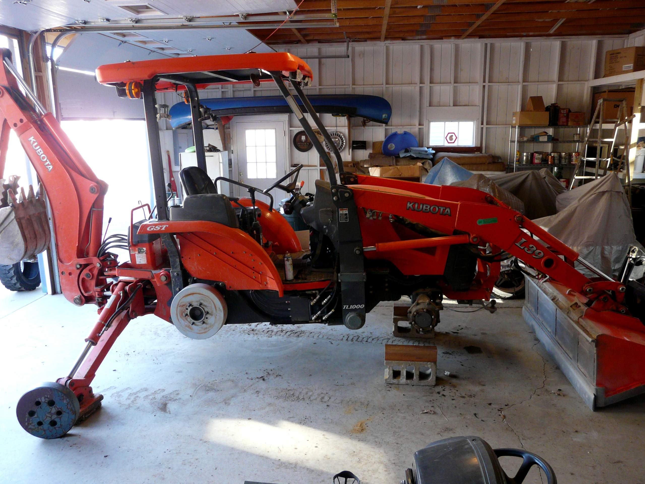

The photos, show my weights for the L39. Two on inside or rim two on outside, for a total total #750 lbs. The Back Hoe makes it fairly easy to install and remove them.
I still can pick the tractor up with the hoe and move it around. With all the other stuff on it it is a bit over 8,000 lbs, and that is about as heavy as practical. An M59 or M62, should be kept around 10,000 lbs. Washer fluid is fine, Beet juice is not needed as tires are decent size and as said, the TLB's are heavier than the avg. Kubota.
I prefer wheel weights/ spacers over +1,000 lb filled tires.
I used carbon steel rounds, but Dura-Bar this will be cheaper, easier to have machined.
Give you business to a local machine shop. Most are hungry.
Peterson Steel - Providing Dura-Bar; Continuous Cast Iron Bar Stock Steel Alternative
PS The TLB's seem fairly stable. Plowing my icy drive, I slid over a 4' embankment. Without the weights and addition wheel spacing it would have gone over, but the slope was at least 45 degrees, and it did not roll.(thankfully)'

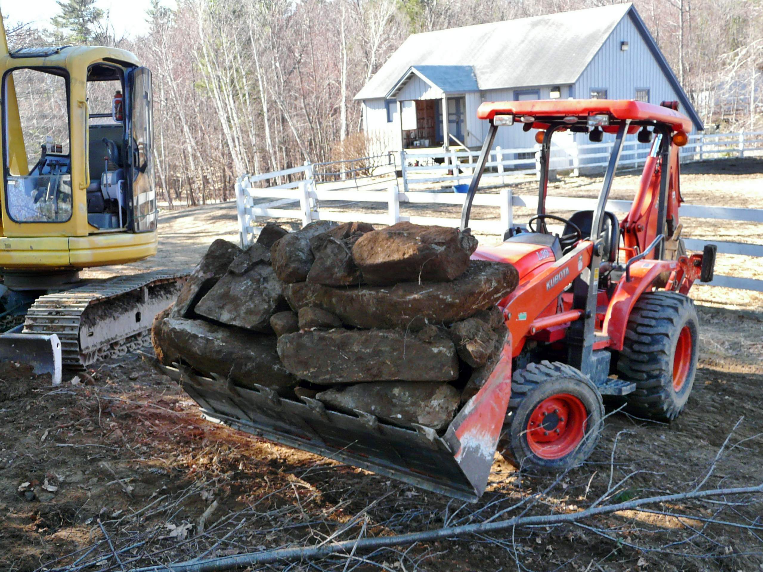

That's a major load of rocks in that bucket. Yikes!

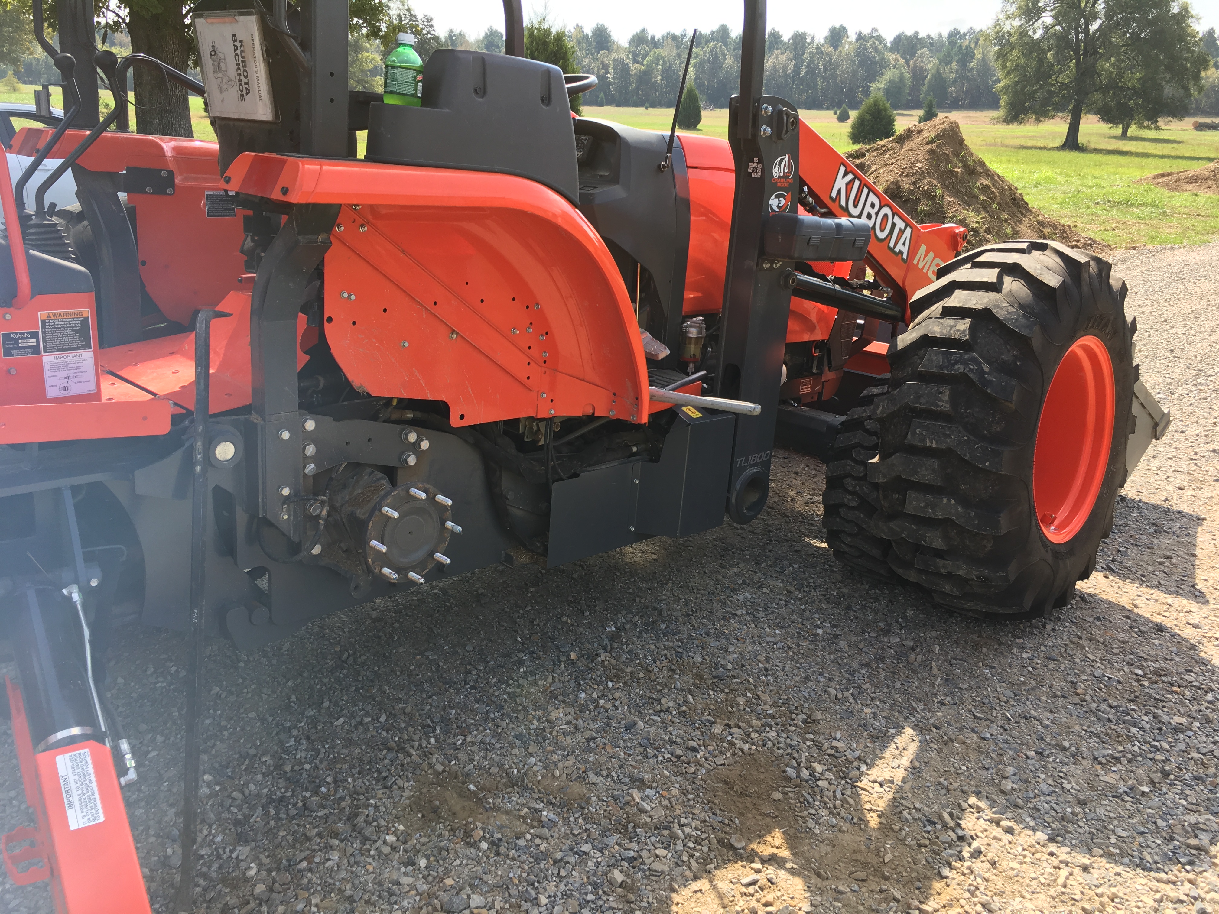

Thanks for the response. Much appreciated. Where did you get the spacers? Handy having the backhoe stabilizers to pick the thing up. My hope is to get the tires filled at the same time as I add the spacers, so they only have to be removed once.
Is two inches enough extra width? Would you go more if wider ones were available?
Thanks again.

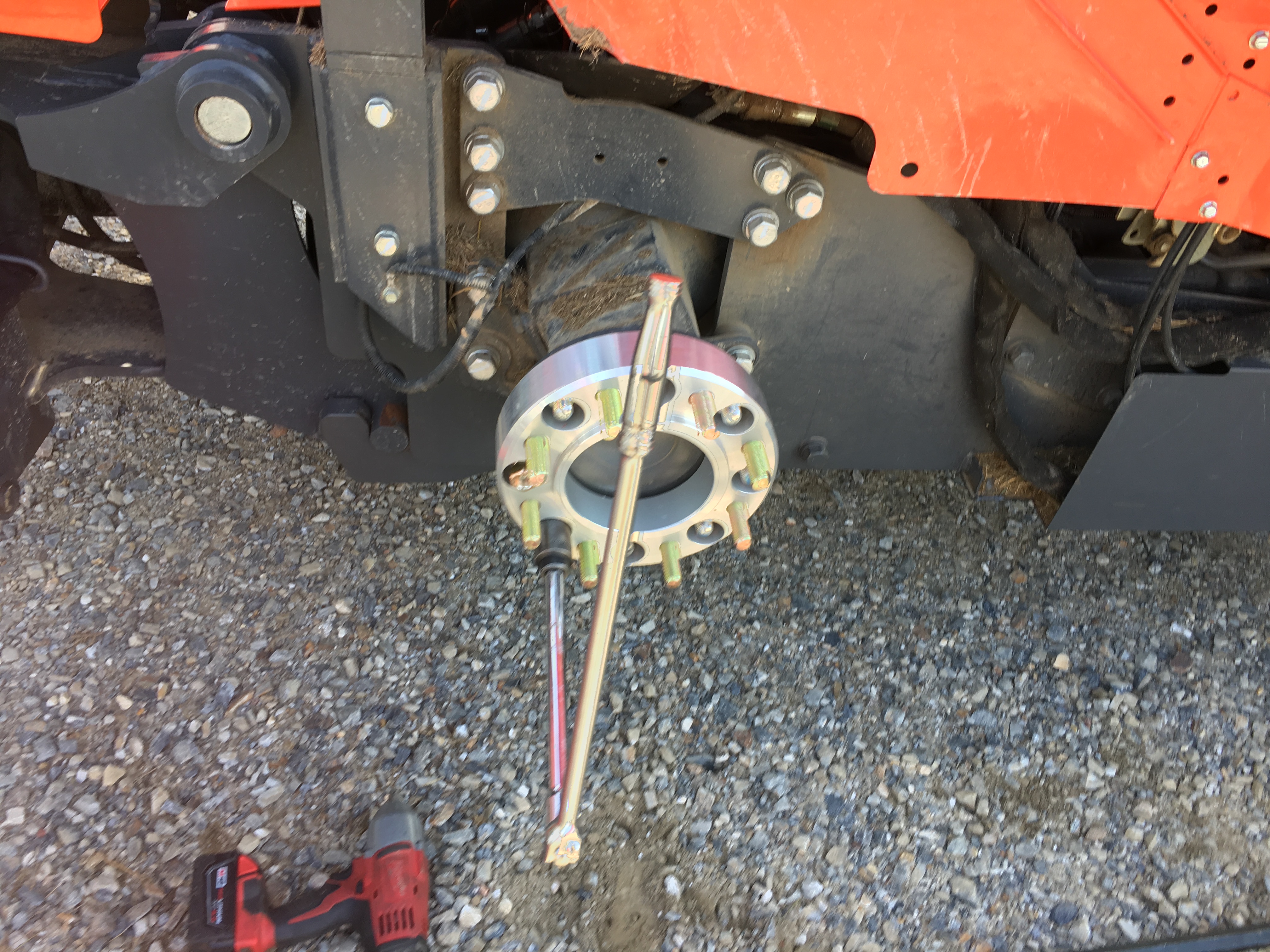

Richard @ Bro-tek is where I bought mine, they were $450 delivered for the pair, it includes a set of lug nuts & lug bolts. Which brings ups a point, each OEM threaded stud & nut from Kubota is $60 & my first install with an impact driver I boogered up 3 or so threaded studs & nuts. the spacers are aluminum, 2" thick & due to the size of the OEM lug nut it sorta limits you on how you can installl. The hardware from Bro-tek is high grade so you can use anywhere on the installation. My problem was after my 1st install I was running minus 2 lug nuts & a couple more were seized. So my second install I removed all the threaded studs & replaced with Bro-tek's lug bolts, these hold the spacer to the hub, then I used the OEM lug nuts to fasten the wheel to the spacer. This was a lot of work using a 3/4" drive manually, I wouldn't use an impact unless you have extra hardware for the ones that get boogered up.
Is 2" enough extra width? That's subjective but by design the seating position makes it VERY uncomfortable to drive over the slightest grades versus a traditional tractor with the seat tucked down in between the rear wheels. So your perception is that you're going to tip over. My suggestion is to setup a situation where you can safely test the stability of the backhoe. Two things will become apparent, you feel like you're going to tip over way before the backhoe becomes unstable, two, the distance between the seat & the center of rotation is far enough that you can be slung out of the seat without at the backhoe even tipping over, if you did tip over, I'd be more concerned about hitting the roof than the ground. More like a catapult than anything else.
As I understand everything, spacers effectively lower the center of rotation but at the expense of the distance to the seat. While it does increase the stability of the tractor from tipping over it also increases the overall force the body would experience if you did tip over. So if your activity leaves any room for doubt, where that belt.
Hope this help...

Kubota can keep their $60 studs. My time is not that valuable that i could not find the same with a tape measure, thread gage and a wi fi Connection.
PS, my weights spacers only add 1" each side and if I had to do it again would make them 1-1/4" or 1-1/2" to increase track 3" total, so 2" spacer is plenty. More stresses axle and bearings.
