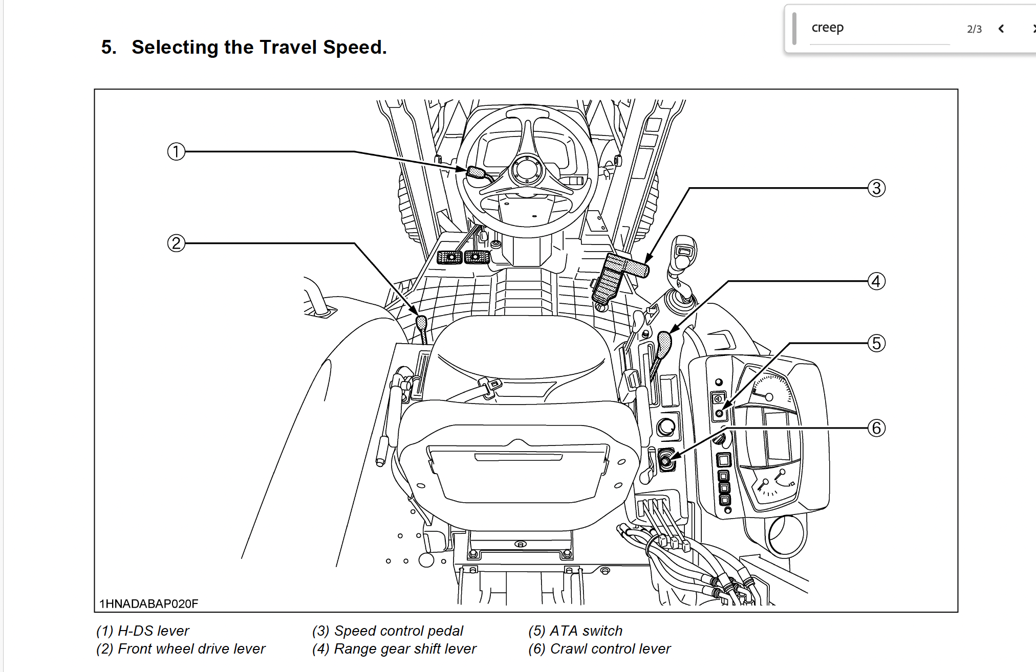

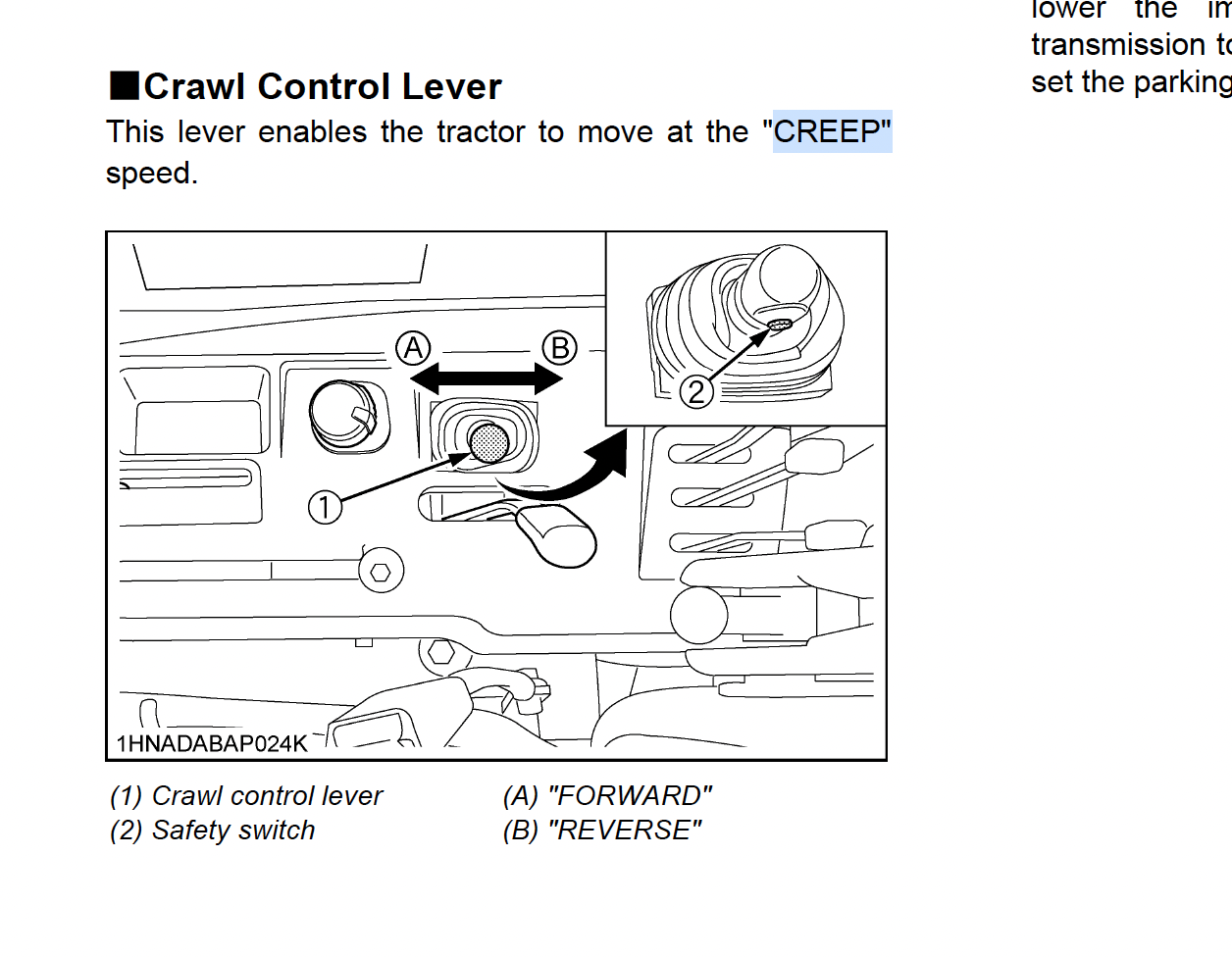

Does the 2016 M62 have the creep function?
   / M62 TLB for Maintaining Hilly Land ? #140
Yes. The M62 lever is different from the one on the M59 but the operator manual says it does the same thing.
