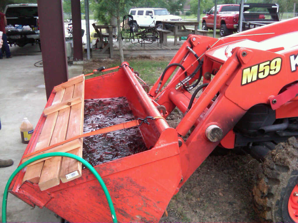

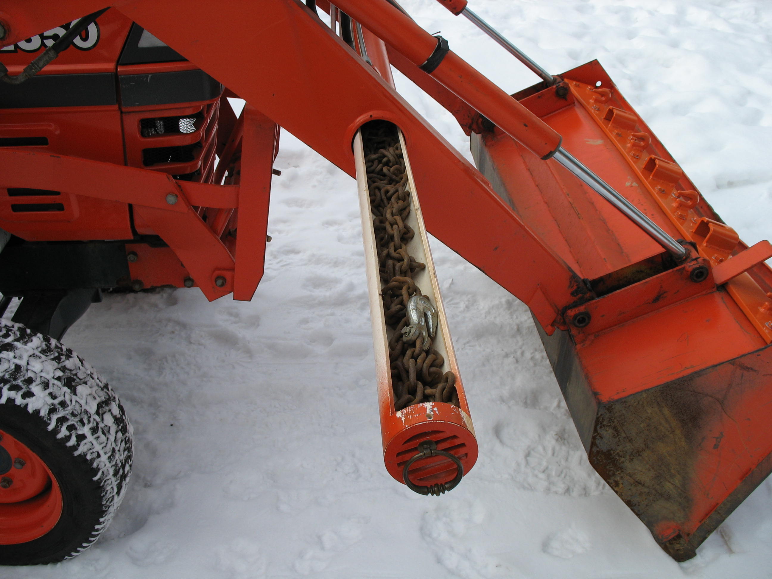

The toolbox (rScotty mentioned) is something else I need to work on as well as where to attach a shovel and hand hoe. Sometimes i just have to get off and do a little manual stuff.Thanks again-Bill
My tool box is a stiff canvas bag hung from a hook mounted on the BH lever guard -just aft of the Rt. rear tire. Someday it will be better.
My favorite way to carry a shovel and hoe is to lash a couple of lengths of 2" PVC pipe vertically to the FEL upright. Then I drop the handles of the shovel and hoe into them and they ride with the blades up.
rScotty.
