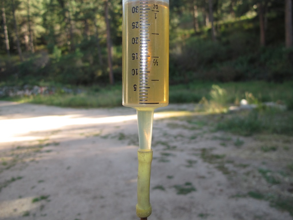

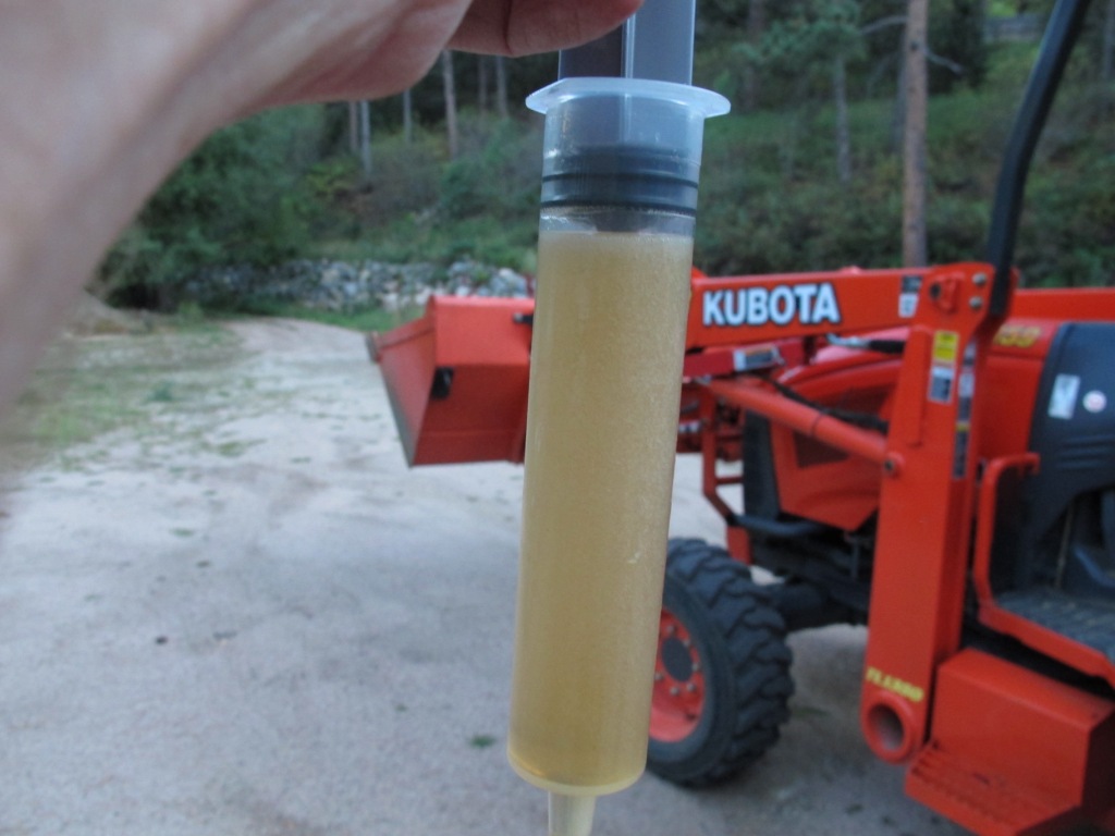

OK, I pulled some samples from my own tractor yesterday. Temperature here is in the 70s, trans/hydraulic oil is New Holland Multi-G 134 with 100 hrs on it which included all new filters. Only hydraulic problem we have is a bit of whine from the high pressure pump (on engine right side) when the motor is cold.....which either goes away or gets so quiet I can no longer hear it as the machine warms up. This M59 rarely gets asked to do much hard work and definitely not quickly. It's babied.
I took a picture before starting the tractor and the oil is clear. Any haziness is simply whatever was last in that syringe.... The second sample is about ten minutes later after using the backhoe to lift and load a table saw into my buddy Craig's pickup. Altogether the M59 ran at idle for about ten minutes, moved the backhoe booms twice rather slowly, and drove about 50 feet in low gear.
We were flabbergasted at the amount of bubbles of entrained gas (air? oil vapor?) in the oil. Craig and I both know a bit about the physics of air and vapor entrainment in fluids....it would be interesting to know which type this is. Whichever it is, we were sure surprised to see it there. To make sure, I drew another sample and it was identical. The sample in the photo has been in the syringe less than a minute and looks to be already clearing - which is good? The next day the oil in the syringe had cleared up entirely. I don't know if that took minutes or hours.
The immediate question is whether this bubble entrainment is a also typical of other tractor hydraulic systems?? And would it clear up if the tractor ran longer?

The odd hydraulic things that I do see or hear - like the entrained gases we photographed and the whine when starting cold - are clearly things that Kubota didn't quite get right. So far I can't say that either one has caused a problem for us.... So to be fair I can also say that even if Kubota didn't get it clear right, they didn't get it wrong either. And so with some finger-crossing they might even be considered normal.
For that matter, the amount of entrained air that the attached photos showed might be normal for tractor hydraulics throughout that industry. Although putting on my fluids engineer hat allows me to say with authority that the cold whine and the gaseous entrainment are probably related. And also IF that amount of gaseous entrainment is considered normal.... then the whole industry needs to do some work. It is easy work, but it does need to be done for reliability reasons.
