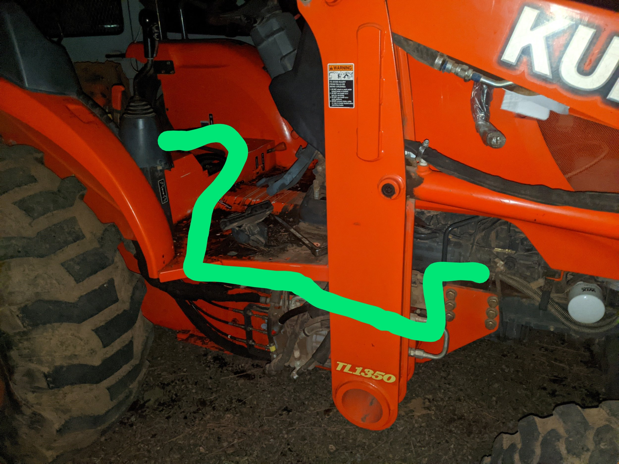

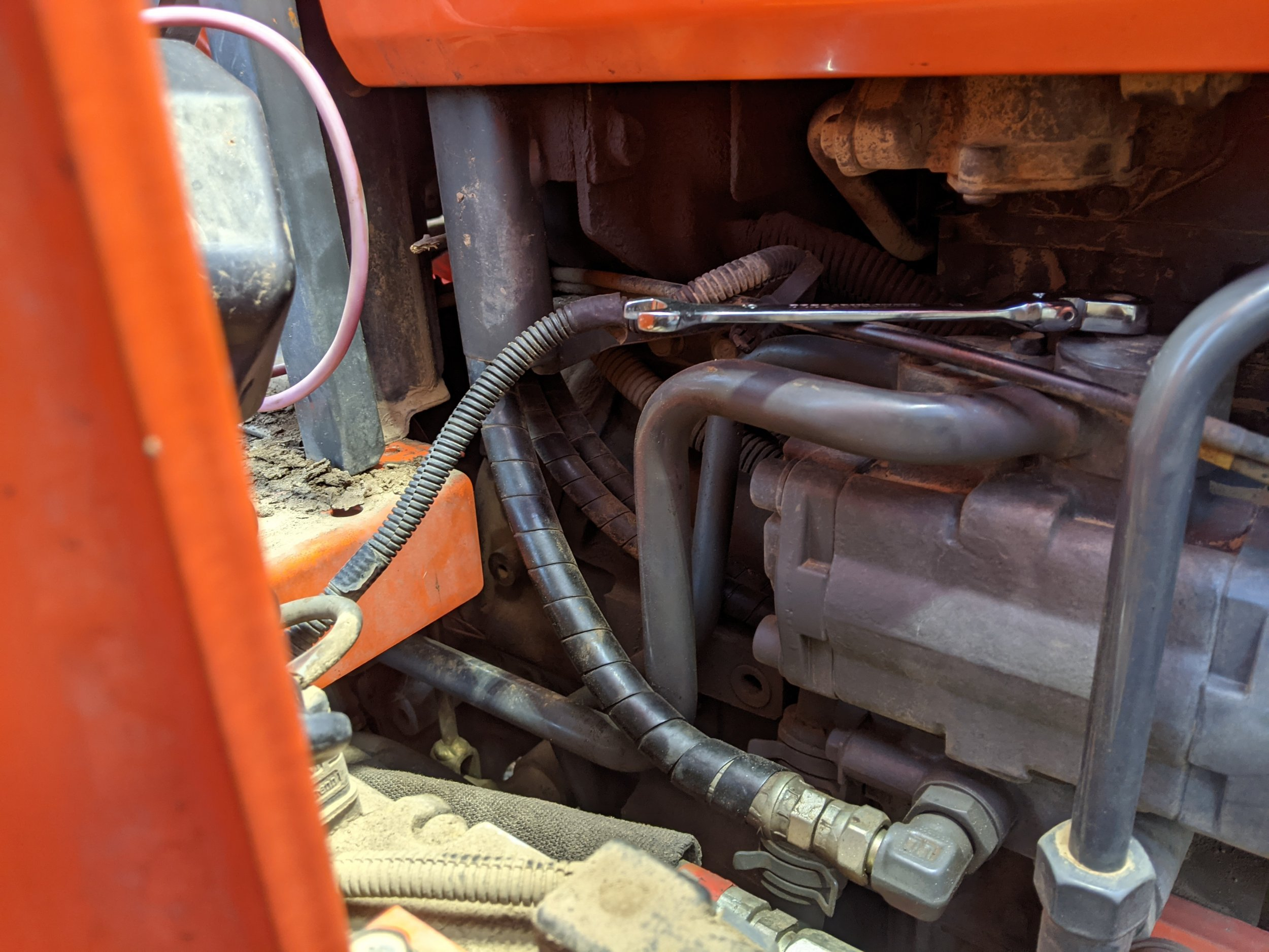

Just curious if you had a picture of assembly and where it’s routed?
   / M59 hydraulic tube replacement
Runs from the pump on the right hand side of the motor, then down under the flat plate, then back up again under the seat to the main valve. Basically 3 ft long and u-shaped. Even with the flat plates loose and all of the clamps removed, I only got about an inch and a half of movement. Took an 18-in socket extension just to remove one of the clamps.
Silver patch is holding.
   / M59 hydraulic tube replacement #9
Wow , thanks for the pics. Looks like you found the best option to braze , nice work!
