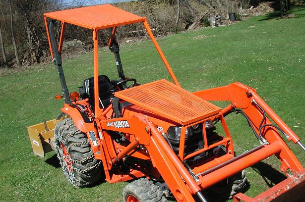

My tractor is not an M, but I would think a hood protector should cover the entire hood.
Years ago I built hood and head protectors for my little B2910. Been very happy with them.
Just for the sake of discussion, here is what I have:

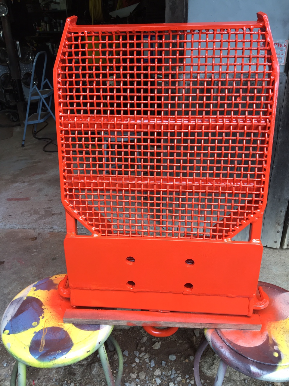

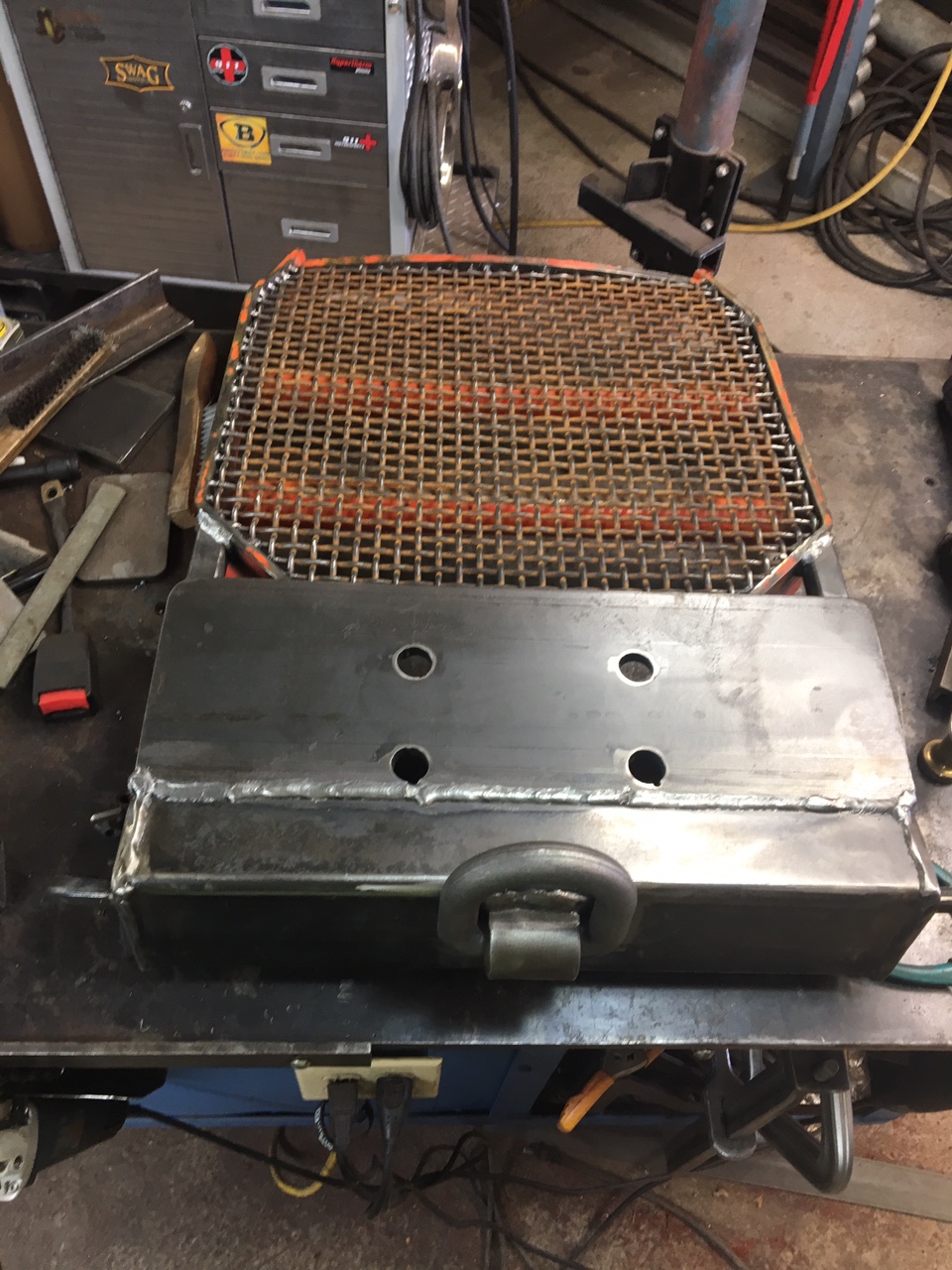

   / M59 hood protector
#15
Grill guard upgrade for M59. 38# to 108#s. Quarry screen tougher to work with than expanded metal. Boxing the bottom adds strength. High humidity makes paint take for ever to dry. This is the 5th grill guard I’ve built. Bush hog tough, high stuff. Rather have bumper make first contact than the front axle. Move lots of brush, push out trees, roll stumps, etc. My hillybilly trees fight back.
Just needs a hood protector hat to complement the look;-)
That looks like very nice work all around. Congrats. Nice to see good craftsmanship.
Did you ever try those cross bar links on the chains? Or was that you?
