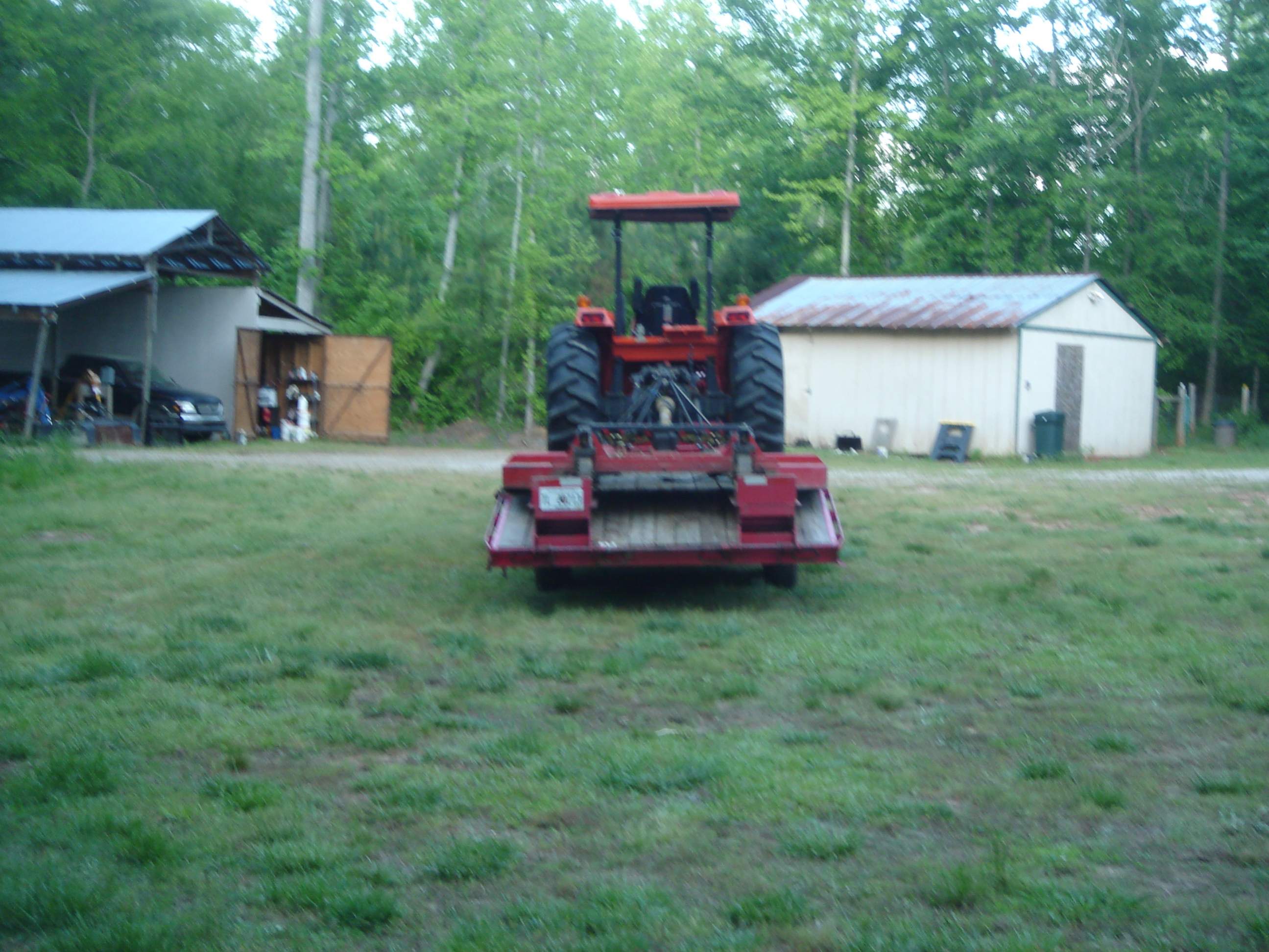

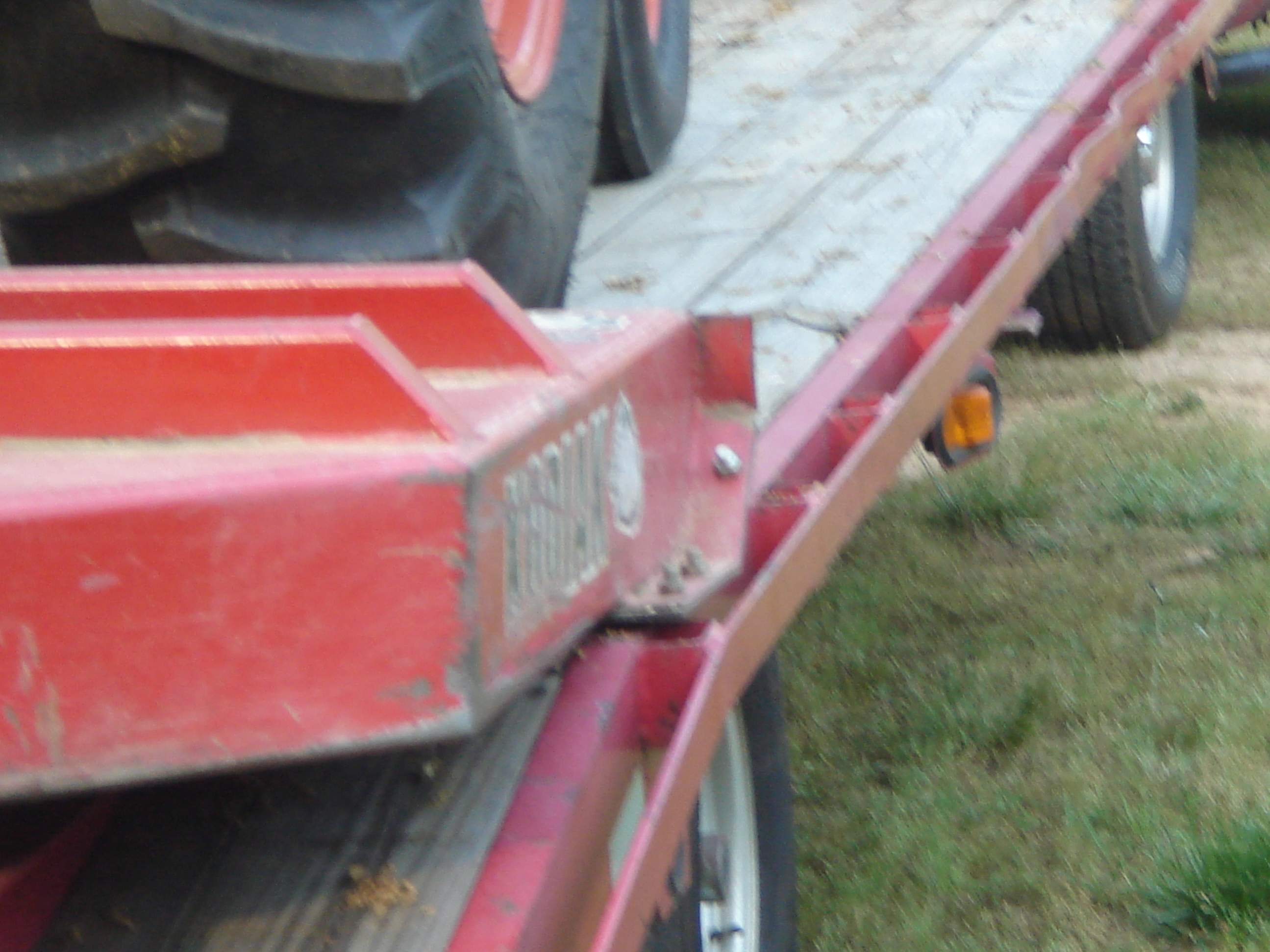

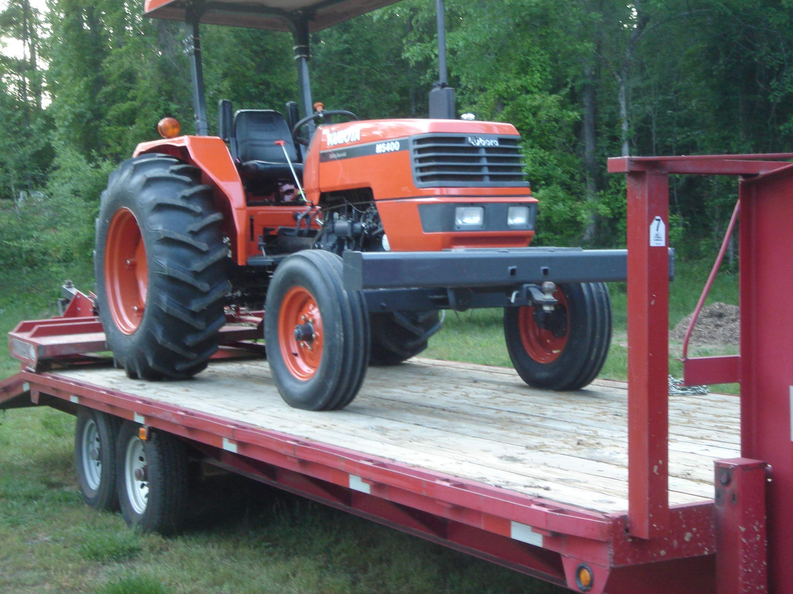

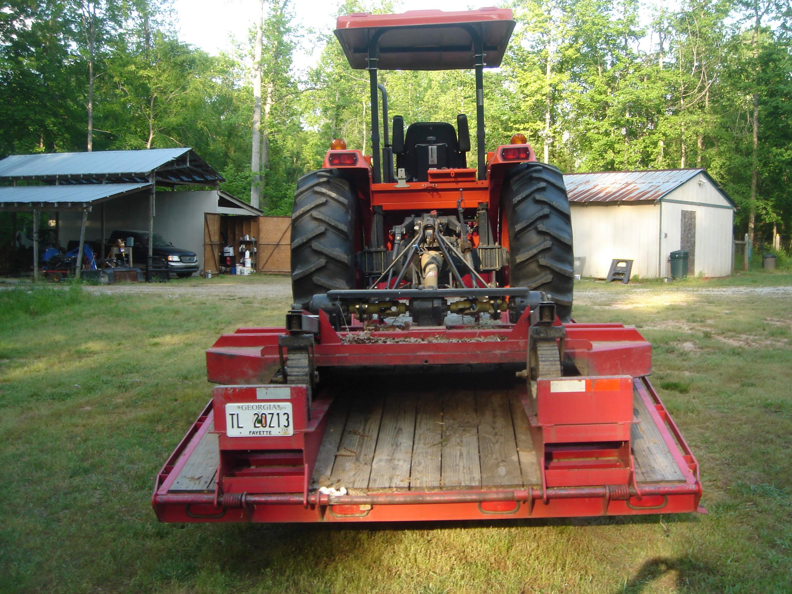

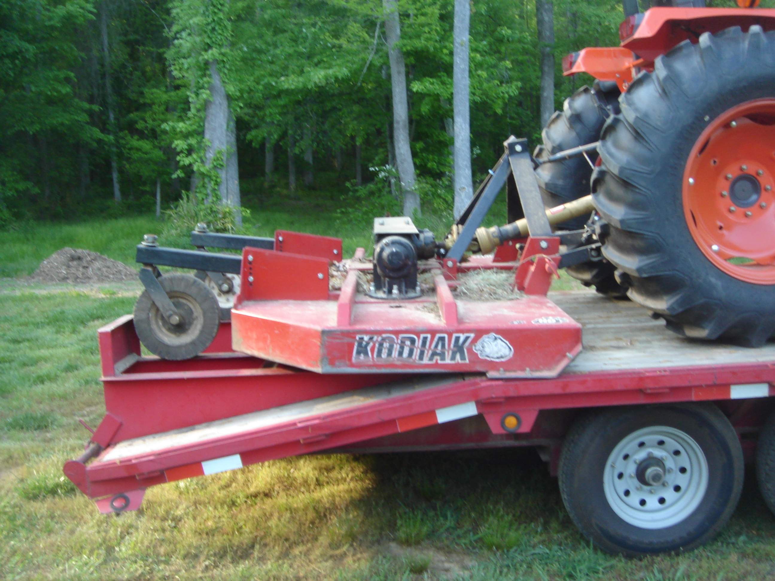

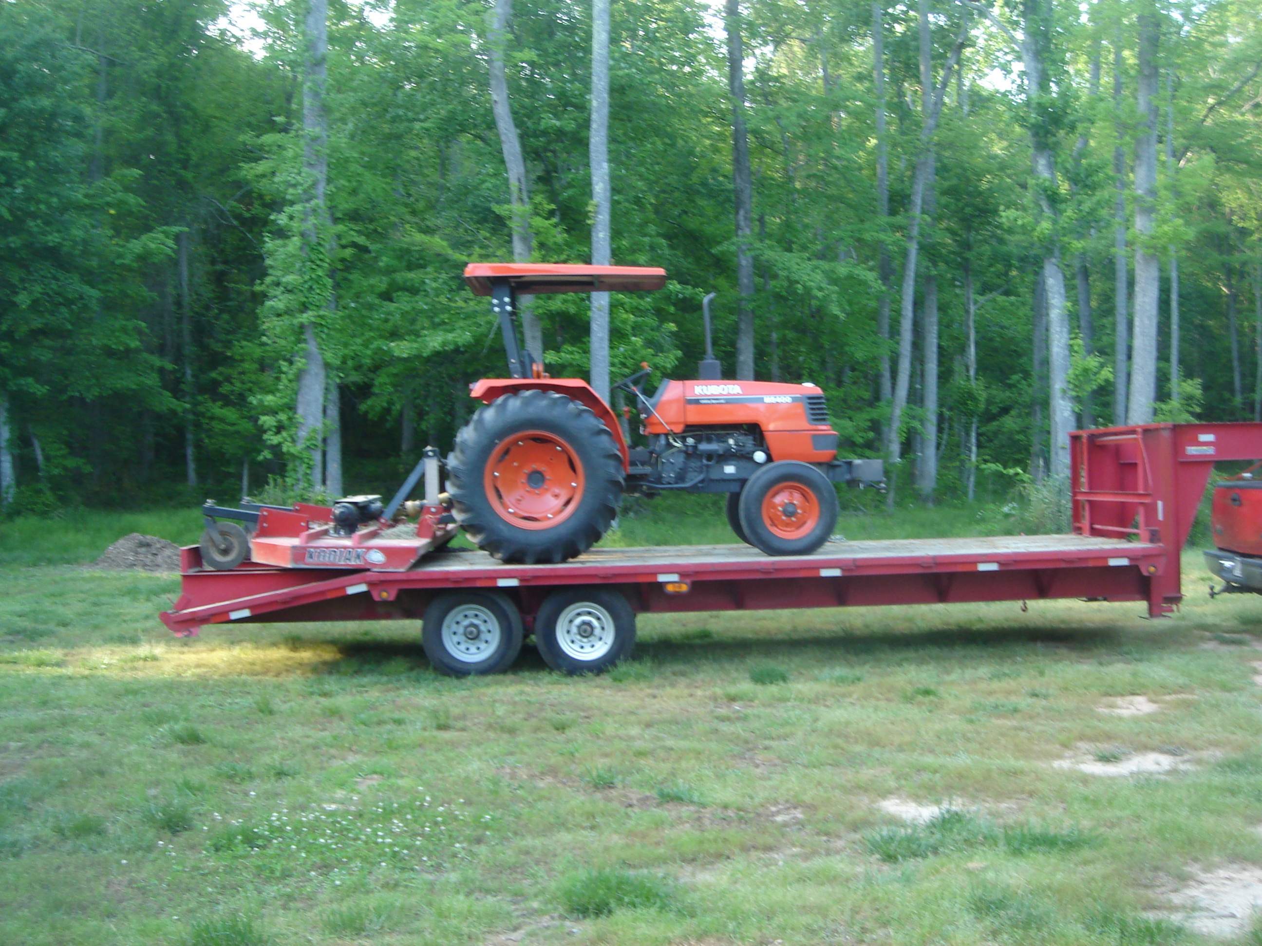

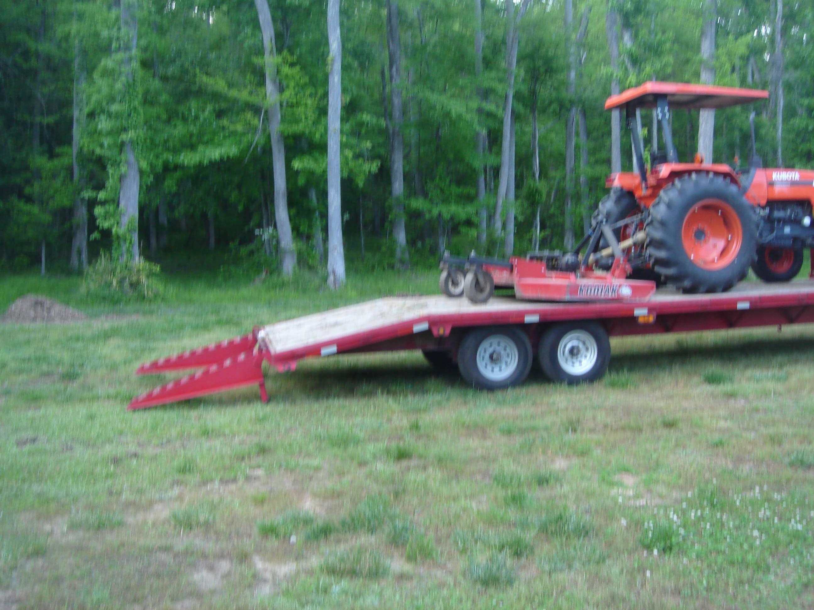

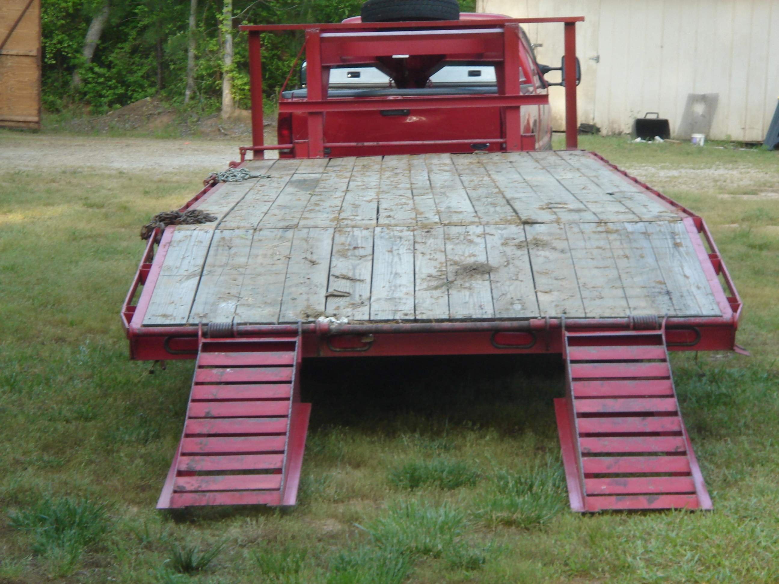

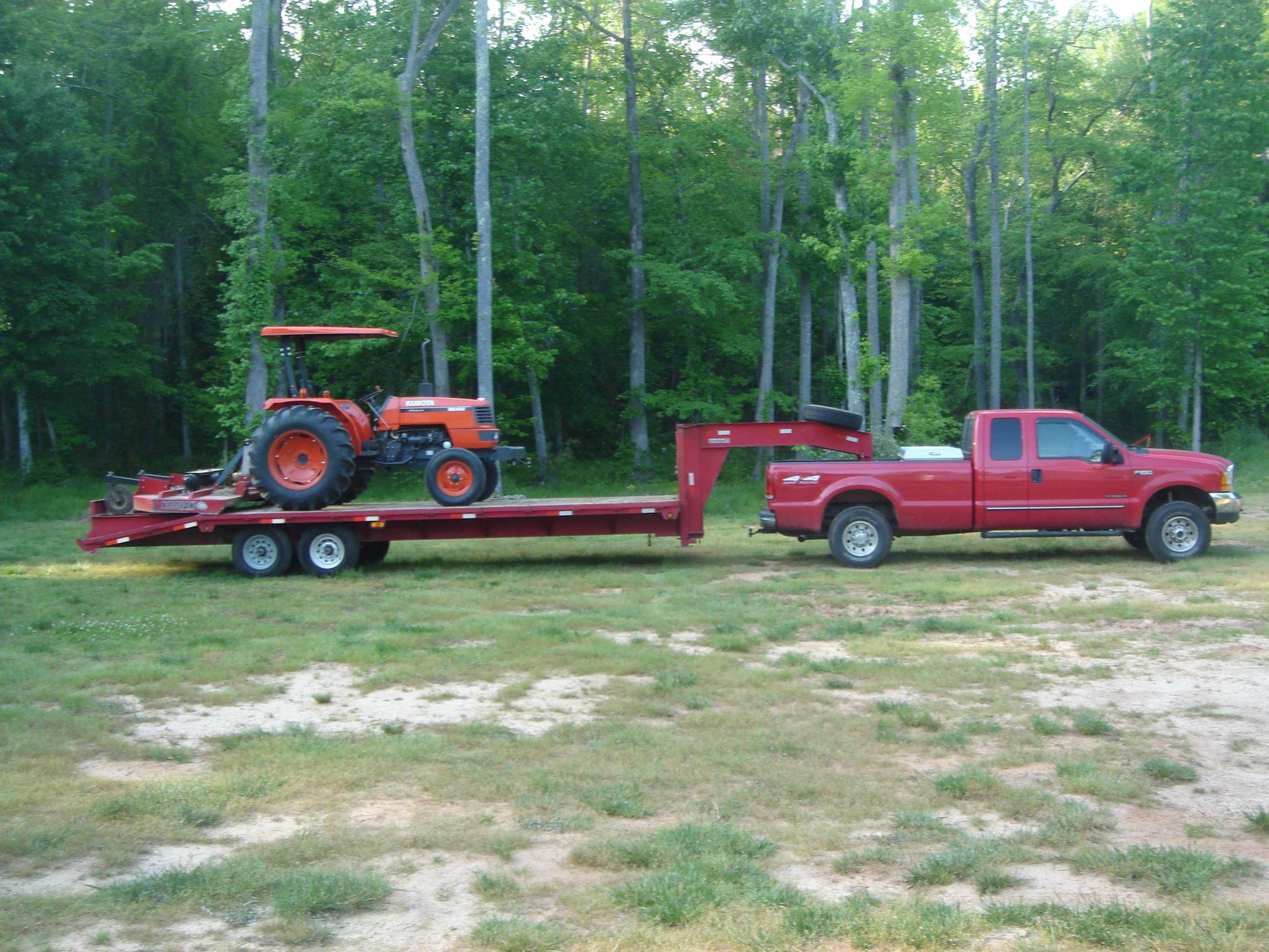

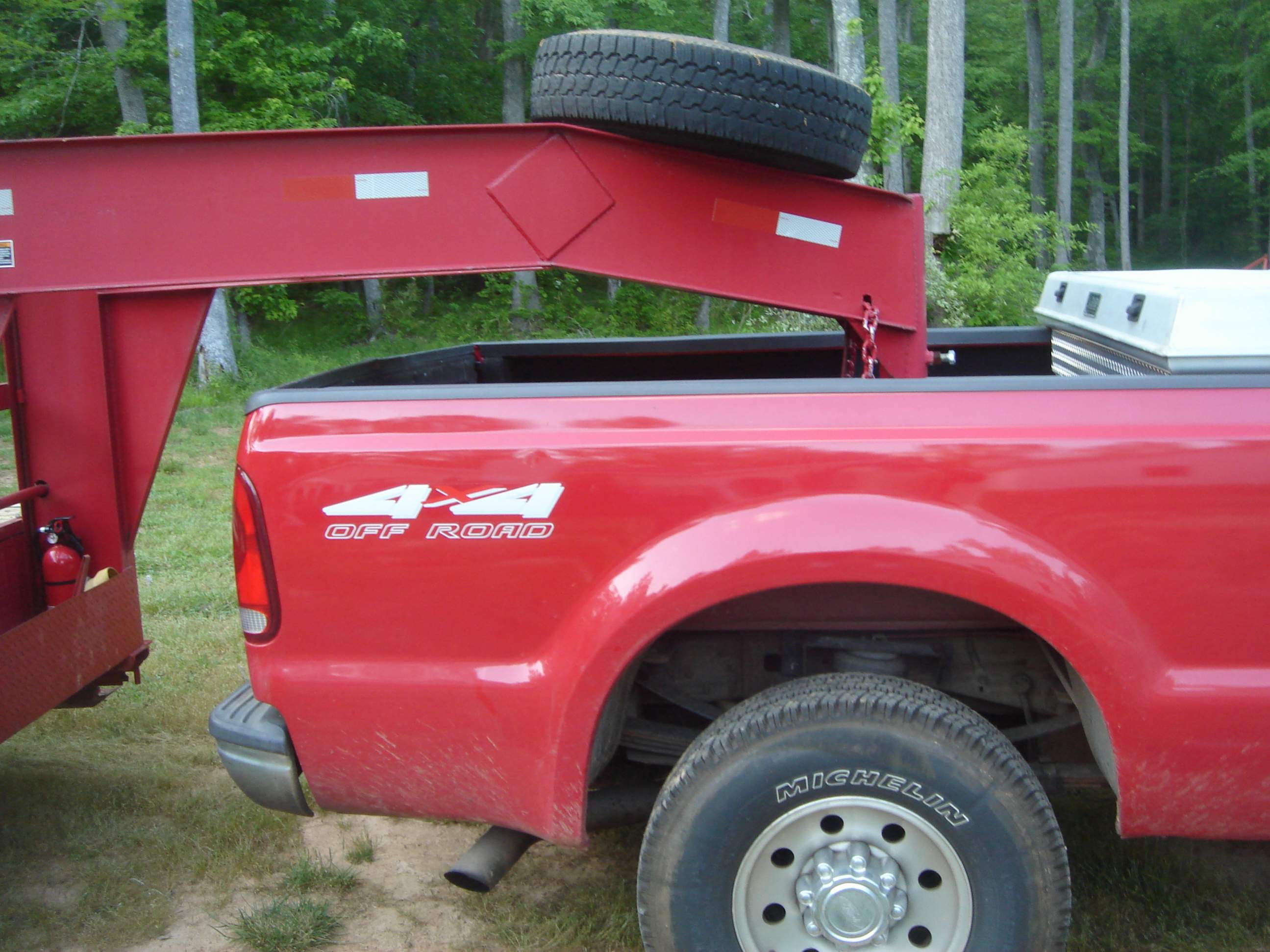

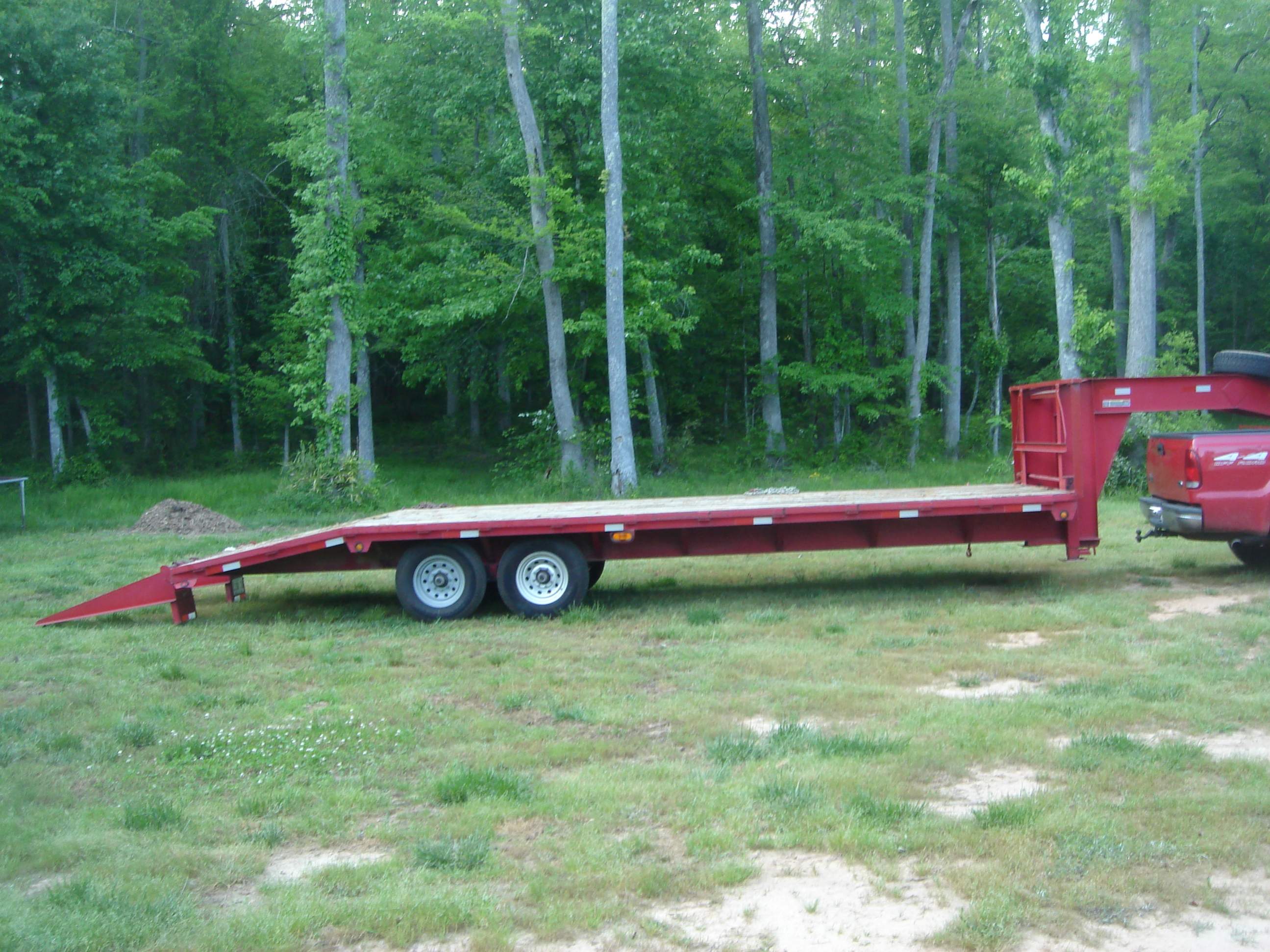

I have a Kubota M5400, which is the generation before the M5040. I haul it on a " North Alabama Mfg." 8 x 20 + 5 gooseneck trailer with two 7K axles. Bush Hog is a Kodiak twin spindle heavy duty 8 footer, which is actually 8 ft. 4.5 inches wide. Truck is a 1999 F-250 long bed 4x4 with the 7.3L Powerstroke engine. Truck has Michelin load range "E" tires, with Firestone Ride-rite air bags. Tows and handles like a dream. Plenty of room for a FEL.
I'll quit typing and give you some pics.
In the pics the airbags only have about 40 psi in them. I can go up to 70 psi and level the truck a little more.
If you have questions let me know.
