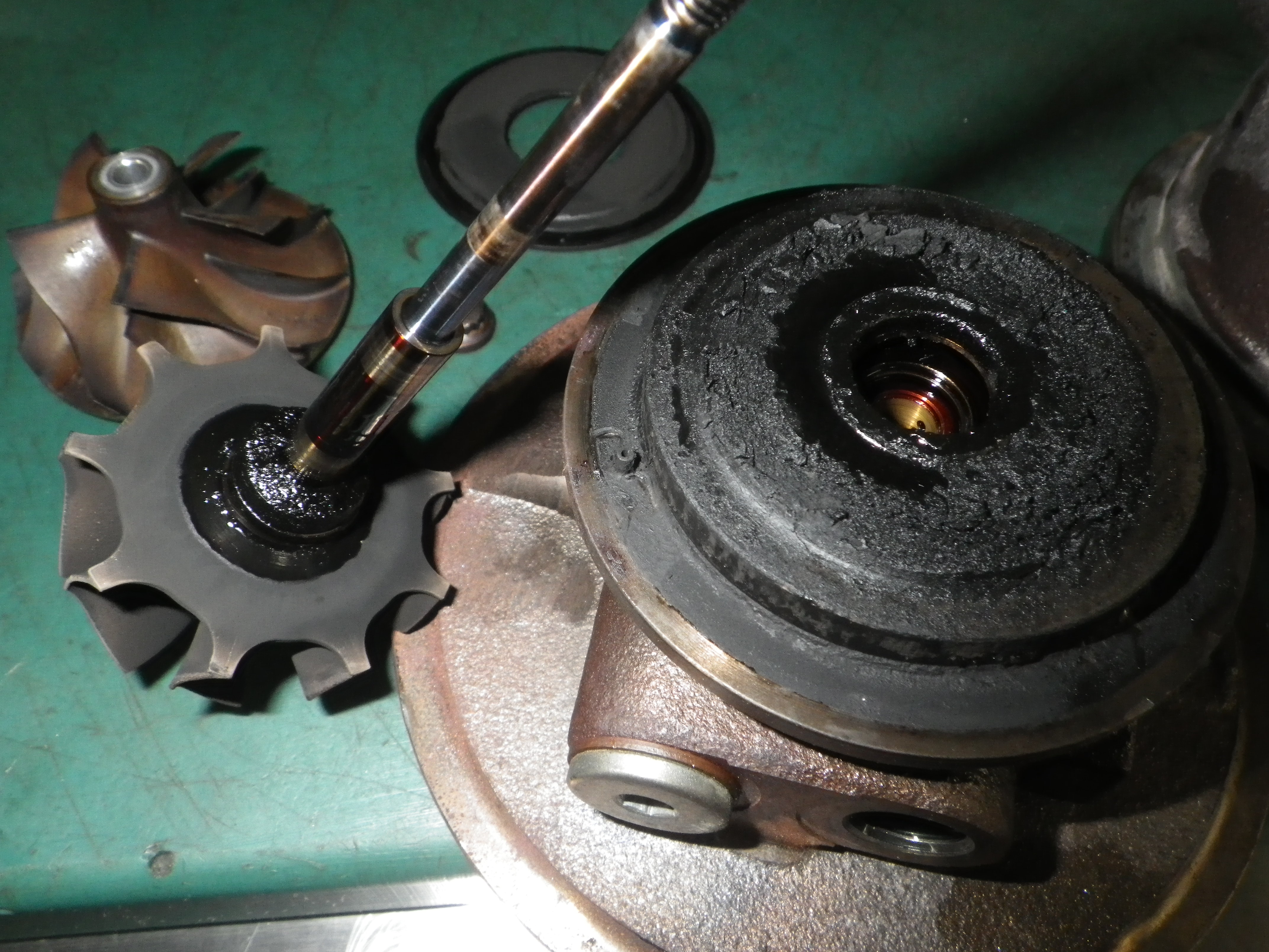

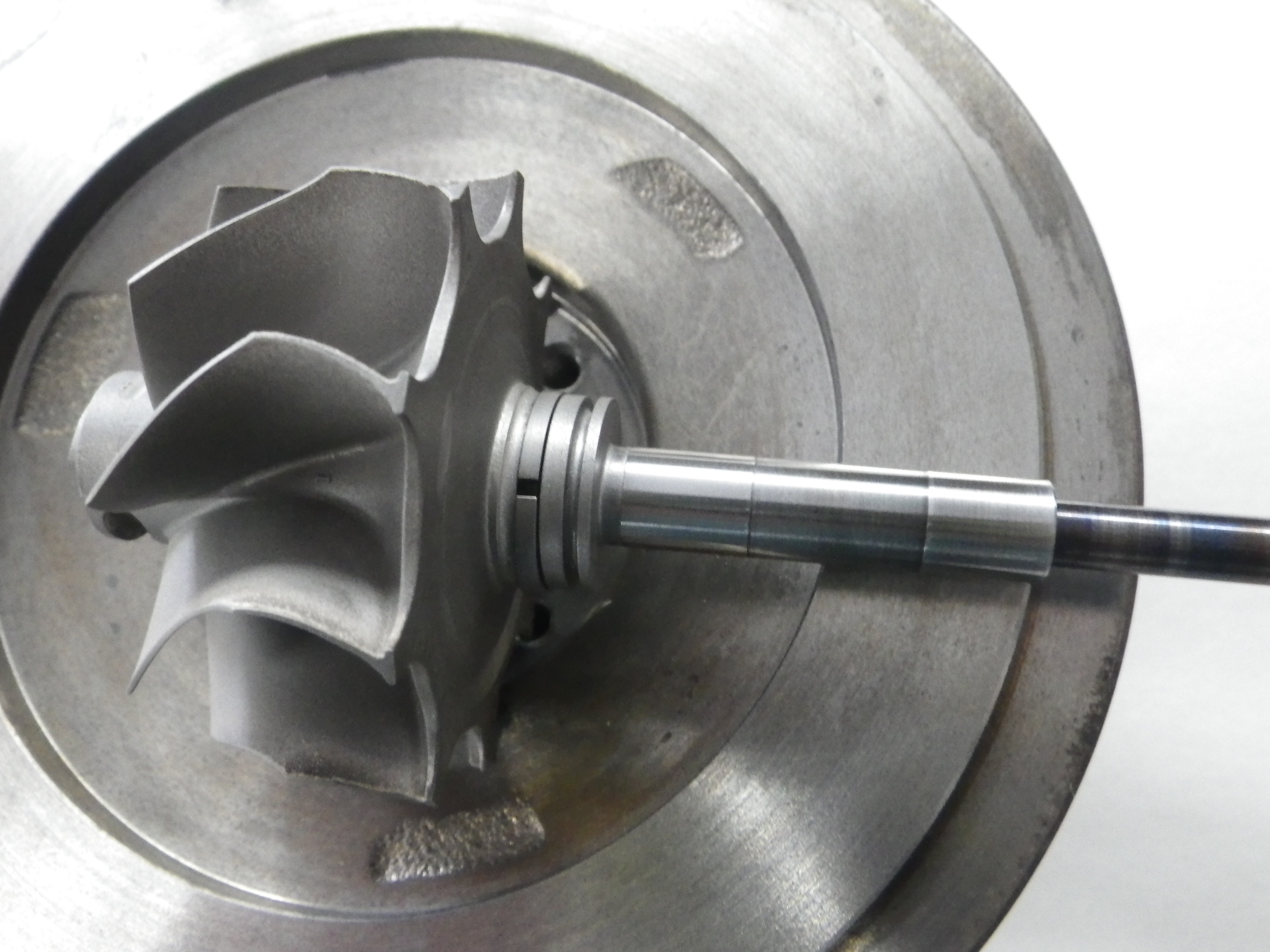

I wonder if the temp sensors are the same part number as I don't know but if 2 are the same try swapping them with each other.
Also turbochargers don't have to have boost problems to fail, most oiling issues are because the centrifugal seal in the exhaust side gets plugged with crap then leak out the rear polluting the CAT or is your case the DPF.
Kubota can't fix the problem because the system has not set any codes for them to see. I see this with engines that won't set readiness tests for emissions because one part of the system is out of whack but not enough to set a code.
I think M Harry has the best advice for you.
