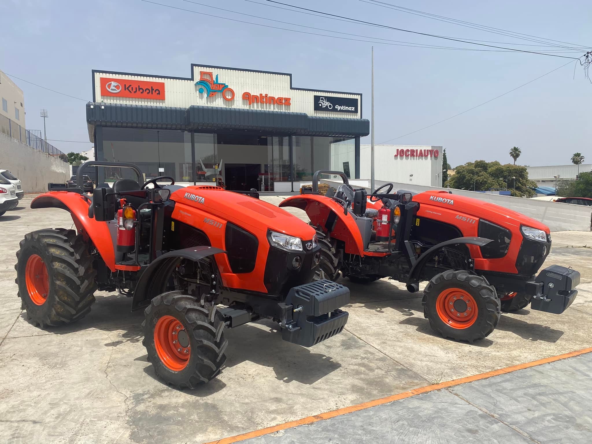

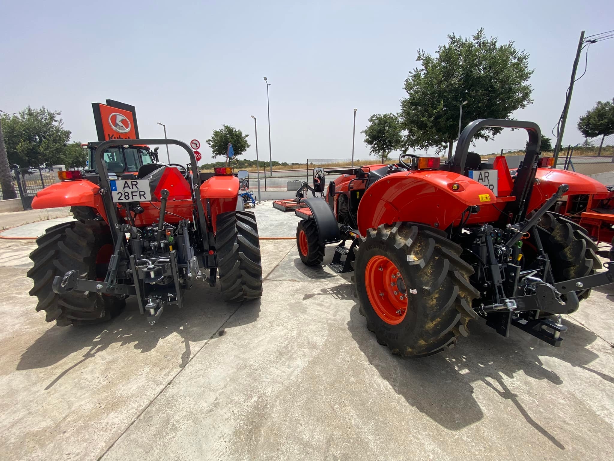

Another important detail is that engines have a limit to how much angle they can work. Unfortunately this not usually listed on the specs for the tractors. But some are in the 25 degree for up to 30 minutes or 35 degrees up to 1 minute. This is just an example of a Lombardini engine I found. Don't know about Kubota.
Not to long ago, a dealer here setup two M5111 pretty much as low riders for an almond farm.
