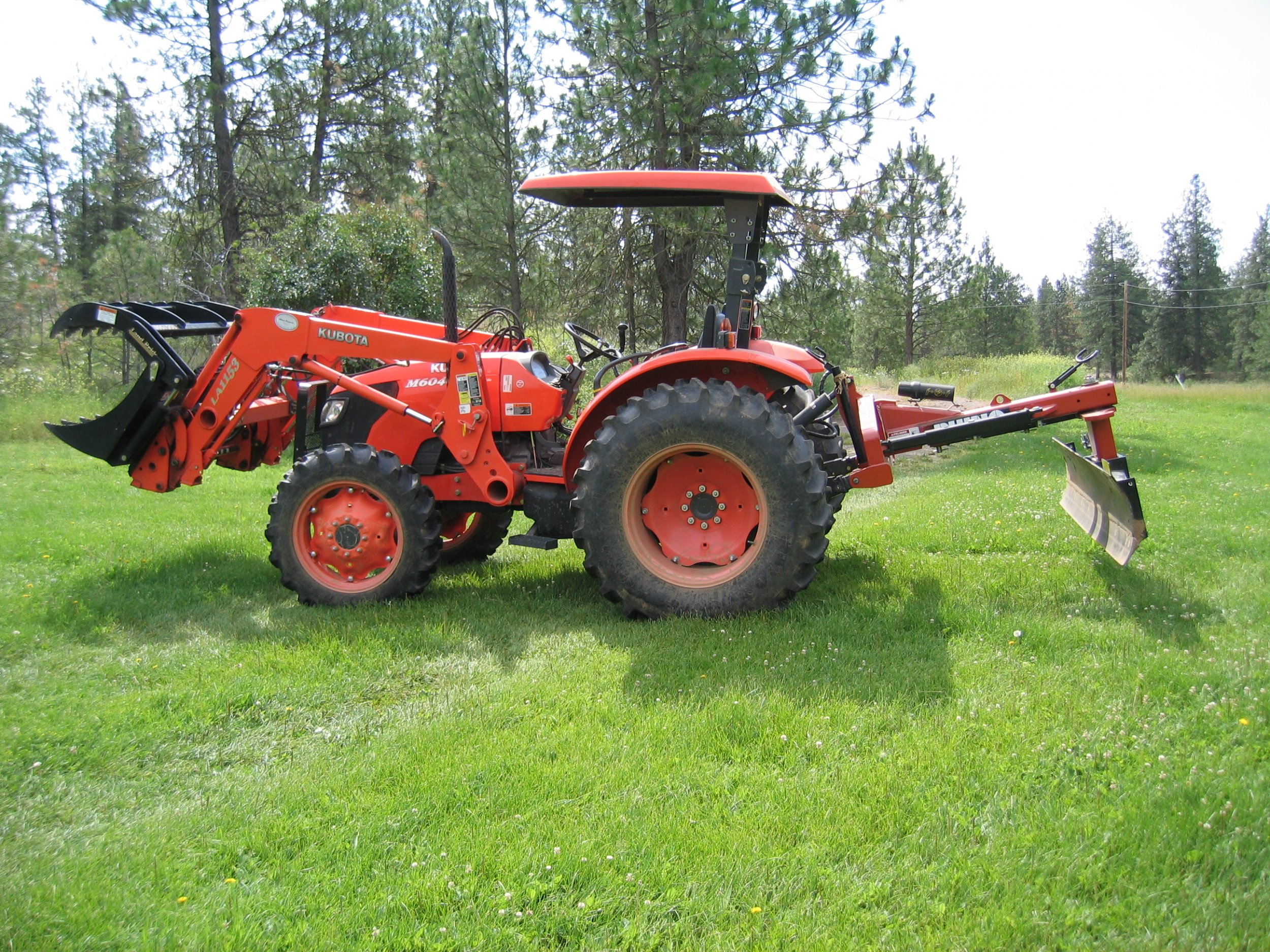

When I upgraded I looked at several brands/models. I choose the Kubota M6040. Mind you - it's not the IDEAL tractor. It's the best compromise I could find. Sometime I wish for bigger - occasionally I wish for smaller.
The way I have it set up now - weight is 10,100 pounds.
