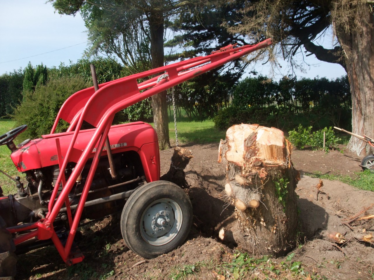

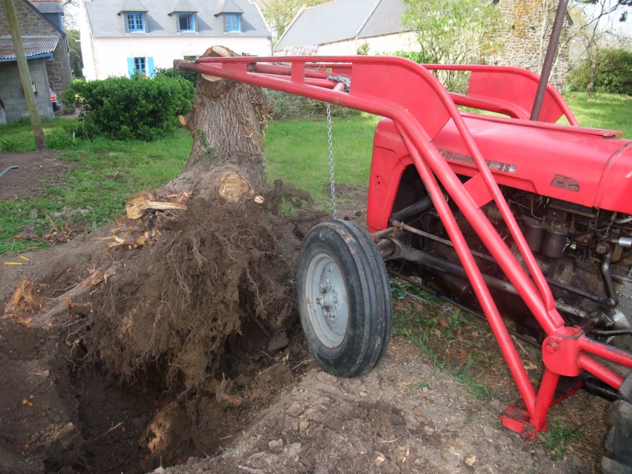

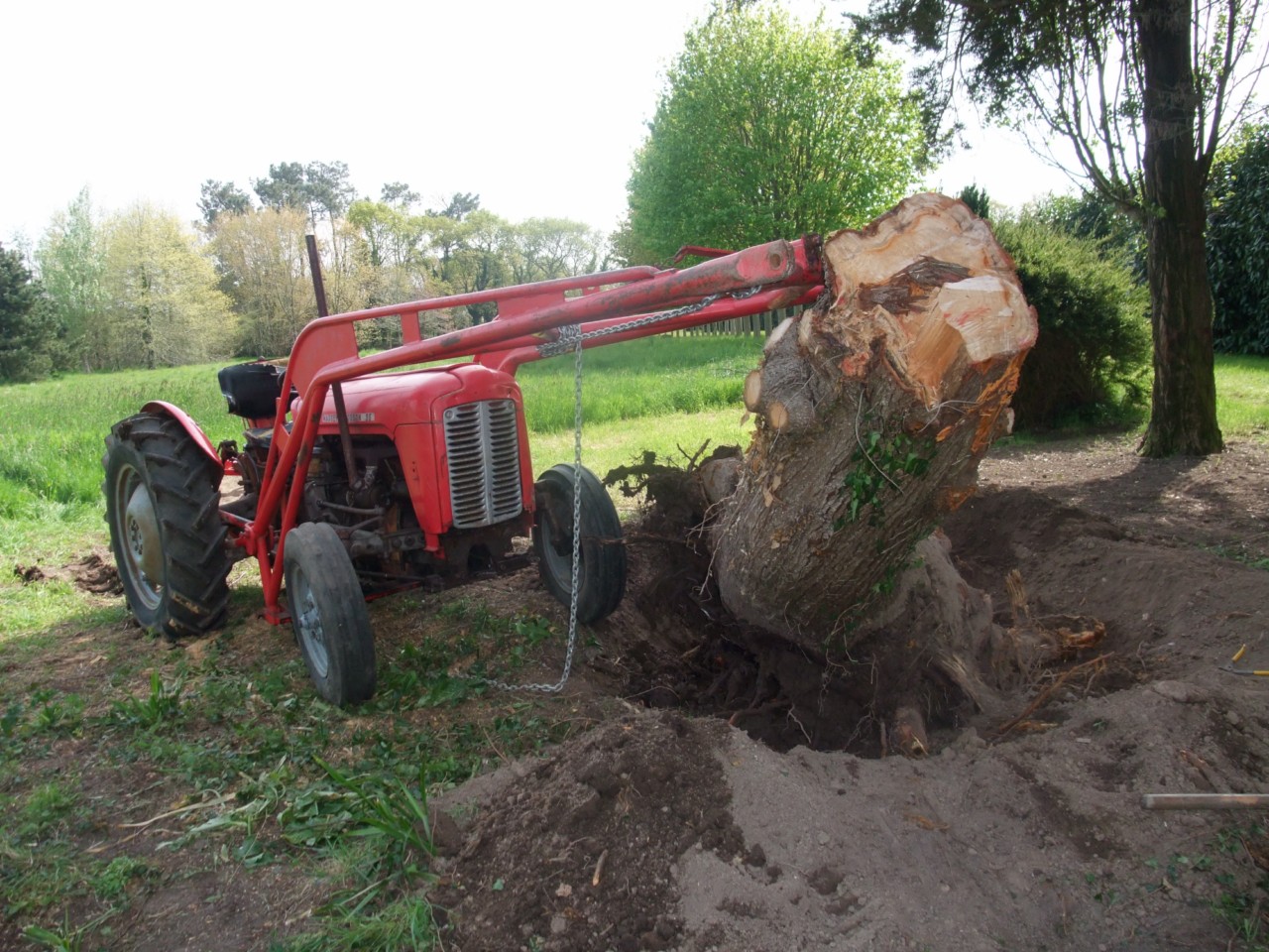

No problem to have a FEL on a MF35 using the tractor's hydraulics. All you need to change is the top plate to be replaced by a 3 way valve (3 pt hitch; FEL; dump trailer for instance) still sold by Massey today. No worry at all about the strength of the front axle, it can take quite a lot! I have used a FEL bought from Massey with the tractor in 1960 for 14 years without any issue to dig holes, carry stones and tree trunks, pull out stumps etc.
